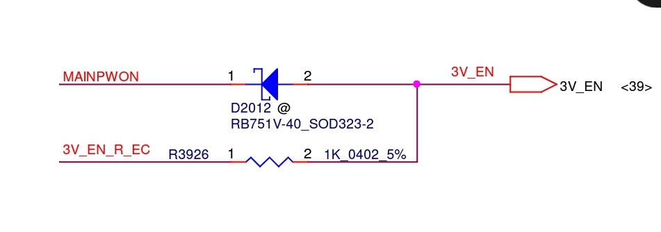

              Re: Acer No power A4WAB LA-C341P REV 1.0
              Can I apply this to my acer a315-41?
              1. Remove r3926
              2. D2012 is not there
              3. Connect 2 pad of D2012
              I have problem with missing 3v_en
              Most of the newer acer motherboard's have 3v problem where you get 5V on coil but no 3V on coil even though 3v LDO is present. This is cause of "thermal protect shutdown" circuit. In your case, it is there on pg 38 of schematic. You will find 3V_EN & 3V_EN_R missing(MAINPWON however remains present). The solution with repect to your motherboard is
              01.Remove R2626 & R2627
              02.Remove D2016
              03.Put a jumper between 2 pads of D2016.
              Now your dc amp reading should go close up to 0.0020A and there will be 3V on coil.Mb will give display on triggering if there is no other problem.
              Tested it on many newer Acer motherboards and this trick works fine. Hope this will help a lot of members here.

                #67
                You need to mention the mb marking and attach schematic, if availaible. Without checking dchematic, i cant confirm whether you can do that.
