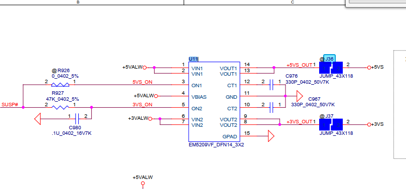

            I tried to check the U11
            • kalilinux25
              • Mar 2018
              • 2089
              • ZAMBOANGA SIBUGAY
              #46
              Re: Acer No power A4WAB LA-C341P REV 1.0
              I got no voltage at the vout of the ic also the susp# has no voltage reading also

                PWRBTN - 3V
                EC_ON - 3.3V
                SPOK - 3.3V
                3.3VALW - OK
                5VALW -OK
                SYSON- 3.3V
                SUSP# - 0V
                EC_RTCRST# - 0V
                PCH_ACIN - 0V
                PCH_RSMRST# 0V
                +3VLP - 3.3V
                PLT_RST# 0V
                Mobo is taking only around 1miamp
                charging led and power led blinking at the same time
