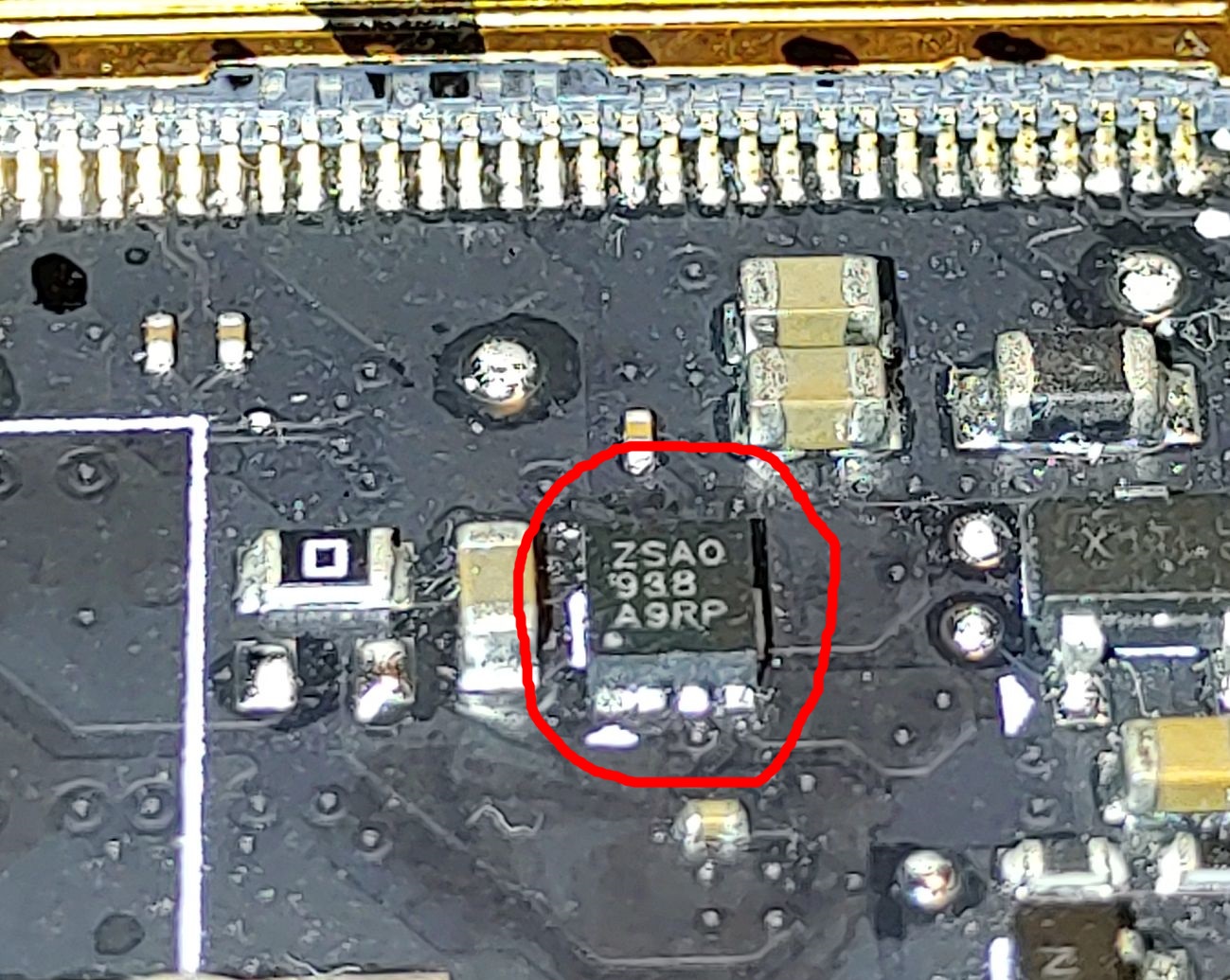

    Please can you help me with identification part on the photo.
    May be, Power-Distribution Switche with Soft Start but I don`t know.
    Part is from notebook Razer RZ09-0301 .
    pinout .
    1-2 - input 3.3V
    3 - Enable 3.3V
    4 - VCC 5V
    5 - GND
    6 - capacitor to GND
    7-8 - output 3.3V for EDP LCD, but no working
    IF I connect input and output, LCD work fine .
    Thanks.

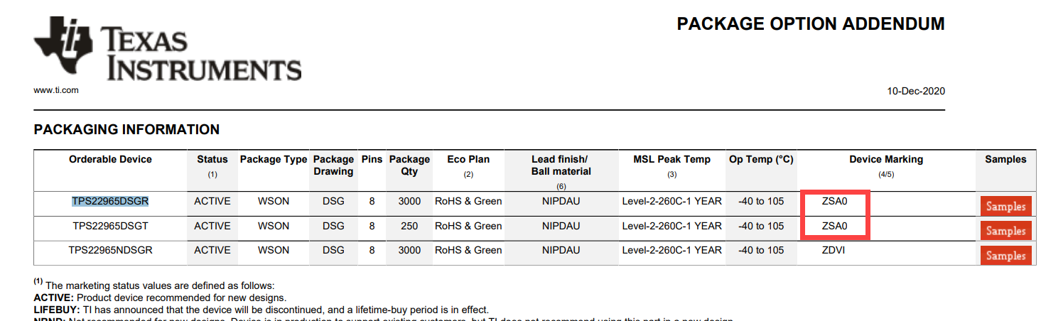

    Appears to be TPS22965DSGR by TI. See attached.
    Not sure about the 2nd line but the 1st line is a 100% match.
    '938' could be the datecode = 2009 - 38th week.

      Edit, you beat me to it. I agree its a TPS22965DSGR .The second line is a date code,the third is a lot code.
