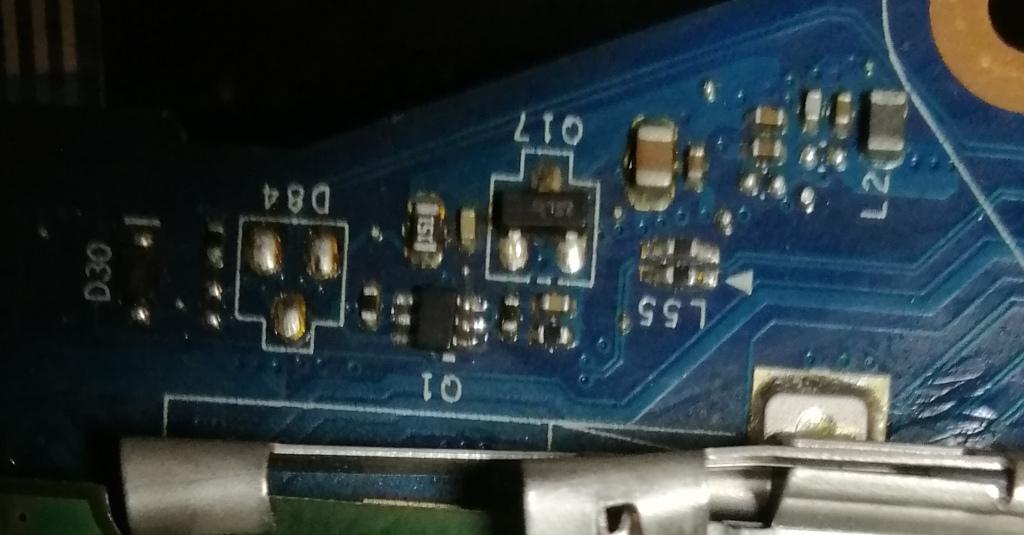

    the customer was replacing broken screen with battery on, now the laptop has no display on the screen of the laptop, but it displays every thing good on external monitor...
    i changed Q1 with no success

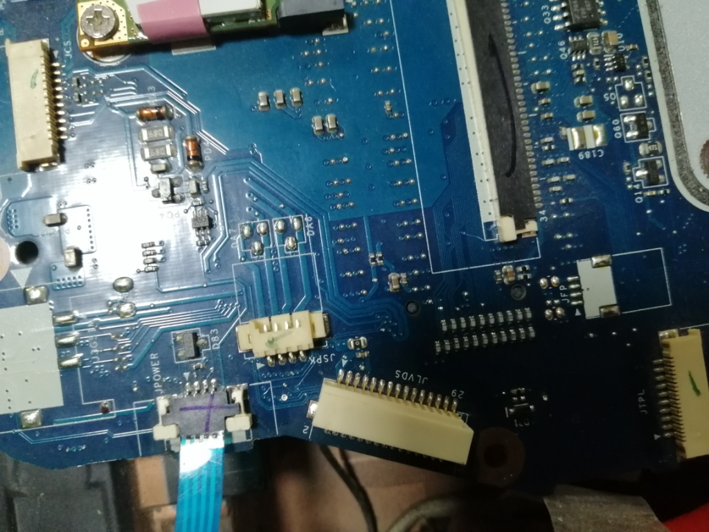

          Show Pic(s) of the LCD-connector and also Share Résistance to GND of +LCD_VDD Rail.

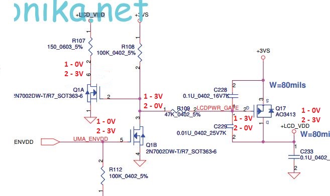

                Check the Q17 LCD_VDD transistor in the second picture first. When ENVDD 3v arrives ( Q1A-B ), Q17 G pin will be 0.6v, P_chanal mosfet will transmit.
                I'm not happy to be so strong. because it's not humanly
                • mazloum
                  • Sep 2012
                  • 503
                  • Lebanon
                  Re: toshiba satellite p755-s5295
                  i have 2v on gate of Q17
                  3v on D
                  and 3v on s

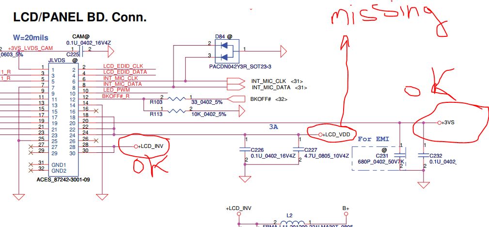

                    In the first picture, you have written LCD_VDD missing. Q17 supplies LCD_VDD voltage to the LVDS socket.
                    Q17 D pin has 3.3v? it should go to the LVDS socket if there is one.

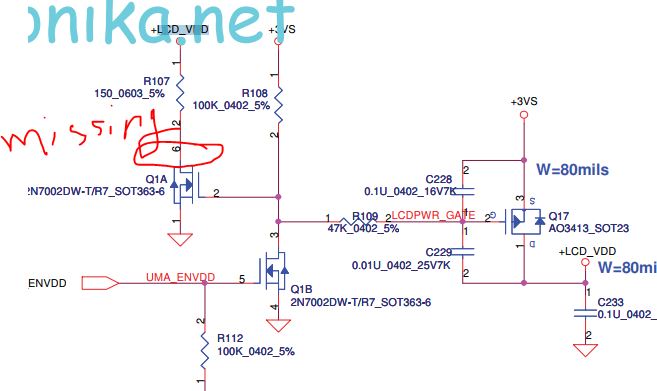

                      this is the problem....
                      pin 6 voltage on Q1 is missing

                        You don't Understand. Q1 Pin6 and Q17 Pin1 ist the Same Rail! So your shared measurements are wrong!
                        Double Check!
                        FairRepair on YouTube
                        • Sametbey
                          • Jan 2021
                          • 229
                          • Turkey
                          Measure starting from ENBVDD. 1 position, 2 positions

                              ok i have all volts now, but no display...
                              i changed the lcd cable also , with no success

                                Do you have + 3VS and LCD_VDD voltages for the Panel ? 6 and 8 pins exchange data between the LCd panel and the PCH. For panel detection. check the signal backwards. and 10 pin LEDPWM need to be 12 pin BKOFF 3,3 v. maybe panel.
