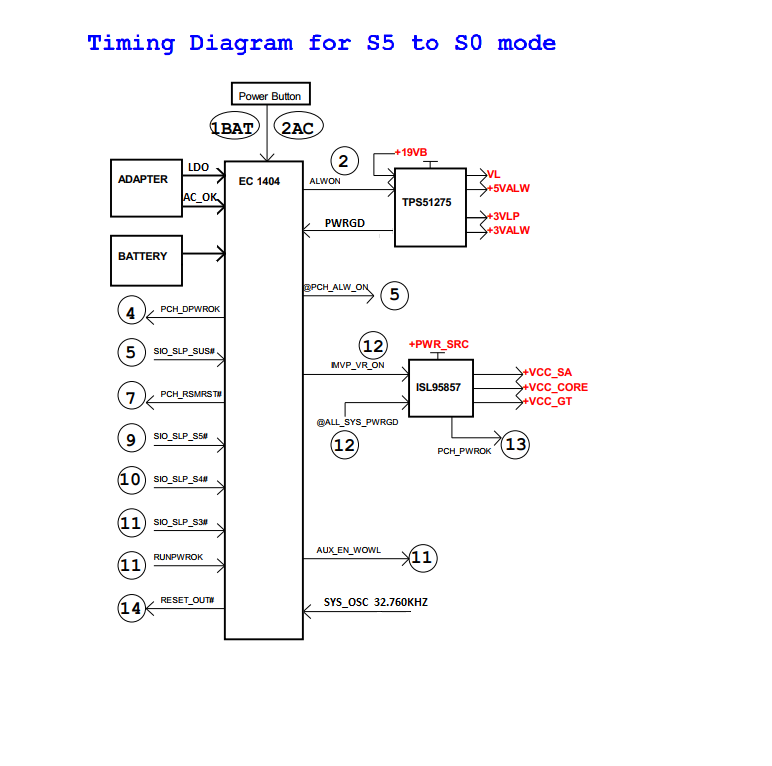

    Hi, I am woking on Dell Inspiron 15 5559 LA-D071P. The problem was, there was a slight liquid spill on the Power On/Off board & was not turning on. I cleaning the ON/OFF board well & now getting the 3.3 voltage & all the required voltages on this connector. 3.3V & 5 Volts are generating perfectly. But still does not turn on. RTC voltages are fine are ok, as these Dell board require this voltage to turn on the motherboard. I re-programed the BIOS but still no luck, the LED or fan does not turn on at all. Voltage to the I/O chip is 3.3v which is good enough. Totally dead.. Can someone help in this repairs. Thanks in advance.

    Are there requirements for IO? In which region the liquid contact is, it should be examined carefully. It may be an open circuit component.
