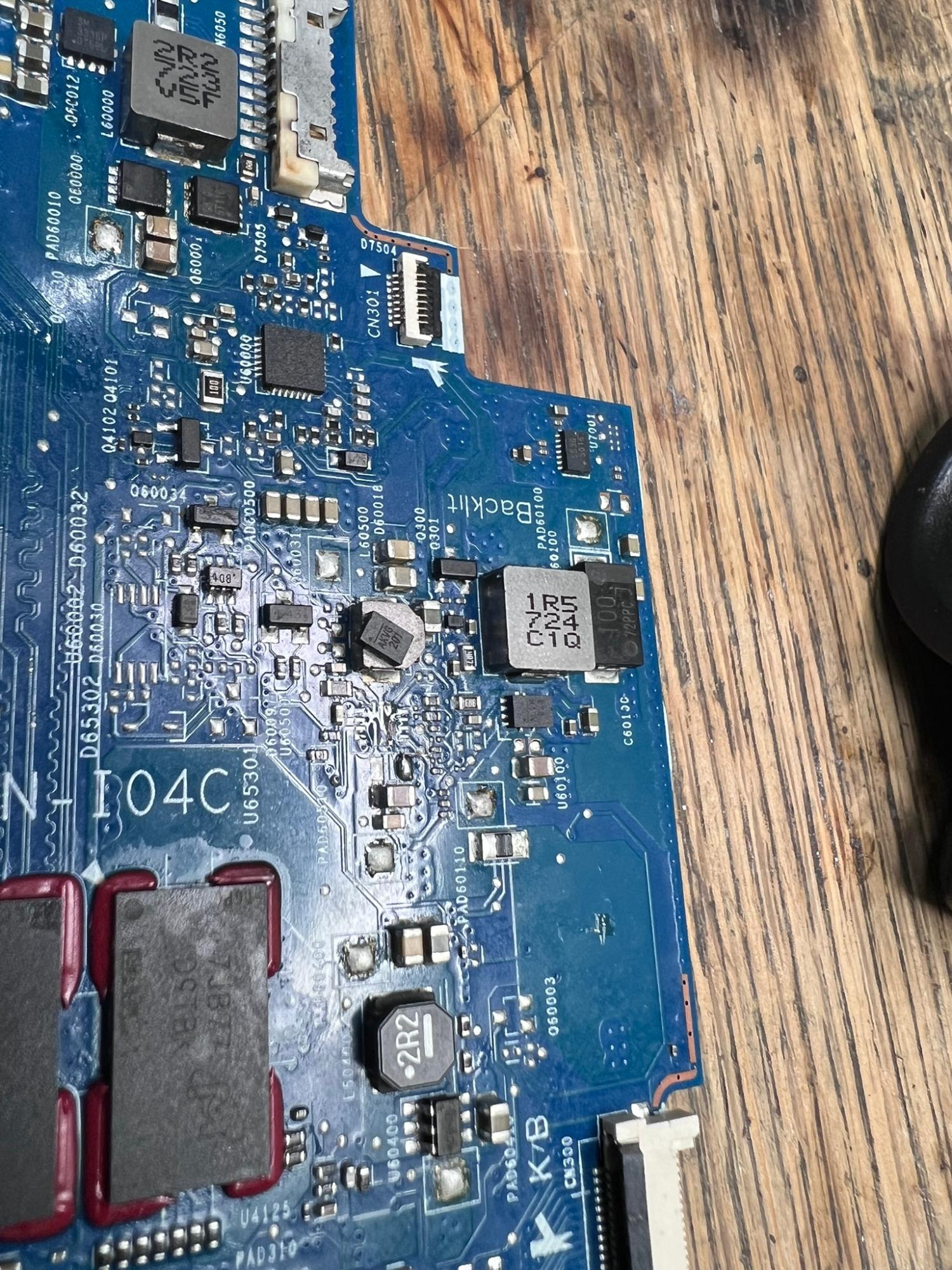

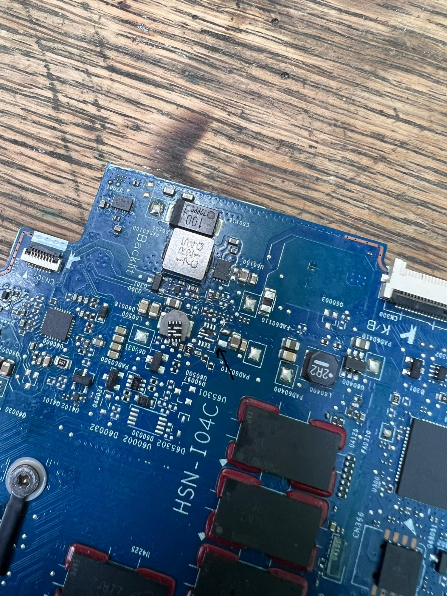

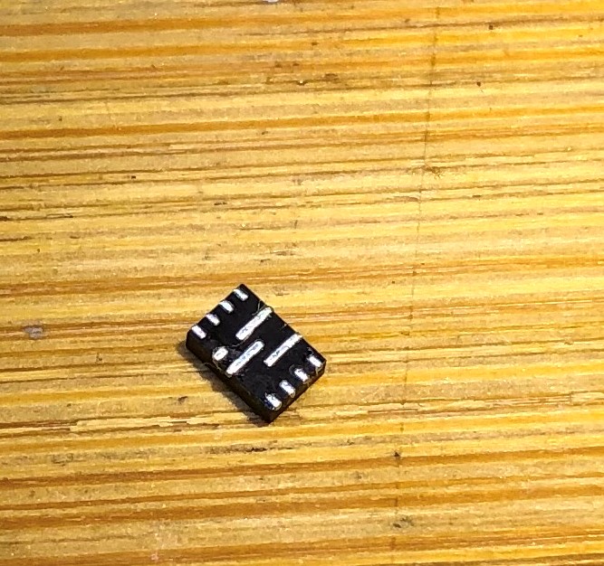

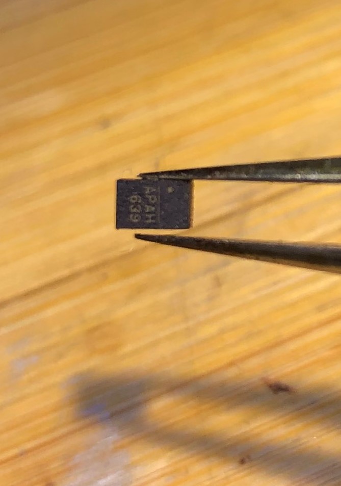

    Ok, I found the fault without the schematics.... Actually one component is shorted & for sure this is on the 19 volts main rail, removed it, all short gone. I no idea what this component is. Pls. view photos of the component & where it is placed on the main motherboard next to the inductance coil 1R5750. Like these components are place on all the paths of the 19 volts rails. If anyone have any idea of this component, pls. inform me. I am assuming it a package of Diodes, Maybe!!!! The # on this component shows APAH639

      Re: HP EliteBook x360 1030 G2
      Nb679agd-z
        mcplslg123::: Thank you so very much.. you are a genius., God bless you & stay safe in India...
