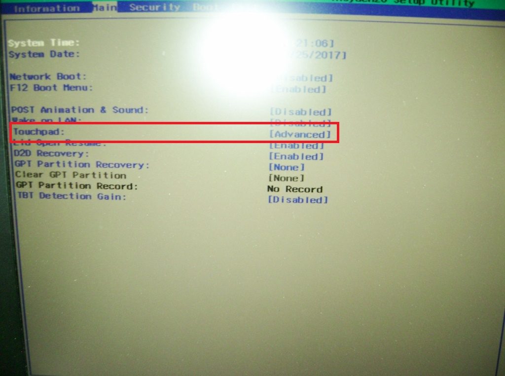

    Some Acer laptops have a setting for touchpad in the bios - Advanced or Basic
    Make sure it's set to basic
    I had 2 Acer laptops recently with the touchpad not working and it was the setting in the bios set to advanced

          This is a screenshot of the setting in bios for aver v3-472
          I didn't spot it at first.

            Re: acer v3-471g no touchpad
            Hi Just got another Acer E5-511 touchpad not working and not detected in device manager - no option in the bios to select basic/advanced
            Bios was on v 1.03 - updated to 1.10 and option appeared in bios - set to basic and now working ok.
            Have you tried a bios update?
