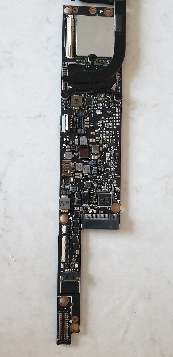

Lenovo YOGA 3 Pro 1370 +3VALW Missing Board NM-A321
  • sikocan
    • Oct 2019
    • 344
    Laptop: Lenovo YOGA 3 Pro-1370
    Board: NM-A321
    Schematics attached, Page: 30
Question: The BQ24770 is a Battery charger IC. It’s pin #5. I’m not getting ACOK signal. ACOK signal will generate +3VALW on power which is missing.
As per BQ24770, datasheet attached, Pin #5. For this to be on the following criteria needs to be met:
ACDET above 2.4 V: This is correct and board is good with this value.
    VCC above UVLO but below ACOV: This is what I’m unsure about, where do I find UVLO? It’s not on schematics, from Googling it means, undervoltage lockout (UVLO) function to disable the device at low supply voltages. From this I gather it’s the ENABLE signal needs to be ENABLE, but I don’t know where this is and how can I find It on schematics.
    VCC above BAT: This is also correct, when there is no Battery is present, it’s 0V, I gather this should be OK unless I’m wrong.
Can someone please help me understand the UVLO and how I can measure it?
    I have also used 2 original Lenovo chargers, 1 compatible and for the original Lenovo chargers, their cables are removable, 3 cables altogether I've tried.
    All had 20V supplied to the system. Battery would not charge as well and the issue is same with or without battery plugged in.
    Thank You!
    [MOD EDIT} Link to schematic & Boardview -> https://www.badcaps.net/forum/troubl...0-lcfc-nm-a321
  • mcplslg123
    • Jun 2015
    • 7262
    • india
    Re: Lenovo YOGA 3 Pro 1370 +3VALW Missing Board NM-A321
    Are you getting +3VALW on the other end of PR64??
    • sikocan
      • Oct 2019
      • 344
      No, the same very low I believe it was 0.2v or so, the resistor measures 96k ohms
      • mcplslg123
        • Jun 2015
        • 7262
        • india
        Your problem is not charging ic as acok# will be pulled from +3VALW and since +3VALW is not available, there is no question of getting ACOK#. You need to probe your 3/5V regulator IC.
