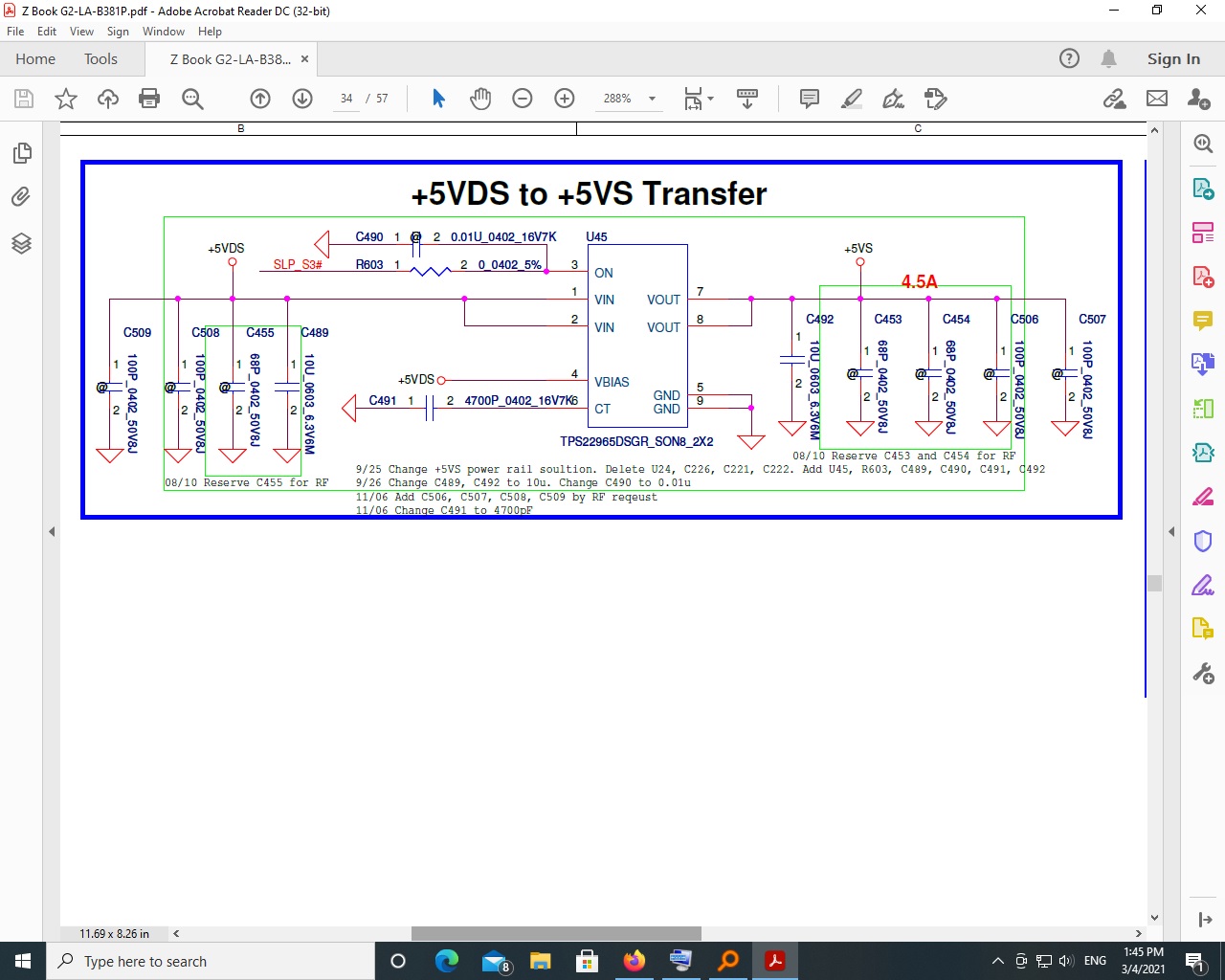

    Not only fan is spinning but if you check your 3/5V standby is also working. Problem is in VS line. It is getting transferred without pressing powerbutton. You need to find out the circuit responsible for switching of 3/5VALW to 3/5 VS. If you have schematic, post it or atleast mention mb part number.

        Re: Hp ZBook 15 G2 turns on when adapter connected
        You can refer to LA-9241P schematic as reference. Check page 34 of this schematic. You need to probe your DC to TC conversion. Most likely EN( sometomes labelled as ON) is not removed after shutdown and that's why your VS voltage is transferred. May be some other reason but this aspect is worth probing. The IC may be TPS2296X/G5016 or something similar.
            i was solved this problem last week by replace u45 it was shorted
            • mcplslg123
              • Jun 2015
              • 7262
              • india
              Glad to know that. Since schematic is not attached, can you mention U45 was which component??

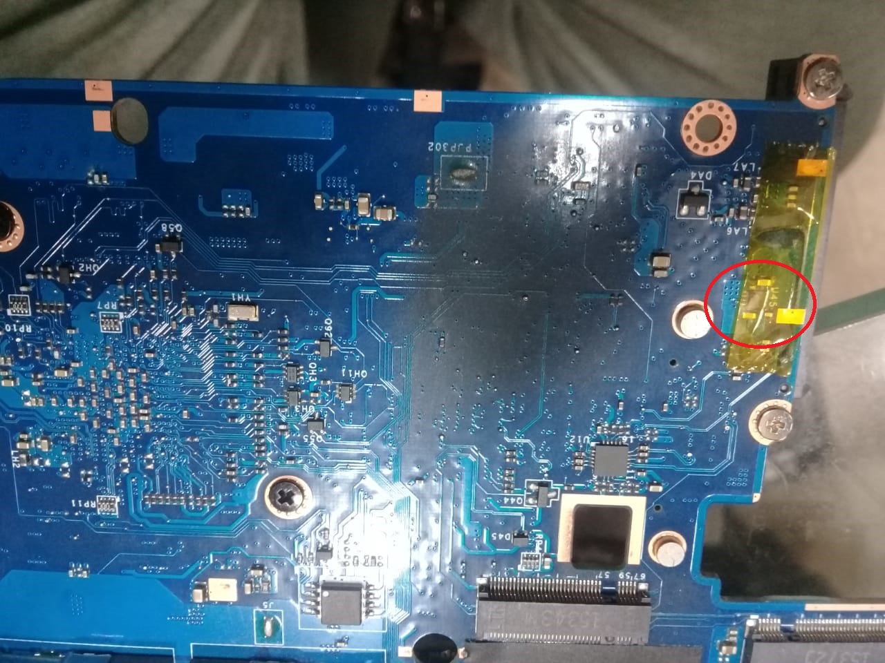

                  it was shorted between pins1,2 and 7,8
                  • mferna14
                    • Jun 2018
                    • 1046
                    Thank "menshawy" for the tip, will try to repair, I just left it aside.
                    • mferna14
                      • Jun 2018
                      • 1046
                      Hi "menshawy" you are genius.. I have no idea how you traced this U45 component to be defective, but that was right on target & spot on. This exact component was defective too on my motherboard. Replaced it from a donor board., all works fine. Thank you very much, really appreciate yours & all involved in this thread to resolve the problem.
