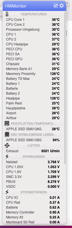

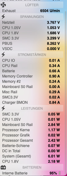

      Post screenshot of HWSensors https://bitbucket.org/RehabMan/os-x-...-2018-0915.zip

        Re: MBA A1466 (820-00165-A) 2017 has high fan spin and hot GL3219
        See attached.
            Looks the issue is with the "Heatpipe" sensor on the LIO board.
                  That would be a bummer since I replaced the IO board a little while ago.
                  The PPBUS voltage at 8.3 looks a bit low. I notice however if I plug in the charger it goes up to 8.6v
                  Unfortunatly I don't have a schematic for the io board.

                      Yes. It is on the LIO board schematics, but that's not available for this LIO board. The 2012 one is available, it's slightly different but it also has this temperature sensor connected to the SMBUS.
