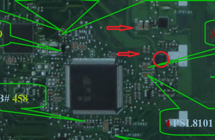

            EEPROMs arrived, 5250 clip not yet, but already flashed a new chip. And, soldered it the wrong way. Now it's OK, but there is a short across a few caps and a chip is getting hot. Can't install Boardviewer at work, so I can't see right now what chip it is. It's meant to convert the 19V to 3 and 5V though. So the shorted cap(s) must be at these outputs. I'll remove the caps one by one in the hope the chip is still fine.

              EC dead.
                Re: X550CC no PWM for +VGFX_CORE
                yep the EC is dead
                  Yeah, after removing all suspect caps and the buck controller, the short was still across the +3VAO line. It was the EC +3VA inputs shorting the controller's outputs.
                  What is puzzling is why placing the BIOS the wrong way could cause such an issue. BTW the BIOS looks fine.
                    Pin4 of bios chip is gnd-thats why the damage when u place it in wrong orientation.
                      Sure, it's like with the DIL8 single supply opamps. Pin 4 is supposed to be grounded for it to work but it's not ground in itself, right? Even if pin 4 presented a too low resistance to the +3.3V line, it would be protected by the current limiting resistor. I mean, that series resistance would also present a safe load to the source of that voltage (EC I believe).
