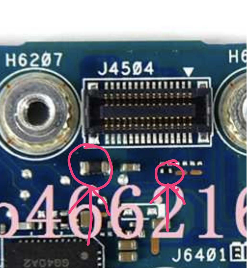

    Hi all.
    Can you help me identify the components on the photo.
    I have a motherboard where these components are burned.
    Thank you in advance.

    left 0,1 ohm, right 99,5K

      Hi there can I have the schematic please, some components got blown away when removing the bios chip and I am trying to find a proper replacement. thanks in advance!
