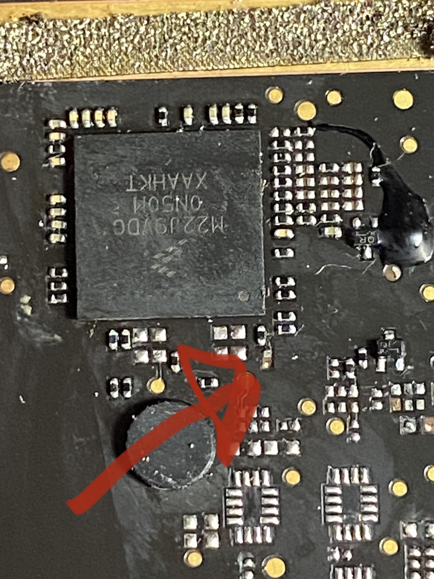

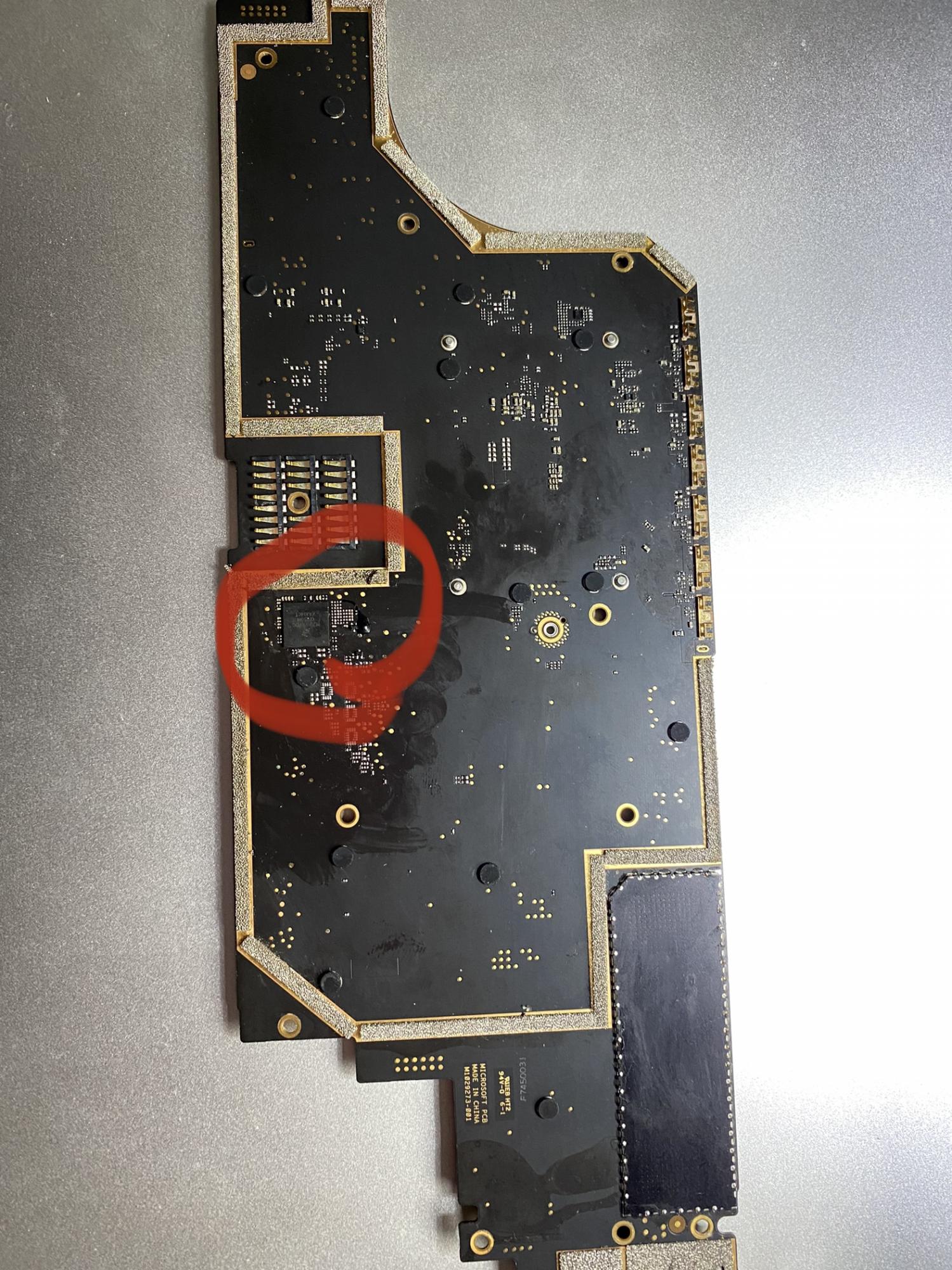

    Hello all,
    Please help to identify one resistor's value which was damaged by liquid. The motherboard model is M1029273-001. Please see attached photos og the missing resistor
    Thnk you

    Re: Microsoft Laptop 1769 value of a resistor
    Just measured across it while still in circuit and got 185.7 k-ohms. Hope this helps.
      measured across it 200 k-ohms
