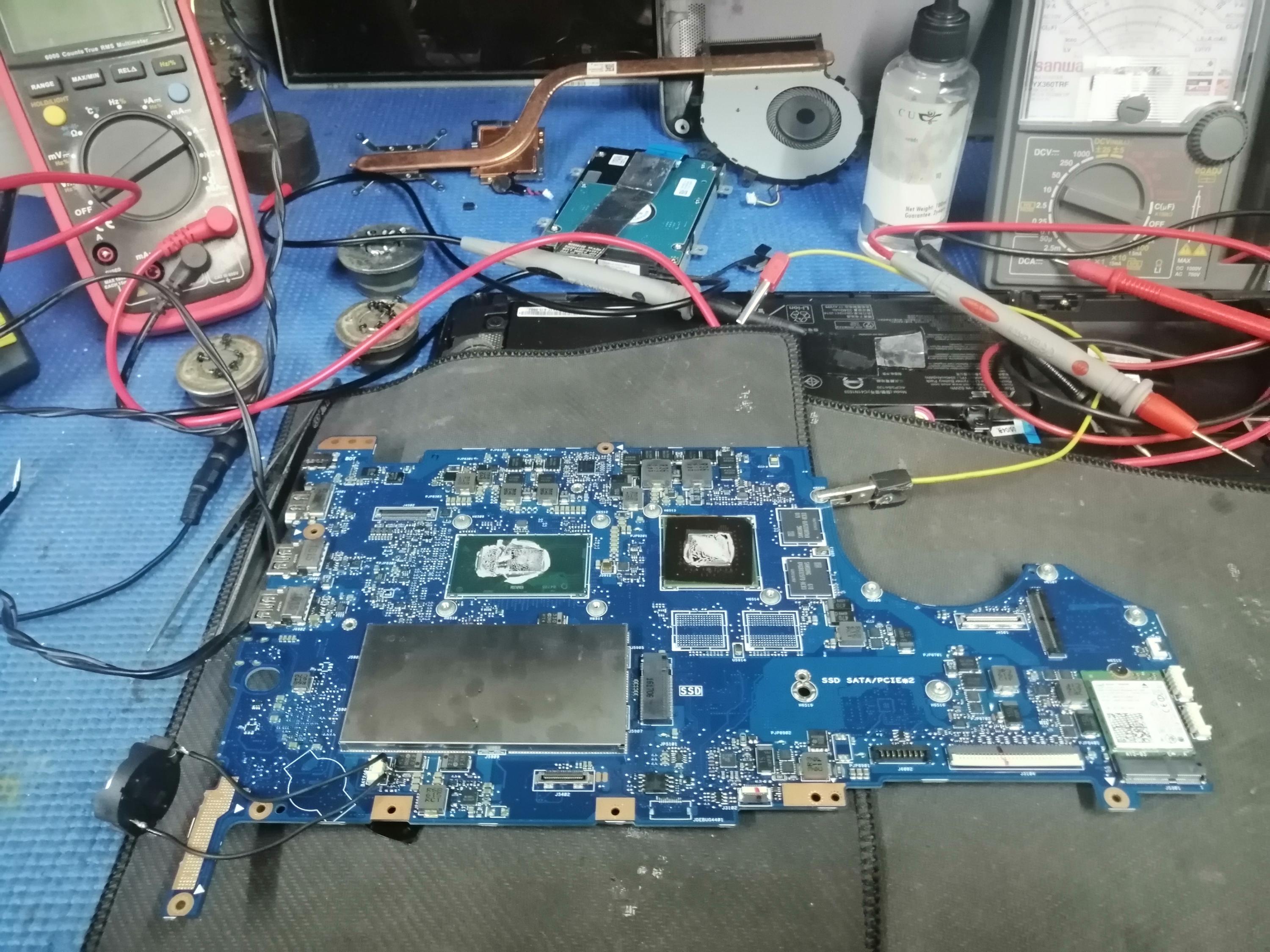

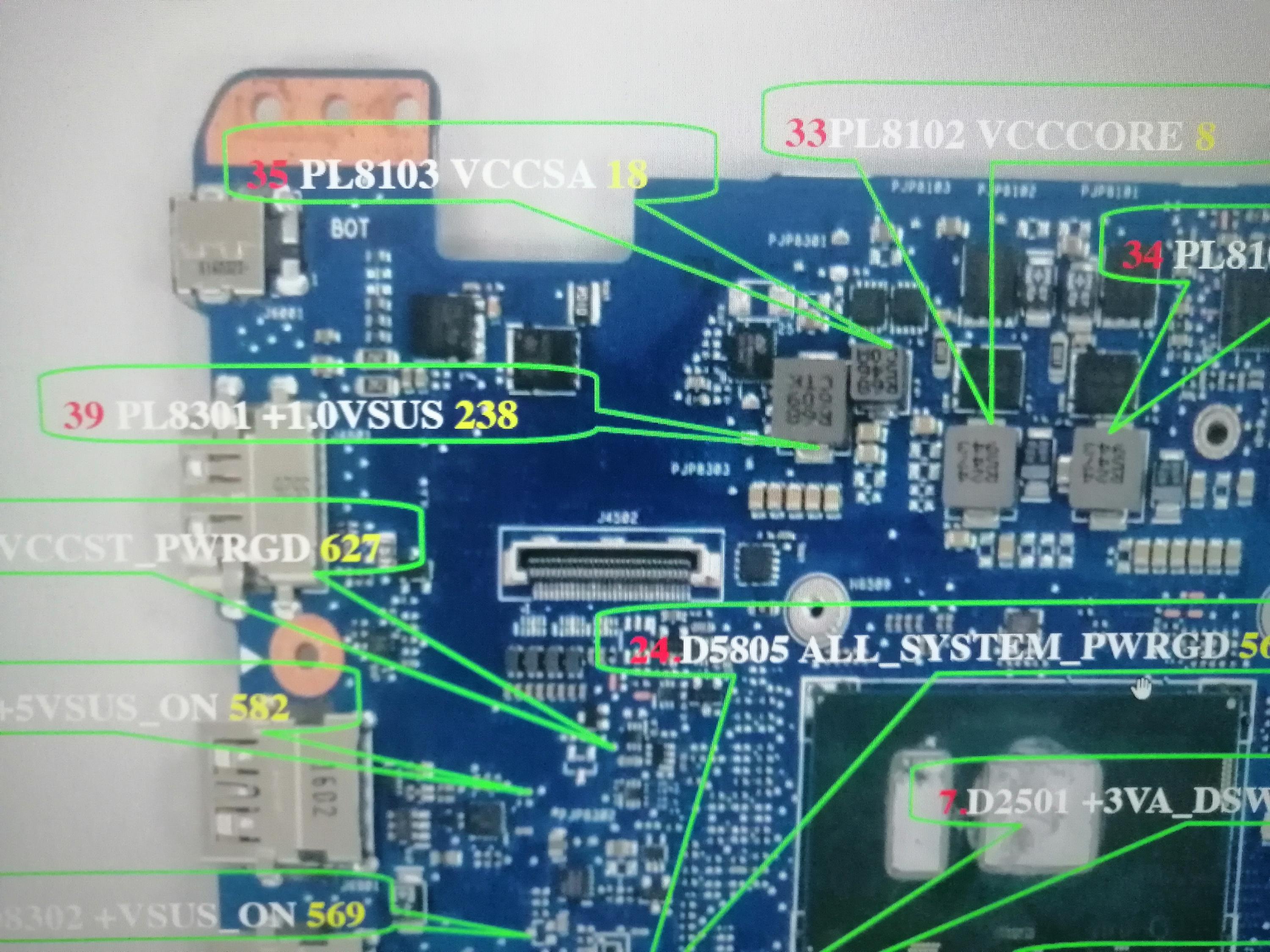

    When charger plugin, split second consume 0.19a then 0.00a, no light indicator or power,power button no response.
    3.3v, 5v, vreg 3.3v and vreg 5v ok, power button has 3.3v.
    i cant find any short in all coils.
    PL8301 1vsus and bios 3.3v comes on split second when charger plugin, when bios chip remove, 1vsus and 3.3v bios is stable.

    I only found 1 bios file upon searching, but still the same, I'll upload stock bios tomorrow, thank you.

      stock bios

        Re: Asus ux560ux no power no light indicator
        Better you post your bios in this section : https://www.badcaps.net/forum/forumdisplay.php?f=40
