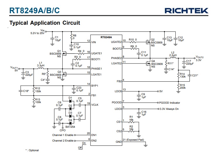

    Hi good day this board was shorted the RT8249CGQW is needed to change because it was getting hot after trying to chagne the ic it was getting hot again I tried to check all pin no shorted I tried to remove the ic then pumping voltage on the dc jack no shorted reading on dc supply , why its getting shorted?

    RT8249C integrated by dismantling 3.3 V LDO output 3V by giving you can check whether there is heating. Pin 3 out.

      pin 3 is not shorted to ground sir

        is this also normal sir that my APL5930CQBI vOUT pin is conencted to ground?

          Is there a 3.3v LOD? which part is getting hot?

            the ic it sel sir is getting hot if i plug the charger
              Re: asus x409fb rev 2.0 shorted RT8249CGQW
              By removing the APL5930CQBI integral, give 1v to the output and check which part is heating up.

                cant detect where is heating up dc supply 1v 800miliamp its conusmung
                  First share schematic or find at this forum
                  Second do not inject voltage even 1volt until sure of fault area
                  Third check vout capacitor for leakage or short
                  Again follow the sequence and always check via multimeter voltage is dropping even slightly different reading will be shown
                  If RT8249C is getting hot then it can be due to enc KBC or any point which is connected to it or ic itself

                    the accident of this board was accidentialy shorted the lvds cable by twizzers sir
                    if that was the case what most likely to damage?

                            Ohms readings from all input and output pins of the controller with all power removed? Something should be wrong there if it's getting hot.

                              Just check lvds connector maybe broken or short. Buzzer with multitester i had try it and solved with change the connector
