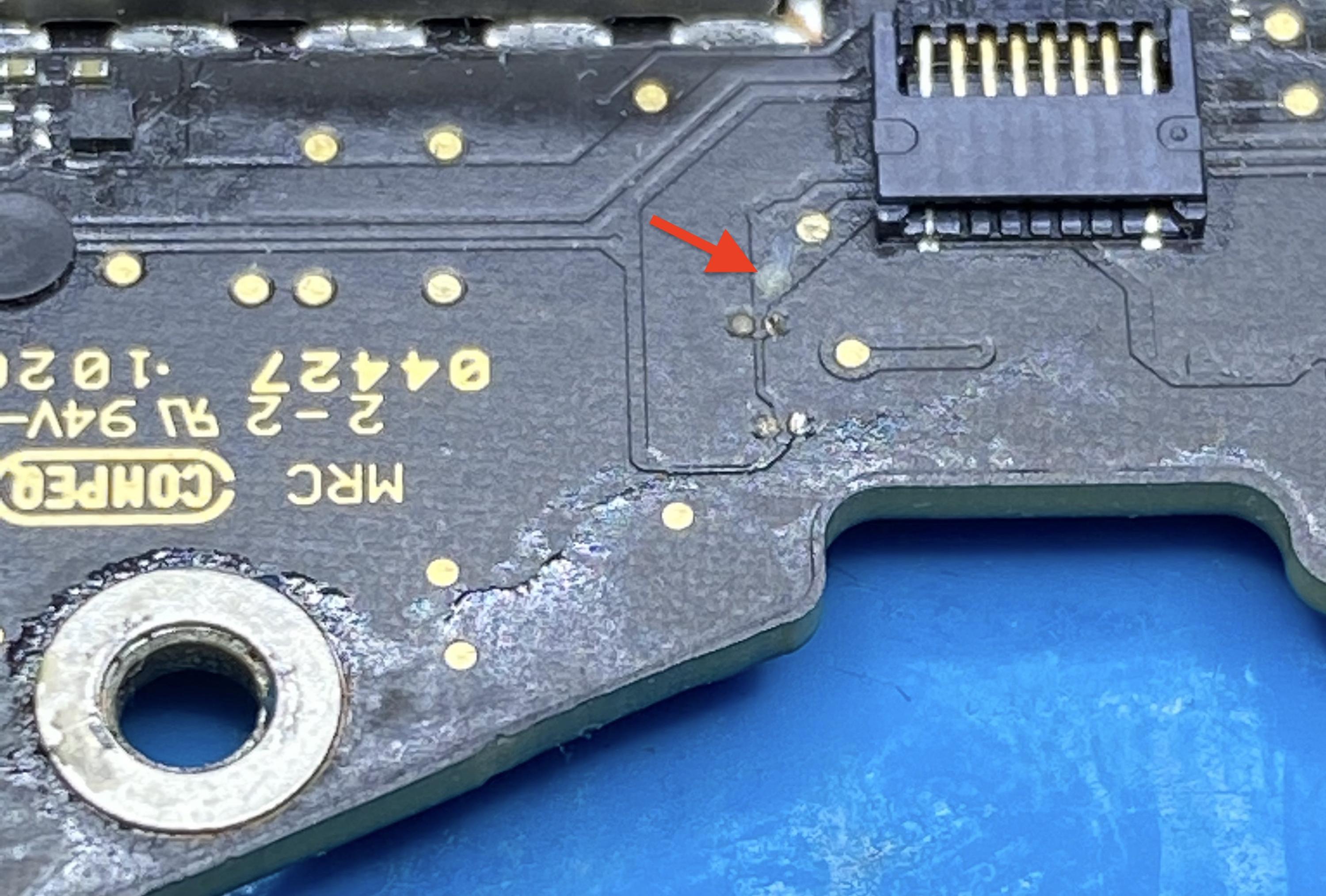

    Hello all,
    I have a 820-01987-06 Logic board to repair, does anyone know what the testpoint is connected to at the red arrow on the picture ? It is completely destroyed.
    Thank you for your kind responses

    Re: Trace identification on 820-001987-06 Logic Board (MBP 13" A2289 2020)
    Pp5v_g3s
