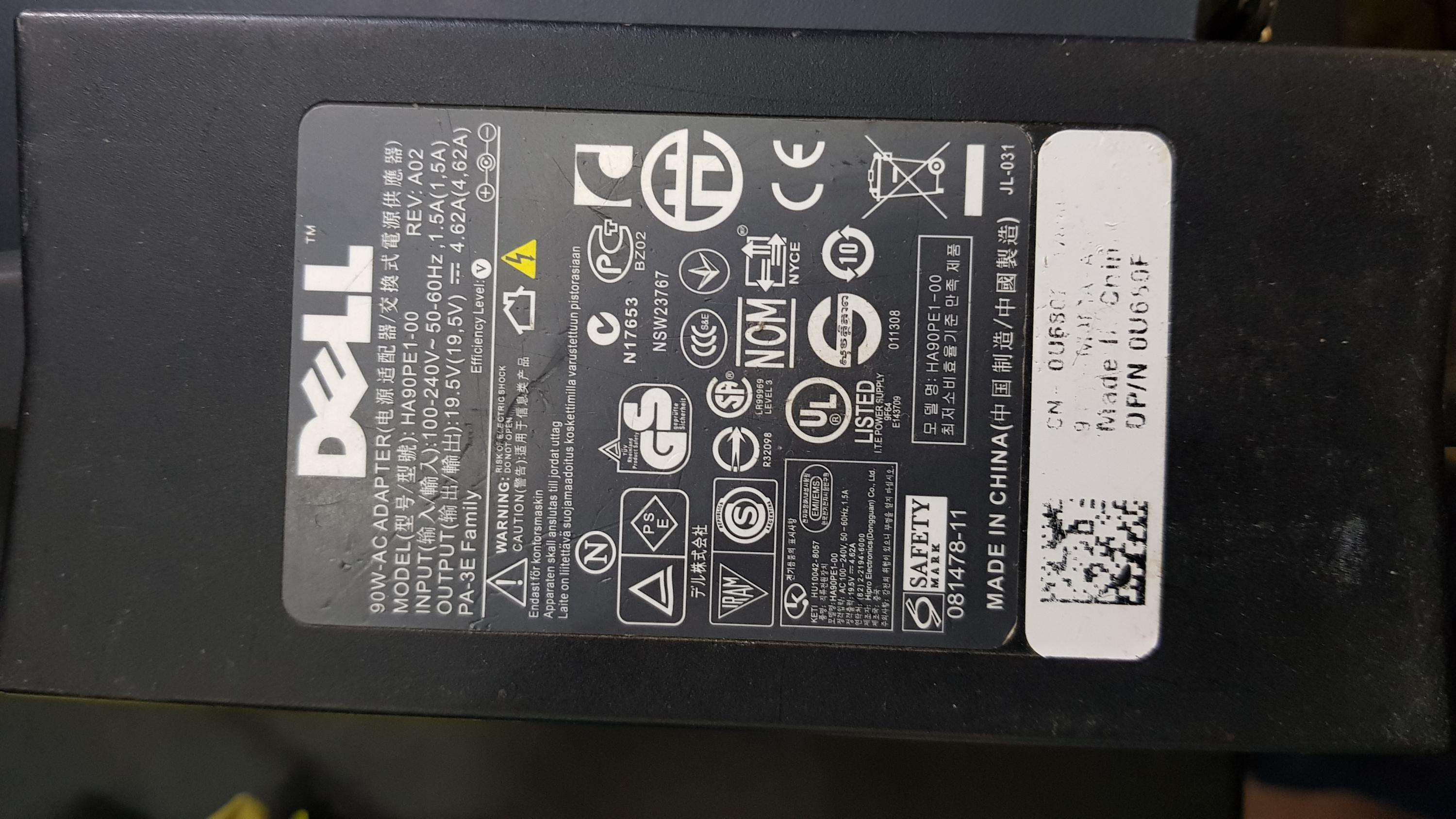

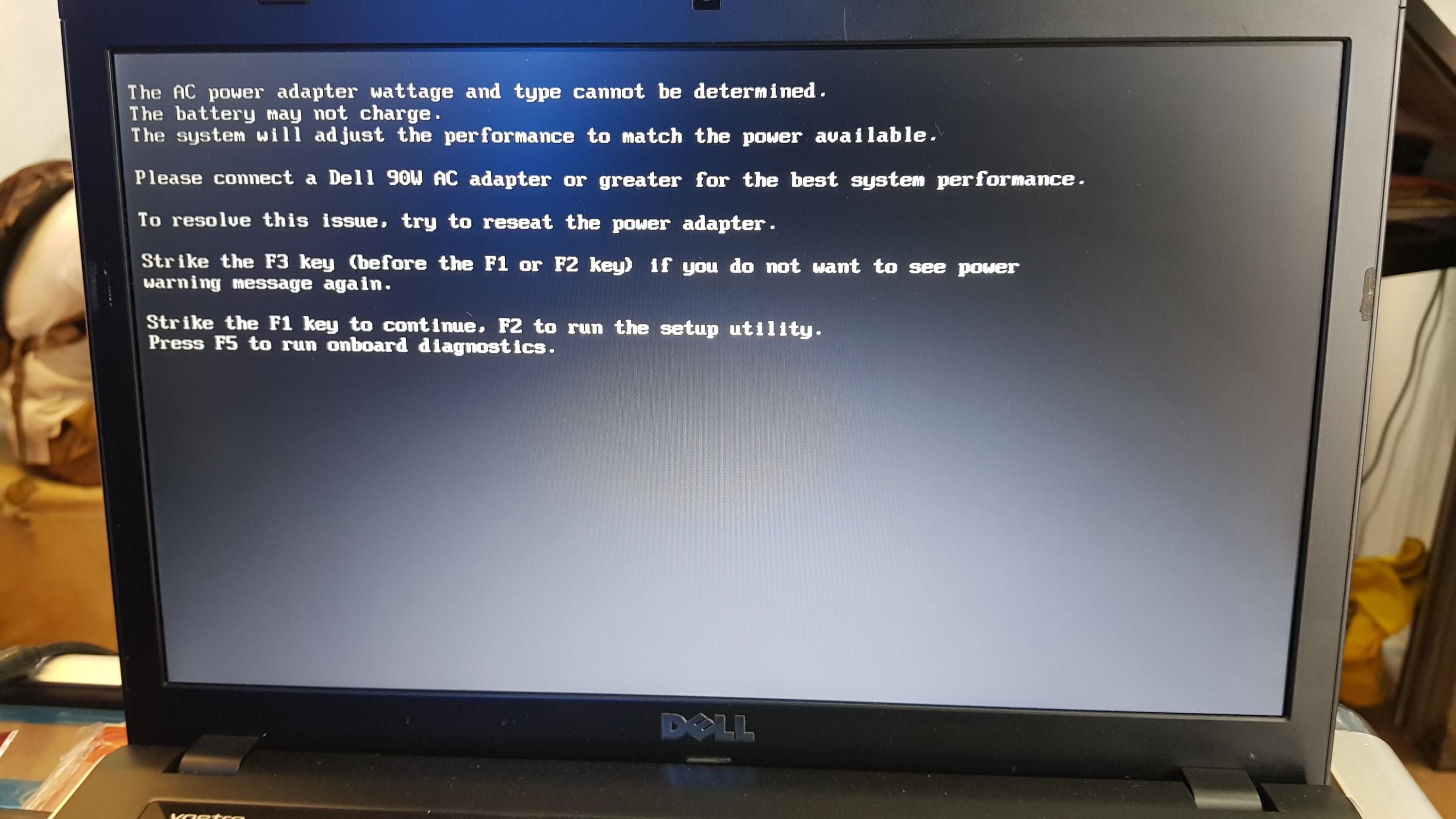

    Hello, kindly help the Dell Vostro is unable to charge even with the original 95W charger. Please help. See attached pictures.

    There is a third Rail from Adapter, named "PSID" or similar. Check this Rails Voltage and Resistance to ground (with all Power removed).

      Does the chrager have a middle pin? It could be that your middle pin connection on the charging port is loose or break.

        All dell's have a adapter identification circuit called PSID and the mechanism is almost same on every mb. You need to check "PSID" circuit as advised by @sephir0th
