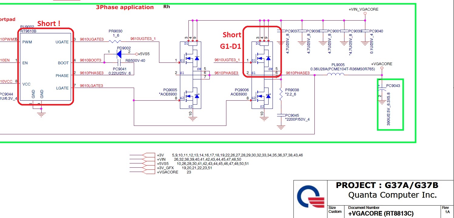

    Re: HP Omen 17-w010ca, Quanta G37A
    Piernov, your advise was 100% correct : "the MOSFET driver PU9002 has to be replaced at the same time" ! So without the PQ9006 in place, I did plug the power adapter to check the +VIN rail voltage ...and this chip RT9610 was very hot !I going to replace it ...So my question is: what was the condition for the MOSFET to have a short between G1/D1 and why this Rectified Buck MOSFET Driver is probably short as well ??
    • suiramix
      • Mar 2011
      • 131
      Hi everybody! I had this old project on hold due to some other priorities ... looking closer to this motherboard, I observed also PU6003 responsible for +1.35V_GFX (AOZ2263Q) voltage is very hot ! Could be one of the GDDR5 sticks shorted ? Can I convert the discrete video card to UMA (easily) ? Thanks...
