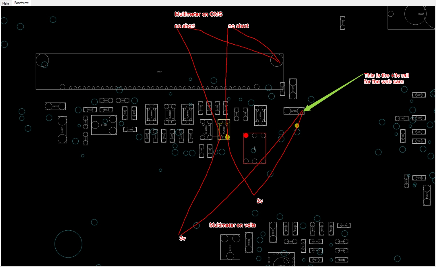

    Hi i got my hands on a asus x541uv, it works mostly but the USB 2.0 is not, i can plug in usb 3.0 devices on the usb 3.0 and it work fine but when i plug in usb 2.0 devices on the usb 2.0 or 3.0 slot it take like 15 secs and then windows show a error that the usb is not recognize, the 5v is shared over the 2.0 and 3.0 usb and is present so no problems there, i really don't know what else to look at, the usb controllers is in the cpu/pch combo is any chance is that bad? the entire usb2 doesn't work even the webcam mic combo don't work
    with the help of the boardview i follow the traces and all is working so is a death end for me at this point

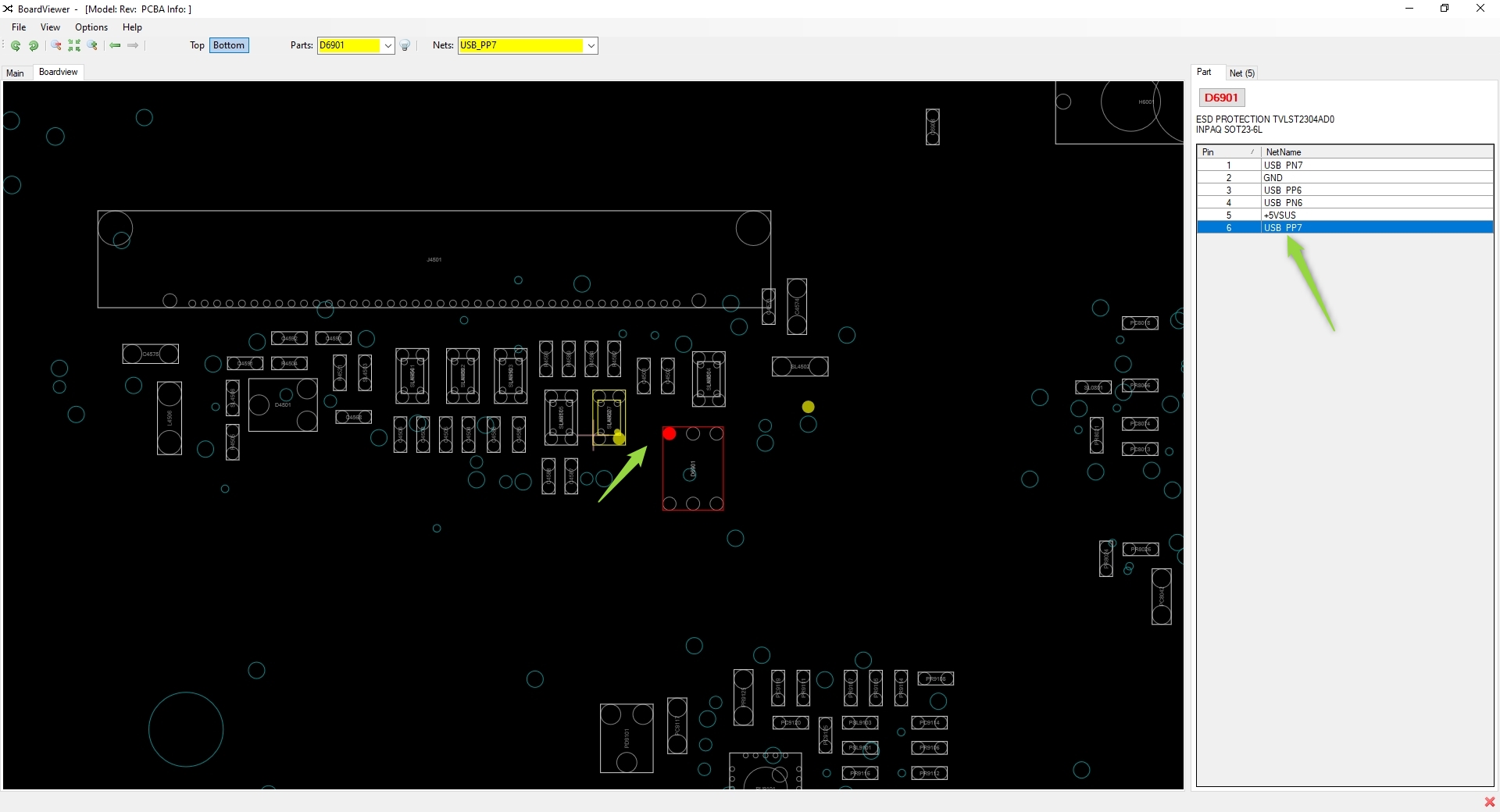

                  OK on the USB-PP7 according to the boardview is a usb not used by the board and go to the screen maybe for another webcam or i don't know, the thing is in the Pn7 if i test to the 3v going to the webcam i get the negative and show me the 3v on the multimeter, but i get the same result on the USB-PP7, but is not shorted to ground and don't give me any value when i test it on OMS, but it is a ground point that give my a 3v value when i test it against a 3v rail, so i gest this is the problem and is the SOC, there is a TVLST2304AD0 that serve as a protection but i take it out and the buard have the same issue, is the only usb-ppx that give me a negative value the others are fine but i don't see a way to isolate only that USB because after the TVLST2304AD0 it goes strait to the SOC
                  SO, i need to replace the SOC? a really bad luck to be the only non functional usb be short?

                    So, You mean the point PP7 on protection diode is shorted to GND?? It seems like my initial thoughts are turning true in your case.

                      the PP7 is not shorted to ground when i measure on oms or diode, but it serve as a ground point for the +3v, and is no continuity from pp7 to pn7, and is only on the "7" all the others pp are normal only give me the ground point to +3v on the PNx and PP when the usb device is connected give me +3v when i disconnect the device it show nothing
