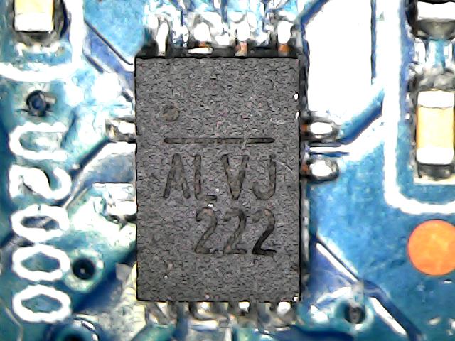

    Hey Guys,
    I bought some broken Laptops from an Amazon Liquidation seller and now I am trying to fix as much as possible.
    They where pretty cheap so failing ist not an drama
    Tools I own: Hot Air Gun
    Soldering Station Daytools LS-937
    USB-Microscope
    So acutually I should be ready to do all possible solder work.
    As I put some Voltage on the told Mainboard, I first used the USB-C port. Which showed no reaction at all. No charging light and no warming components.
    Then I saw, that it has an DC IN Port with "normal" connector. On the bottom of the Laptop it says DC IN 20V. Because I dont wanted to search the right adapter, I started with an 12V one. Which maybe was an smart idea.
    As soon as I plugged the charger, some SMD-Chip was starting to heat up very quickly. I added some alcohol to the PCB and it was the only part which does this. No other component is even warming up.
    No charging-light with this connector too.
    I made an screenshot with my microscope.
    unfortunaly I found NOTHING at all about the shown Codes. (ALVJ 222)
    Do you maybe have an idea what chip is could be? Or an schematic for this board maybe?
    I would realy happy about some hints here...
    Thank you in Advance

    Re: Lenovo Ideapad 120S - 11IAP Unknown chip heating!
    here you go
    U2000 (NB680GD) IC belongs to 3.3v
      so thanks to your schematic I did a lot of measuring and it turned out, the be a faulty IO CHIP. The complete 3.3V rail is shorted.
      As I removed the ENE KB9028Q all shorts where gone. Directly at the Chip where multiple short (about 6ohms) between VCC 3.3 and GND.
      So I will order a new one, and lets see if it comes back to life
