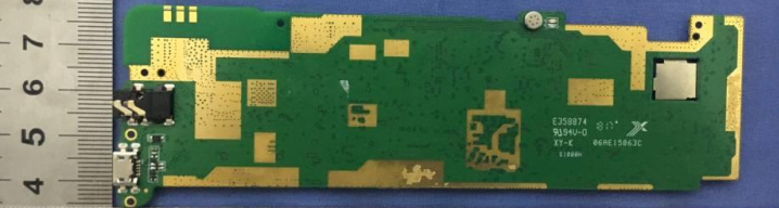

    Hi guys i repairing a acer tablet its had a bad charge port so removed that and ordered one, i then checked the positive and negative pads on the pcb there was a short still so i have tracked it down too a diode, it maybe a protection diode as its on the positive pad a few mm from the charge port positive leg, (diode marking on pcb under part) the number on part H7 which i think is a sod123 fl zener diode i dont have any, but i do have a 22v through hole zener could i use that ?

          Thanks just looked at the pictures of the pcb the board i have is laid out different and cant find that H7 part the label on my board says A10L3 V1.2 16G
          This is the exact board and page 9 shows the diode in question left of usb above the screw hole

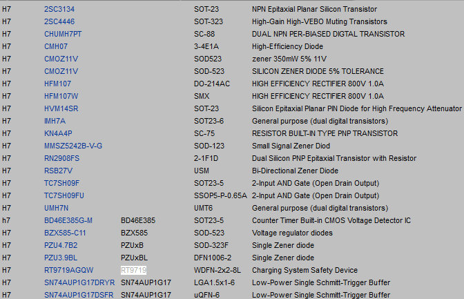

            If you`re sure its a zenner i found this one with H7 marking code Vishay MMSZ5242-G
            https://cdn.badcaps-static.com/pdfs/...cb6003de87.pdf
            Yes i`d say you should be ok with the one youve got.

              Thanks, Im honestly not sure if it is a zener i googled H7 and thats the part i put the data sheet up for, in your experience in that location on the usb port area would it be a zener? not sure what caused it too blow i removed the port thinking the pins had shorted out and the pcb pads was still shorted i removed the h7 part short went part reads sc i have tested the tablet via a good battery it works fine so just need too sort the usb charging out.do this i dont usually do this type of small smd work but might as well use my scope and practice fault finding.
