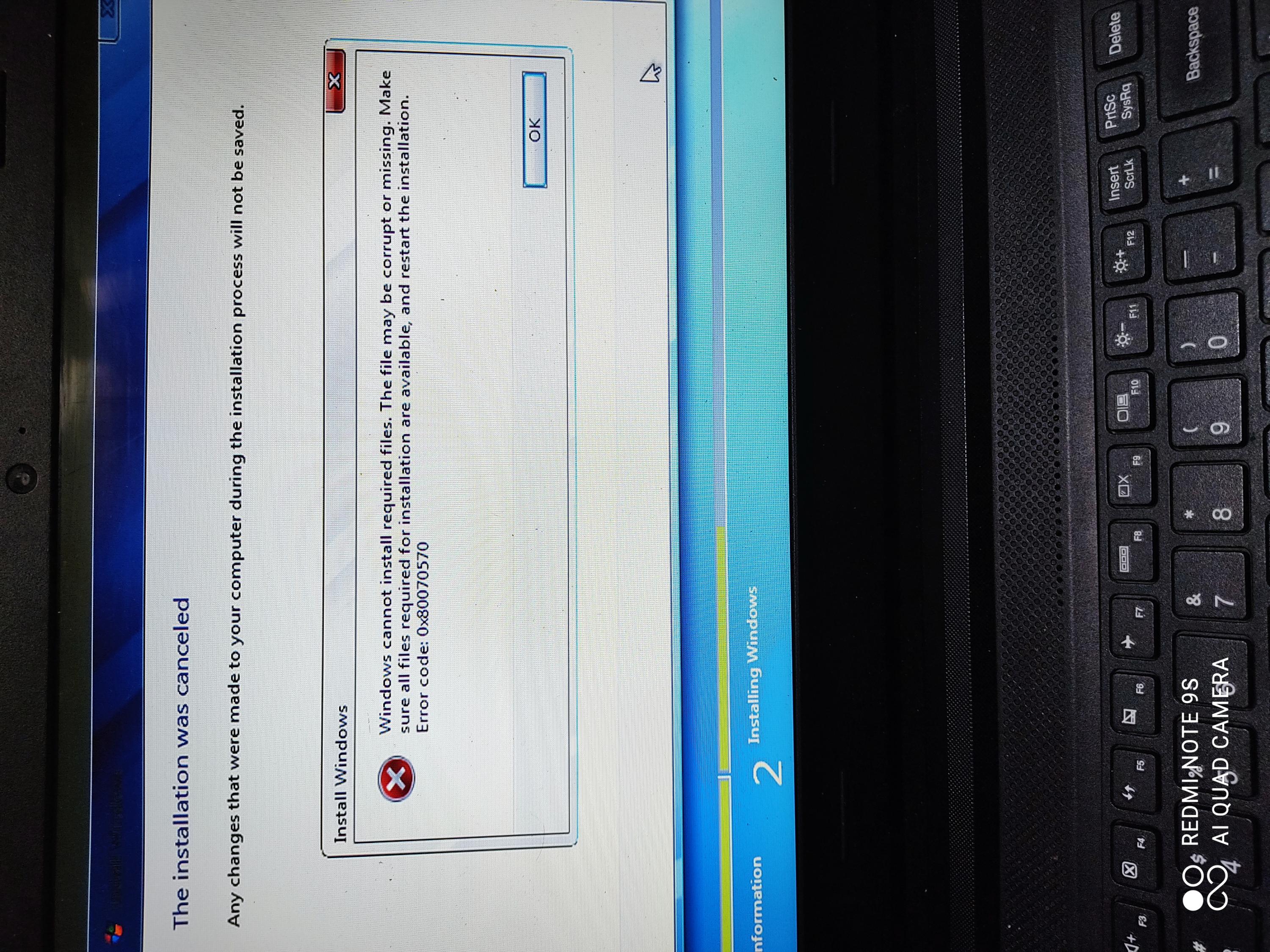

    Hi guys
    I have Lenovo Ideapad 100-15ibd and can not install Windows no matter what. Tried Windows 7 under AHCI or Compatible with bootable flash drive and always error while expanding files at 90 something percent. Changed few RAM modules but the same problem, changed 3 HDD the same, tryed with SSD the same. Changed several usb flash drives, 3.0 and 2.0 the same, tried Rufus and Ventoy but the same problem. If i try to install with a DVD disk it finishes expanding but won't continue the second phase of the install after first restart, gets stuck either on Windows logo or blue screen comes out.
    Tried Windows 10 inder Legacy and Uefi it won't install either. It finishes the first phase of the install and then either gets stuck on Logo or "Kernel Security Check Failure" or another error which i can not remember exactly at the moment. Flashed the latest BIOS, tried with both "OS Optimized Defaults" dissabled and enabled, enabled and disabled secur boot, reseted Bios on the board and nothing helps. If anyone has a suggestion i would be very thankful.
    I searched on the Internet and there are suggestions that it is probably CPU problem (i3 5005u), but no one confirmed, haven't found someone with the same problem on the same laptop.

    These are the errors i get after the first install phase of Windows 10 after the restart nad then it goes into automatic repair
    "phase 1 initialization failed windows 10"
    "acpi bios error windows 10"
    "critical process died"
    "crypto library internal error"

      i would see if it will run live linux and if so do some testing
      and maybe try install from usb as it could be the dvd drive
        Tried Elemental also, either boots and gives error of critical process can not start or does not boot at all and geta stuck on console screen.

          If you laptop has CD/DVD unit, try to install using a sata caddy adapter, maybe your sata port is faulty.
            Tried it, tred with the integrated dvd drive and with a usb dvd drive, same problem. Sold it for parts yesterday
            Thank you for your reply
