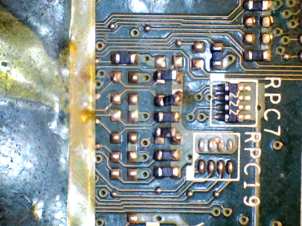

hi,
Acer Aspire A515-51G comes with onboard RAM (4GB) errors that doesn't allow install Windows in anyway (blue screen.)
On BIOS there isn't any set to disable the onobard RAM so actually I decided to soldered away the 4 RAM chip.
Right now without installed RAM on the slot the machine just power on and shut off soon next. With a RAM stick it power ON (0,6A) but black screen.

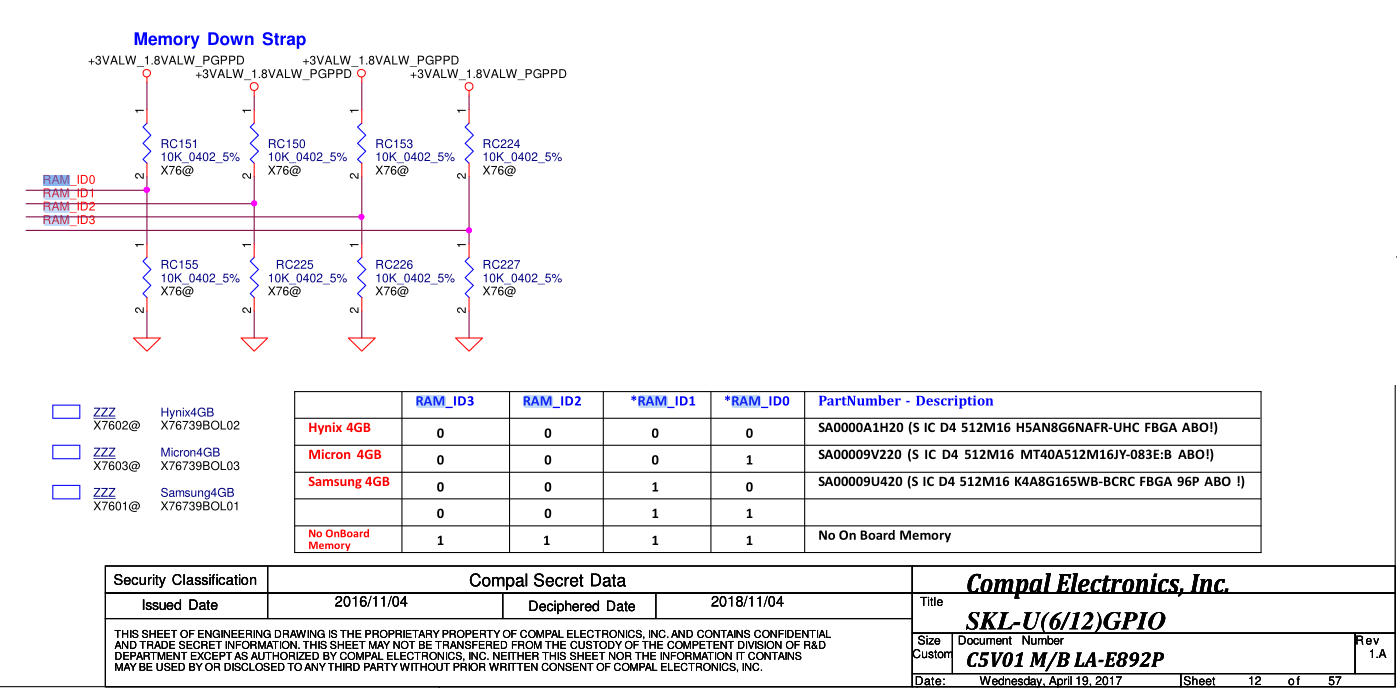

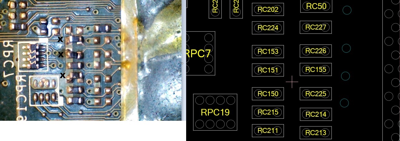

I've seen that for Asus boards there are some resistors to shift or maybe if its possible to modify BIOS so to make it possibile to BOOT just with RAM installed in the slot.
Actually I tried 4GB and 8GB tested RAM with no luck.
