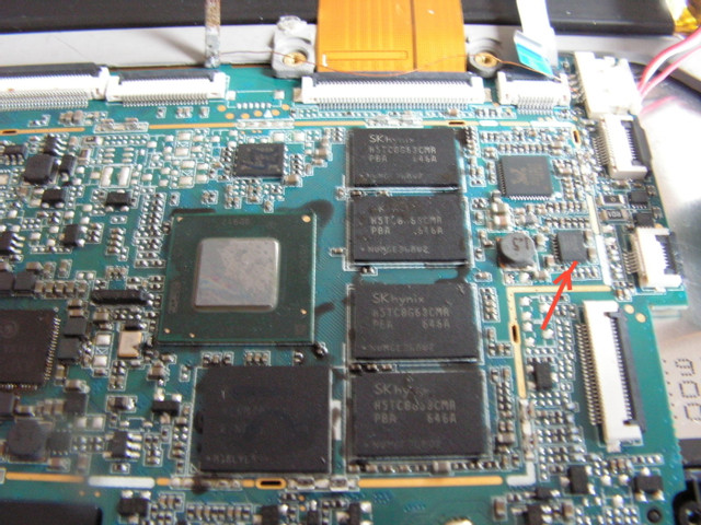

Can anyone please help me identify this IC?
  • Jane
    • Aug 2010
    • 188
    the IC is used in Lenovo Ideapad MIIX 310
    Here are pictures
    I marked the IC with a red arrow
    https://ibb.co/jDs9Wsb
    and on this picture the IC is from the bottom
    https://ibb.co/Stcsjz2
    There is a three-line description on the IC
    MPGG
    2625
    B716
    Anyone have any idea what IC is that?

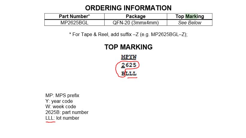

    • 21195
    Re: Can anyone please help me identify this IC?
    Its a Monolithic Power 2625B IC.
    https://www.monolithicpower.com/en/d...ument_id/1420/
    • Jane
      • Aug 2010
      • 188
      Thank you for help.
      But how did you finding? There is a different marking on the IC?
        • 21195
        Originally posted by Jane
        Thank you for help.
        I don`t understand what you mean by "There is a different marking on the IC?"
        See the datasheet and the picture,it explains the marking code and why it is different.
        • Jane
          • Aug 2010
          • 188
          There is MPGG 2625 marking on the IC I was searching for.
          But you provided ( correctly) IC marked as MP 2625.
          How did you know, from MPGG 2625 ( I provided) , the correct MP 2625?
          Thank you for reply
