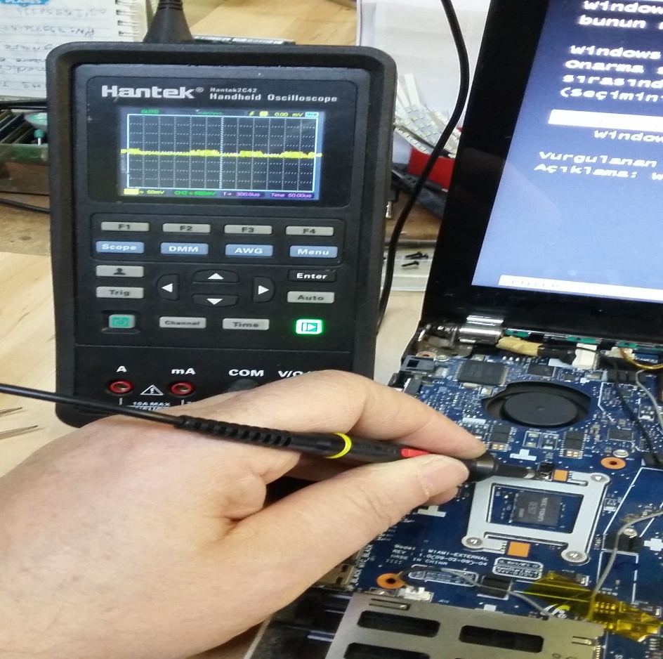

                There are a bunch of 330uf capacitors in that circuit. If they were bad, wouldn't I see voltage spikes with an oscilloscope? I see a perfectly flat line in CPU core voltage. Could they still be to blame? Any way of testing without swapping all of them?

                  It may be a wavy (distorted) waveform as shown in the picture. sometimes the capacitor may not support the inrush current draw. VCORE capacitors should be next to the processor.

                    this picture
