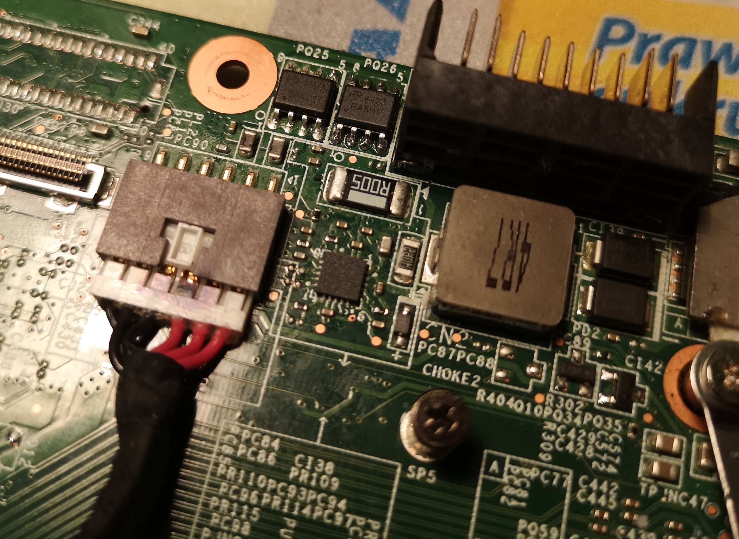

      Hi, i have a different problem with same board. Mosfet PQ26 (AO4413) heats up to over 100°C and laptop turns off. Nothing else was heating so i replaced it and problem is the same. How can i find source of the problem?

        Was the AO4413 soldered in the same orientation for pin # 1 ?
        Also, for this part to be heating, the component may be under severe load.
        Remove all power -> check the resistance to ground of source pins (1-2-3). What is the resistance ?
        Also check the resistance to ground of the drain pins (5-6-7-8). What is the resistance ?

          to be precise, i replaced it with equivalent because i couldn't reach 4413, i put there AO4423 which should be ok, but as i said - it didn't make difference. As you can see in the picture - orientation is right - both mosfets are connected on their drain sides.
          As for resistance: it shows stable 391k on drain side, but on the source side it varies very much. First time i touched it - it has shown values from 20k and rising, checked again - start at 30k and going down. I waited a few seconds and checked again - from 10k and rising. While i was writing this i checked again. Drain has stable 363k, but source has shown 8k and rising.

            in the meanwhile i checked original AO4413 again and it turns out that it's ok - not damaged. Ill solder it back in and then check resistances

              If the mosfet is heating it up, it is for a reason. You are drawing too much current on the mosfet pins or the mosfet is defective. The replacement looks suitable.
