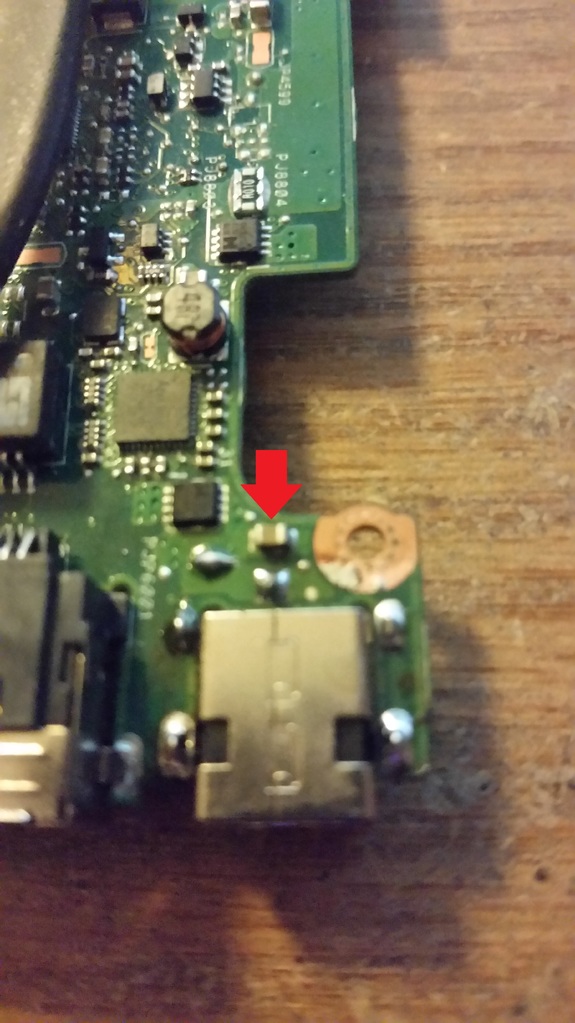

Hi all, I am working on this ASUS Q400A Laptop. There is a short to ground & I even figured the fault. The Ceramic Cap is bad. Since I do not have the schematics for this model, can anyone inform me what will the value of this ceramic caps be?? It is using a 19V power adapter & the caps is on the circuit of the Power jack (Middle Positive pin) & ground. Thanks

Look here: https://www.badcaps.net/forum/showth...ight=ASUS+U47A
Apparently the U47A and Q400A have the same board. -
