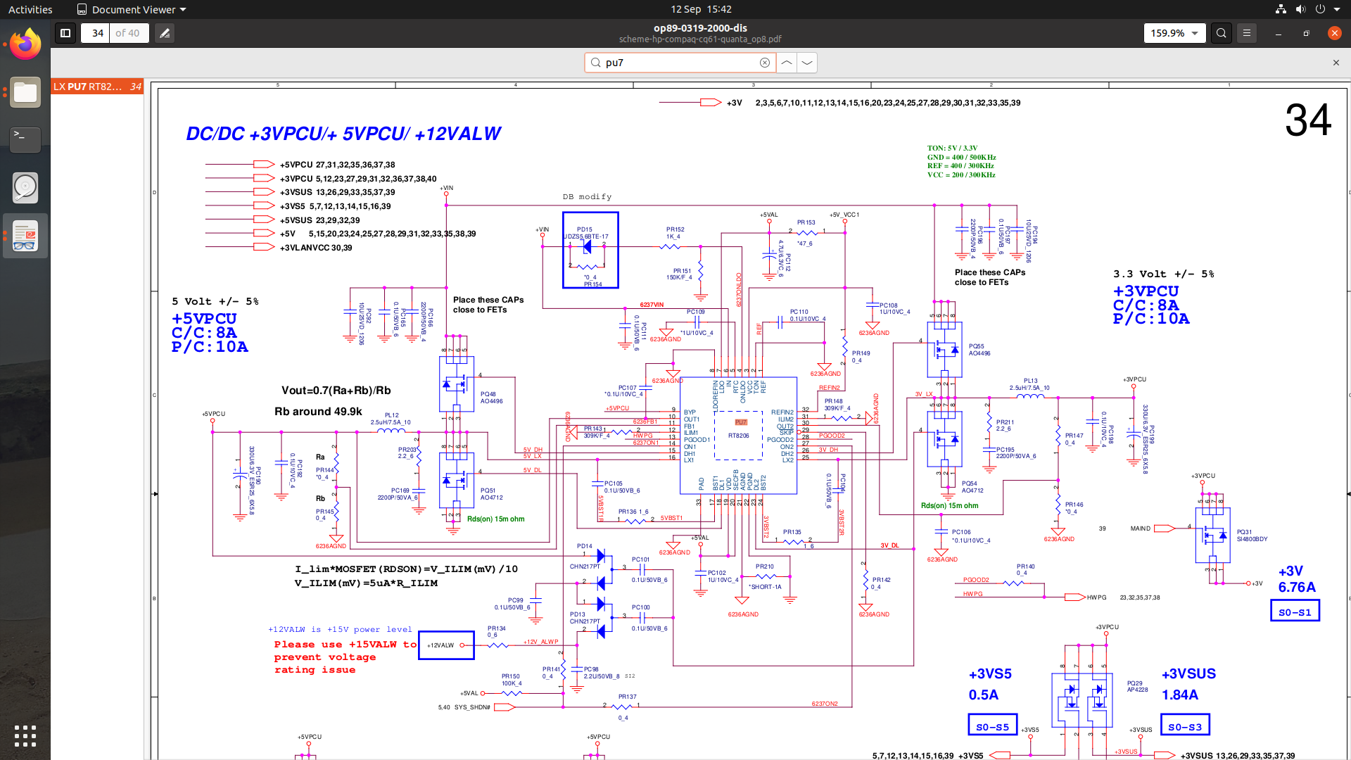

    Hi all ,
    Shorted this laptop when resembling(left charger in)
    Put laptop aside for when i had more time ,which turns out to be now just whizzing around the board
    +5VPCU=150ohms
    +3VPCU=14ohms
    Found 150 ohms on +5VPCU is with PL12 Removed (+meter probe on 5VPC side & -probe on GND plane)
    Also 14 ohms on +3VPCU with PL13 Removed
    Would i be right in thinking this isnt correct
    Schematic page attached

    Re: HP Compaq CQ61 Quanta OP8
    I think it has serious damage. can be on io or chipset. but try to remove fet(vs) on the short rail
