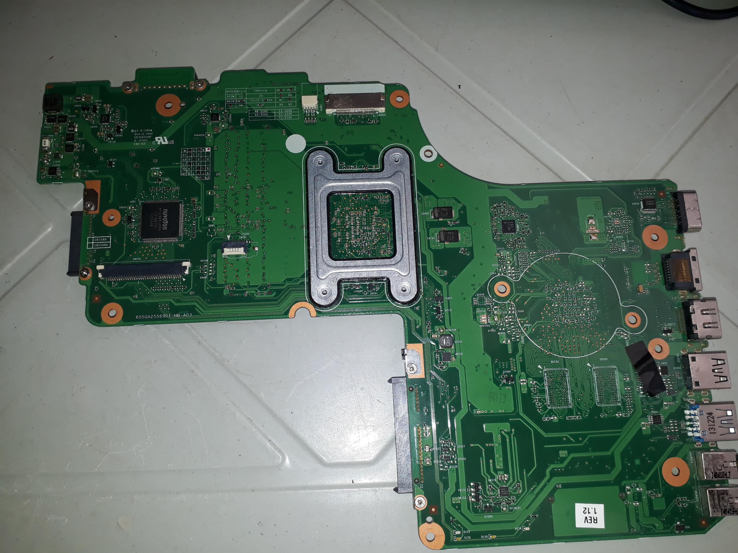

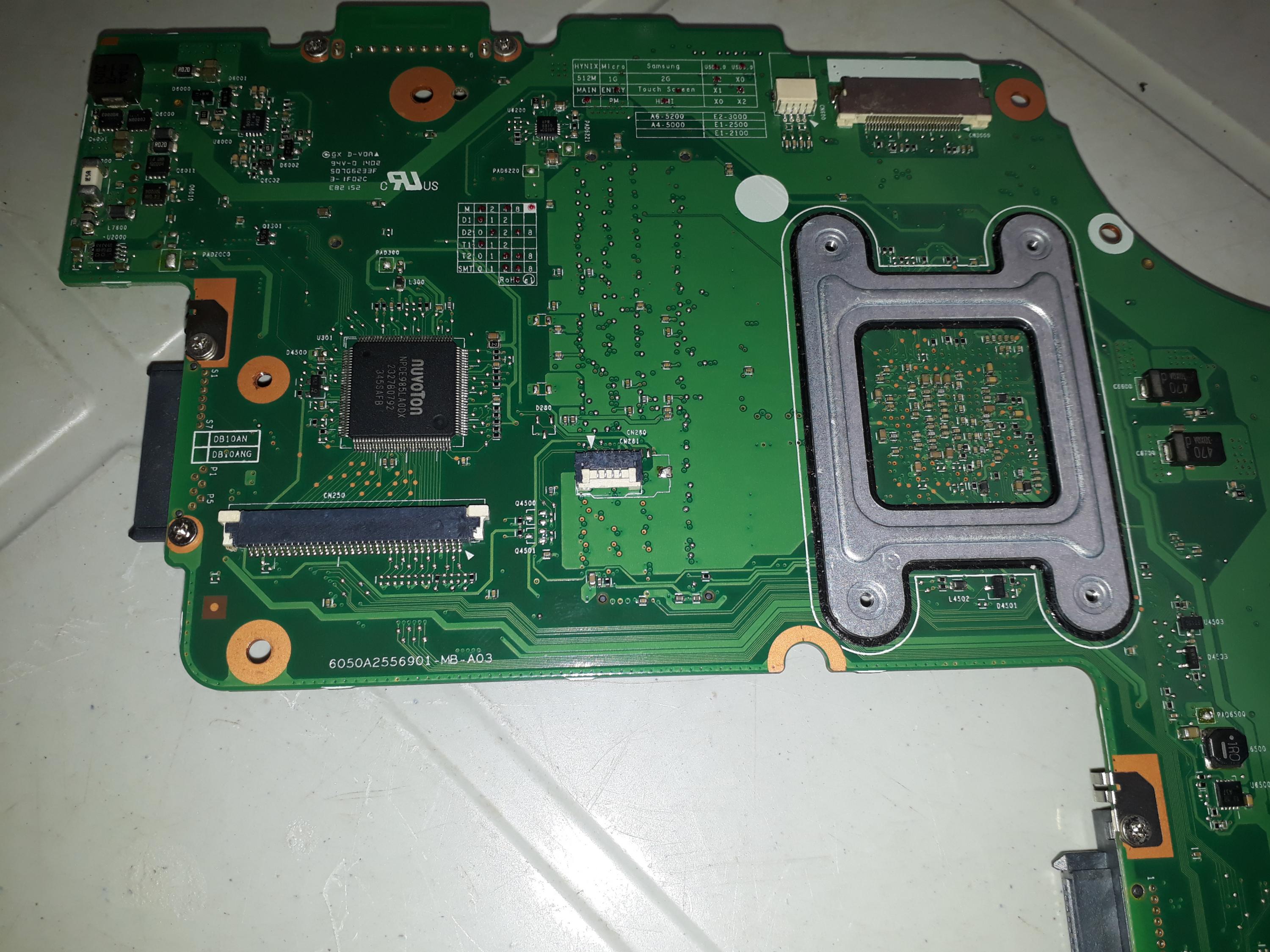

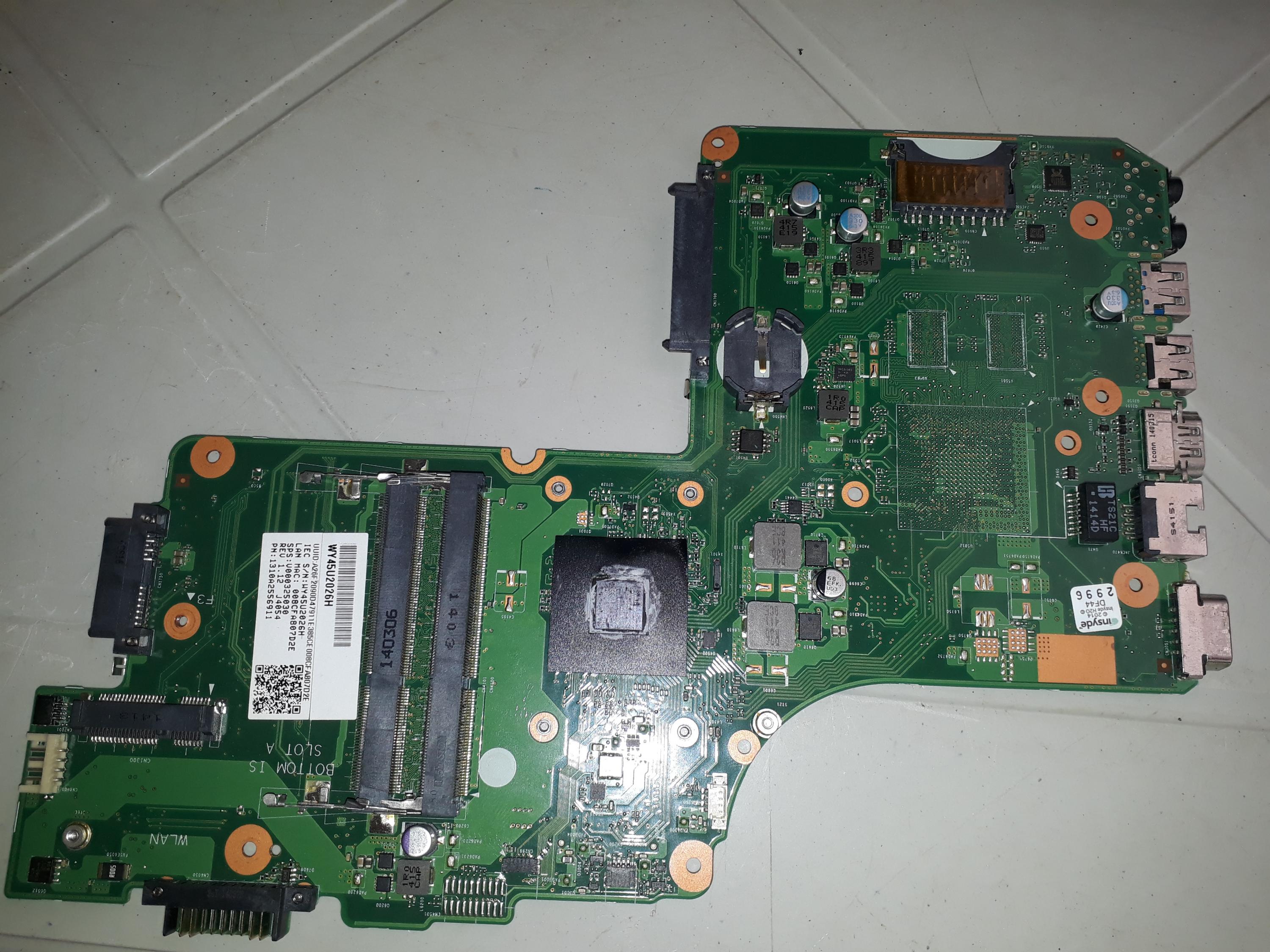

    Hi all
    I have a customer laptop that have problem no lcd display even external display to vga and hdmi output.
    Can power on ,ok
    If remove ram has beep sounds, ok
    Keyboard beeps sound ,ok
    Fan working ,ok
    Troubleshooting done:
    Clean ram
    Put thermal pad/paste for processor
    Change ram from other working laptop
    Reset bios/remove battery
    Reprogram bios from ezp2019
    And even reflow or reheat processor just normal reheat/reflow not yet put flux bec. To dangerous for processor
    Output the same no display internal and external monitor
    Please can any body help me with this problem
    Or can any body encounter this problem and what you do to make it work again
    Pictures attach
    Tnx all especially admins

    Re: Toshiba satellite c55d-a5108
    Here is the link for boardview
    https://www.alisaler.com/toshiba-c55...a02-boardview/
    Check voltage on all coils and see if any rail is missing.

        The only defective component who give you any pictures on your internal or external screen is the GPU, or something around it.

            Can anyone tel me where is gpu in this motherboard or it is in processor combine gpu n processor
            • Duranitron
              • Jul 2014
              • 544
              • Philippines
              it is integrated to the AMD processor if all the power rail is present.. the integrated gpu most likely it gone bad..

                      So i guess no one encounter this on this laptop brand... so gpu/processor reflow again 50/50 might death or alive

                        if the gpu fails.. reflowing doesnt repair it you need a new processor..
                          maybe the first attemp to reflow it... kills it.. this is the problem of most integrated processor and gpu.. it is disposable..the processor is good but the gpu is bad theres no fixed there but to replace it..
                            just replace the processor/gpu.. to solve your problem.. make sure when you buy a new amd processor just indicate to it the balls must be lead type dont buy the lead free type just a suggestion the lead free type if you dont have a reflow machine you will definitely kill it due higher melting point of the lead free solder. mahal din ung amd processor tol.

                              Ok tnx bro.. i just reflow no luck again today... ok i take ur suggestion.. tnx
                                before you attempt to replace the processor.. try to find shorted cap around the processor area in some cases thats the only problem but if you cant find shorts definitely your only option is to replace the amd processor

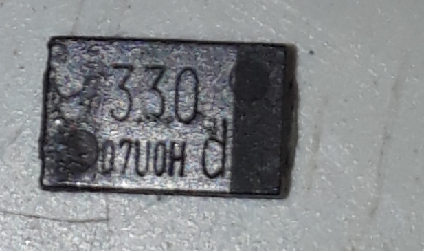

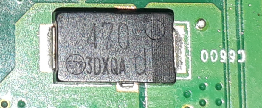

                                  Bro can i replace this 330 two pin to 470 3pins? Pin2 n 3 are ground
                                  c picture
                                  The other 470 is pin1 n pin2 to pin3 shorted the other 470 is not shorted
                                  Pls advice
                                      you need to stick to the original value.. that cap value is there for a reason..a 10% tolerance maybe use but 470 is way too high...its almost 50% tolerance,, my opinion...
