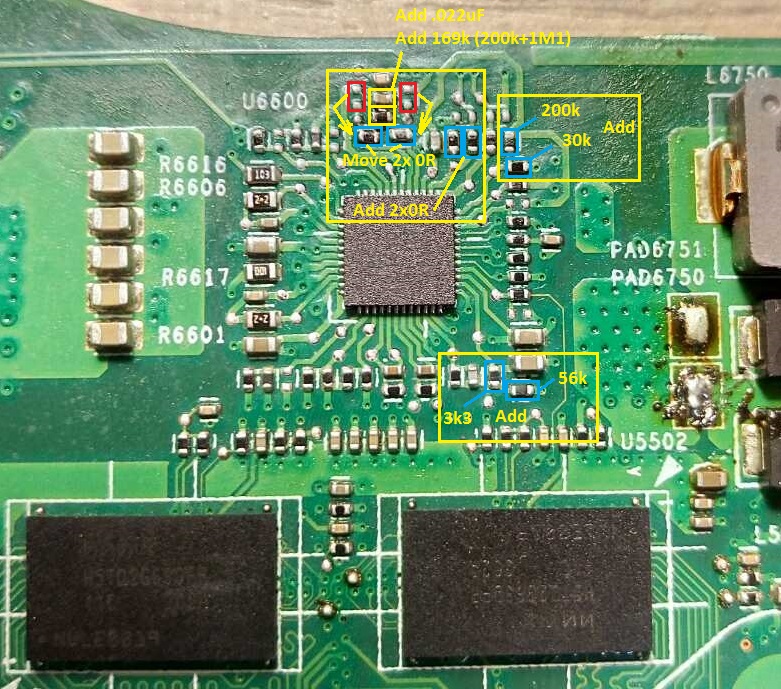

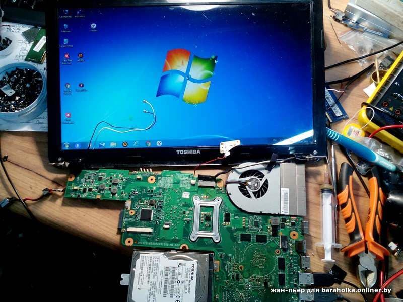

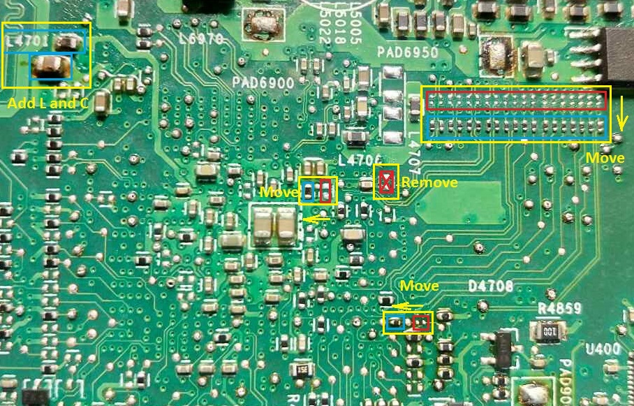

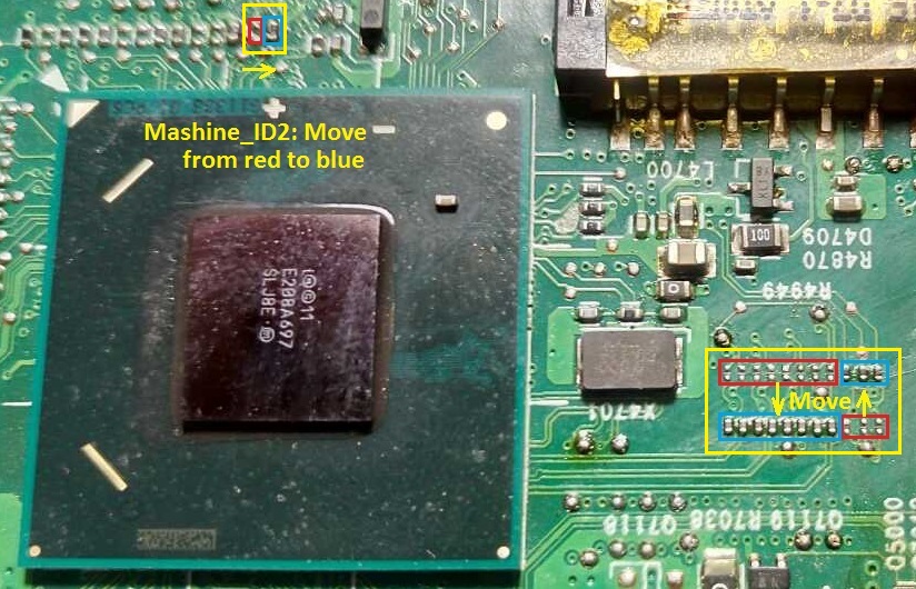

    Inventec DAKAR DK10FG DIS to UMA
    Runs on Intel HD Graphics like evil

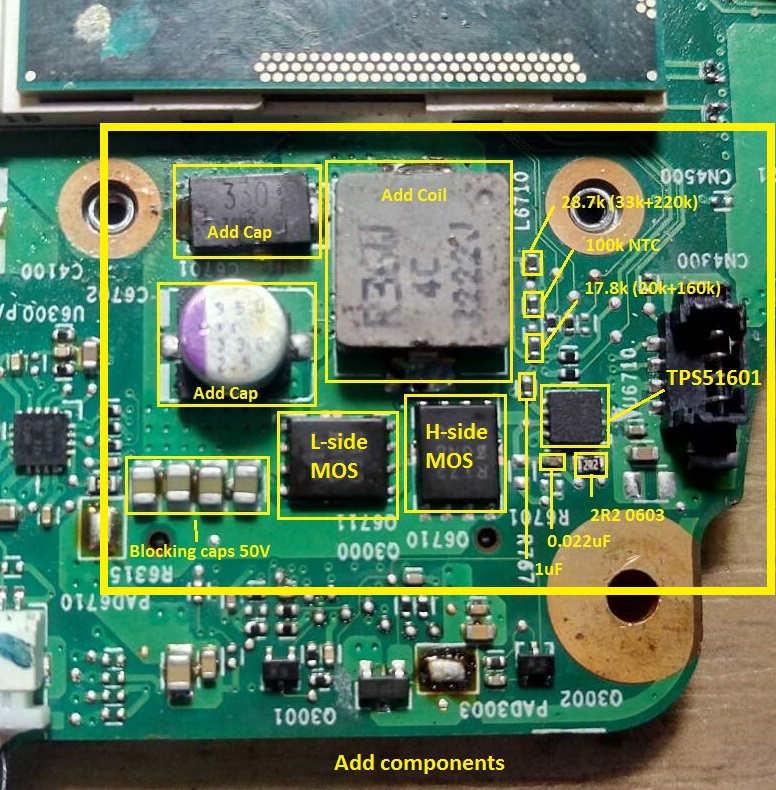

      Re: Inventec DAKAR DK10FG DIS to UMA
      There is one mistake - bootstrap capacitor on 2-nd picture left to 2R2 0603 resistor under TPS51601 must be 0.1uF intead of 0.022 uF. Model of laptop is Toshiba L855 or some...
      Also I remove 216-0833000 from desk, did not try with chip on board.
            Sorry for late reply, all was done according to schematics and boardview, everything was working
            Is voltage on +VGFXCore coil present?
