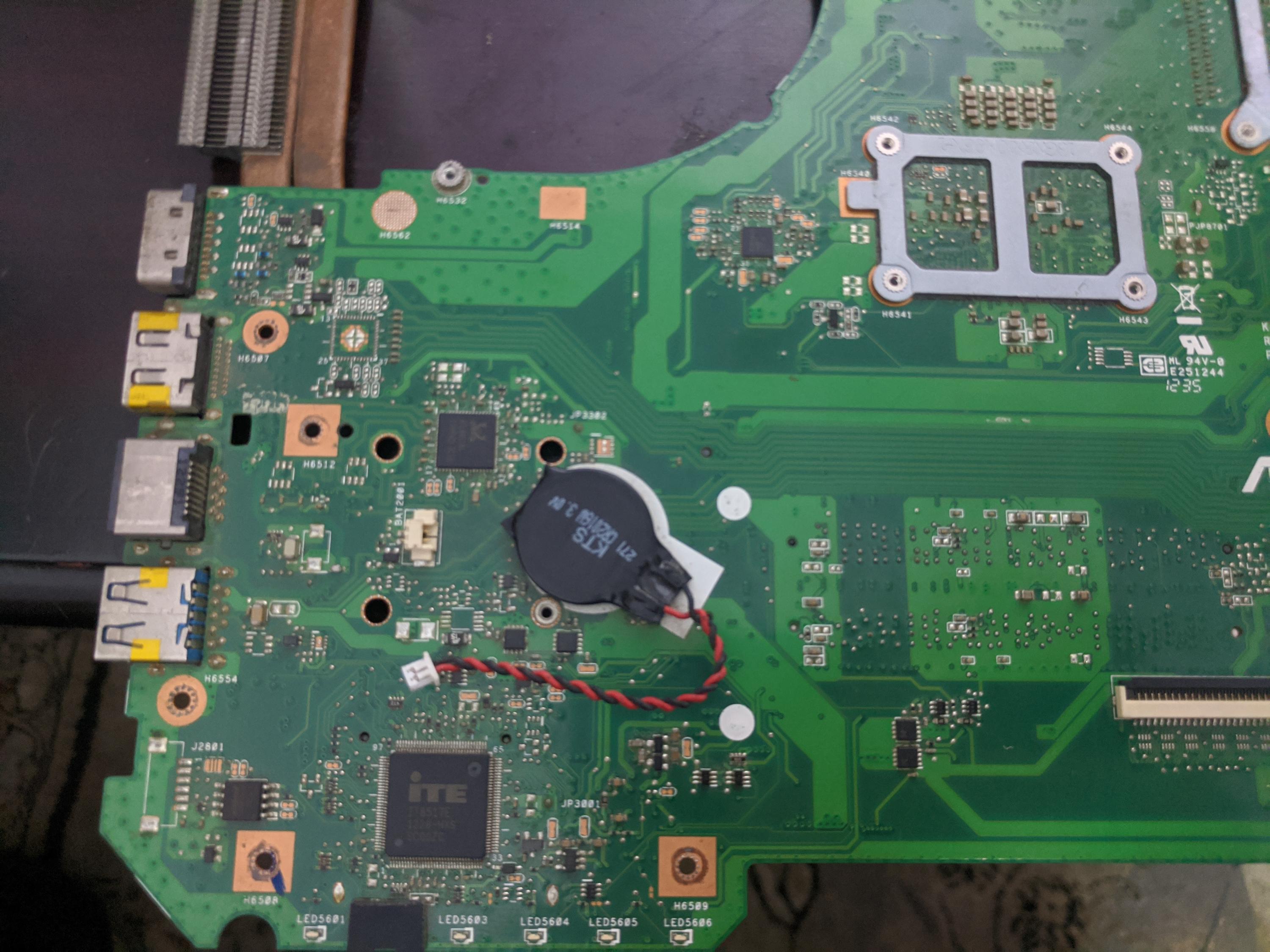

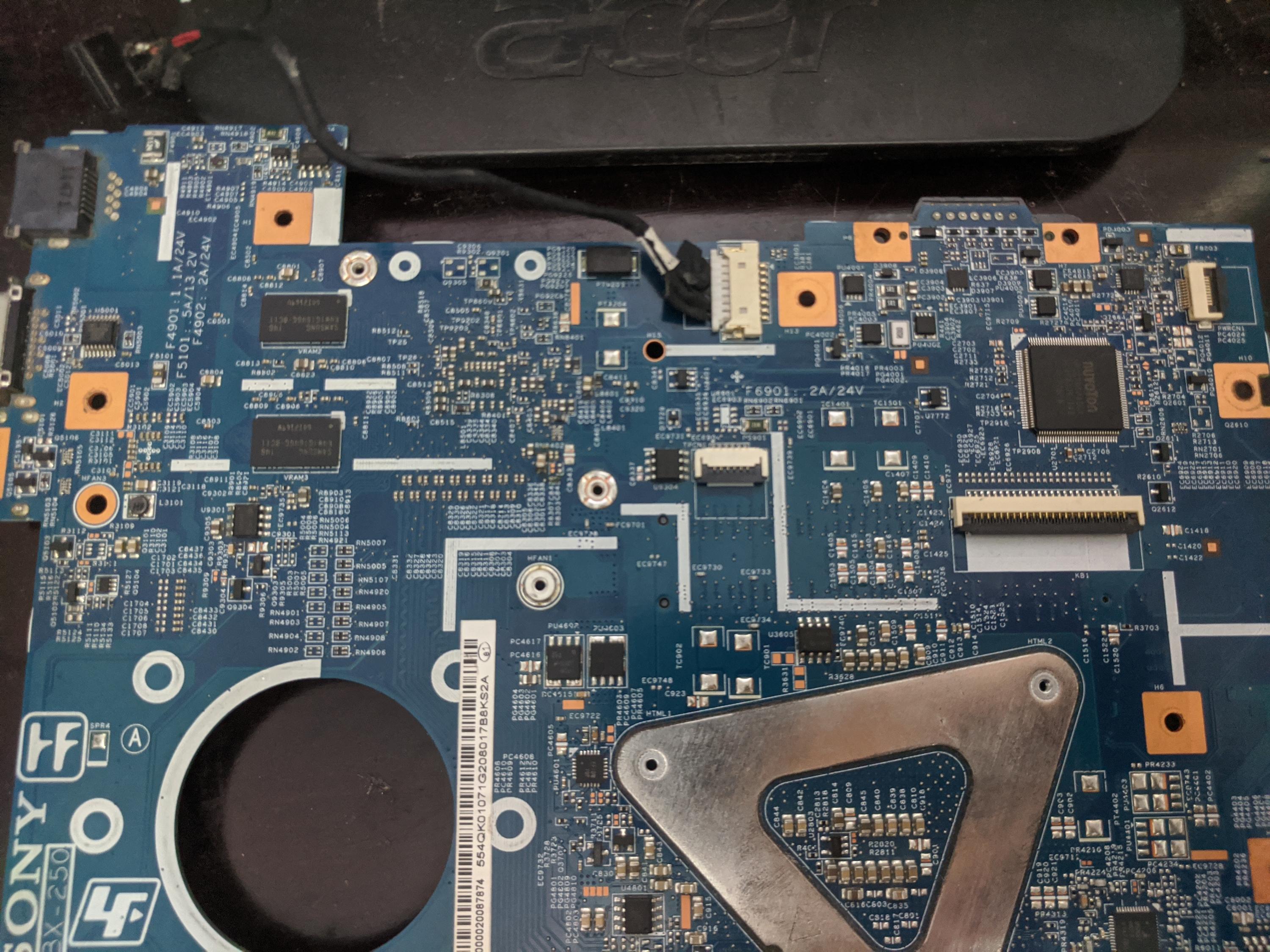

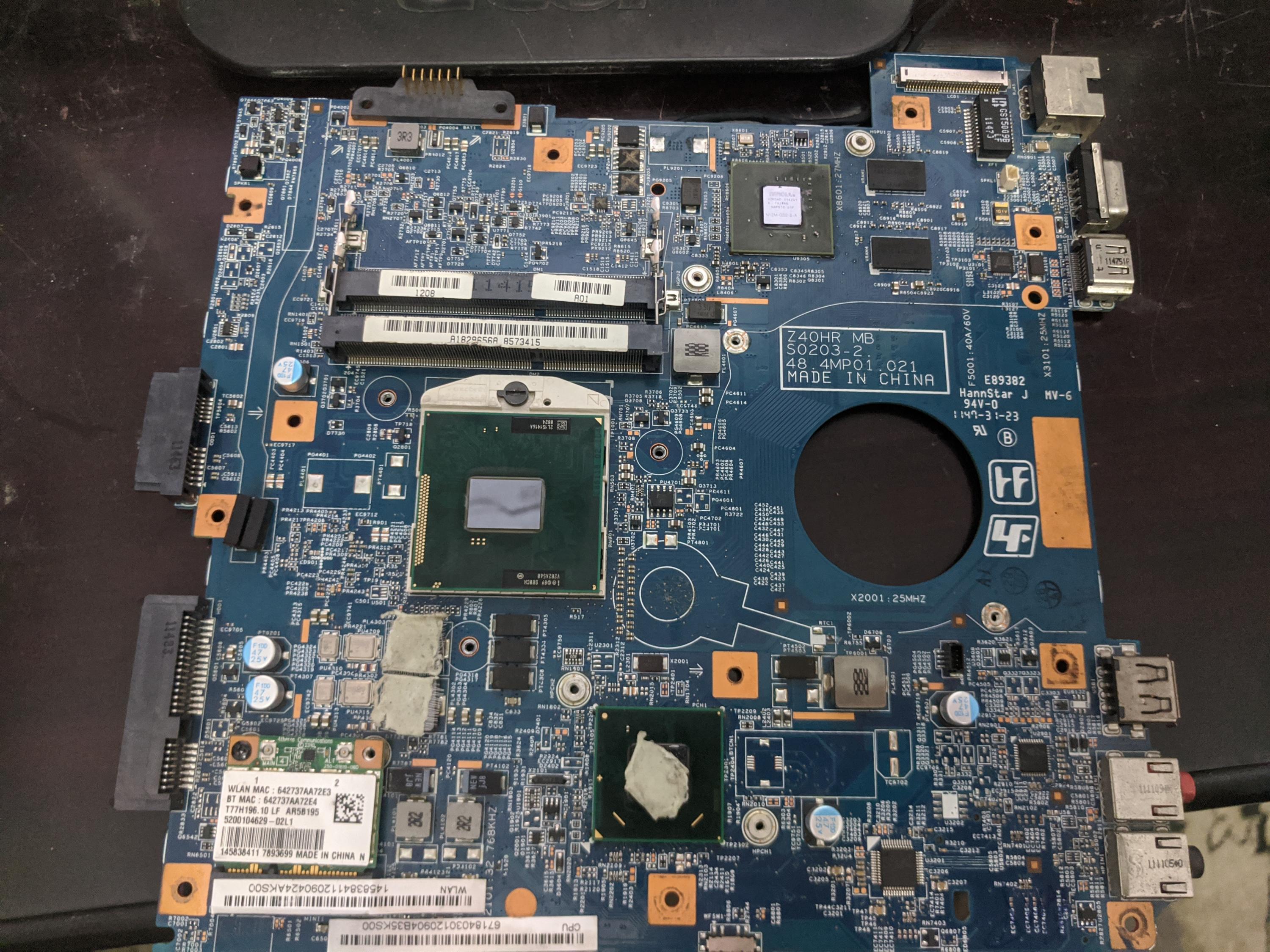

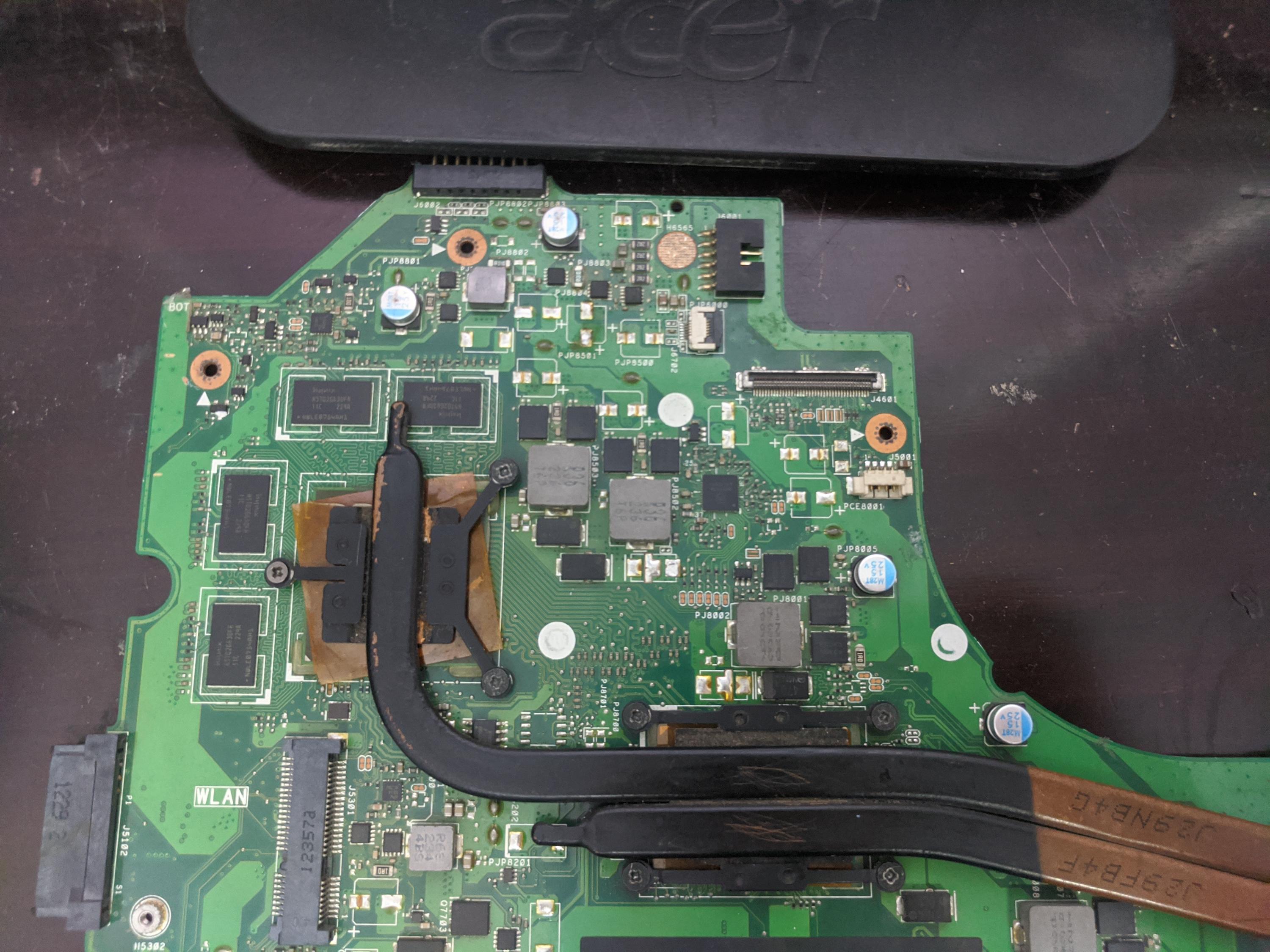

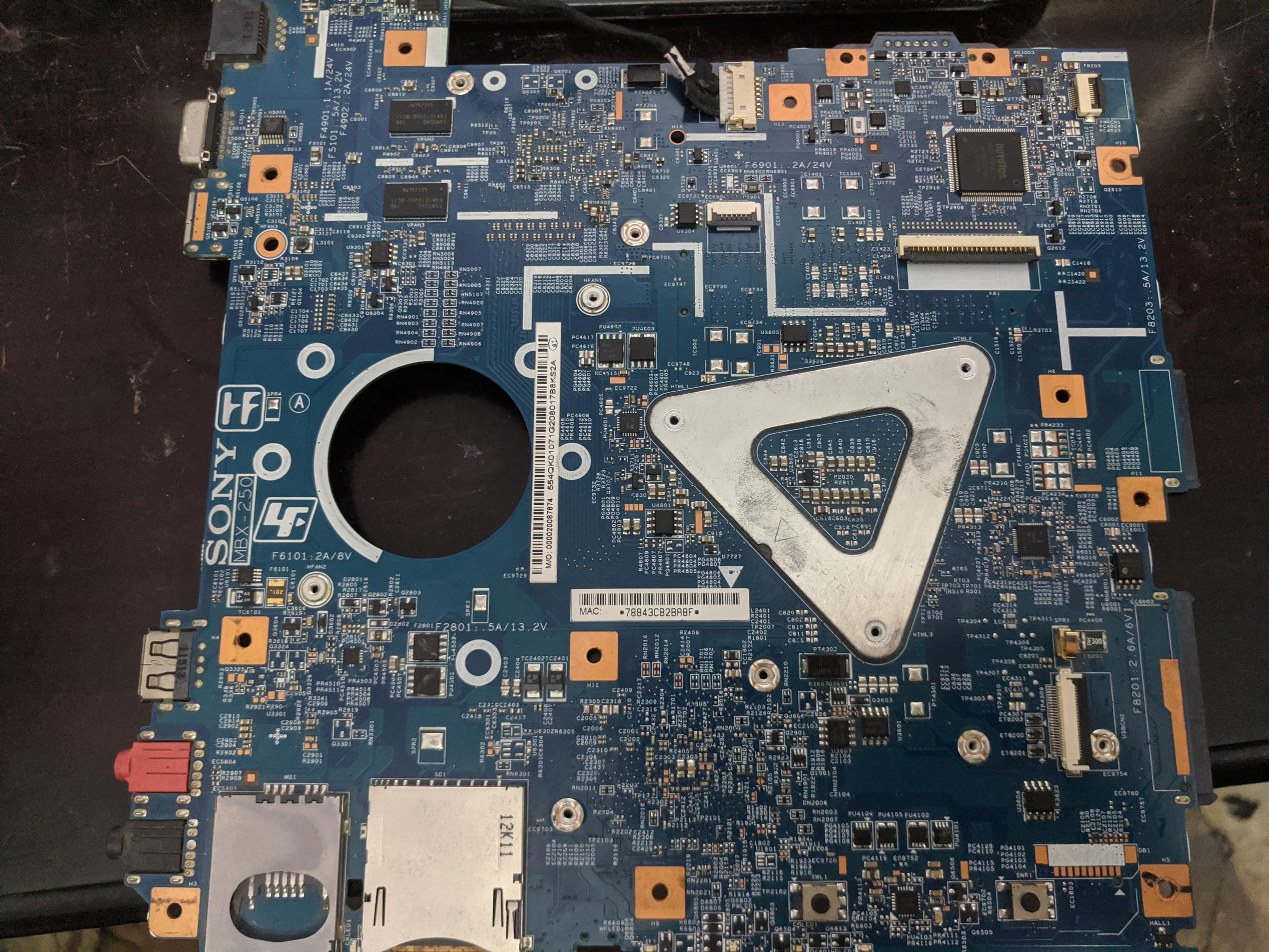

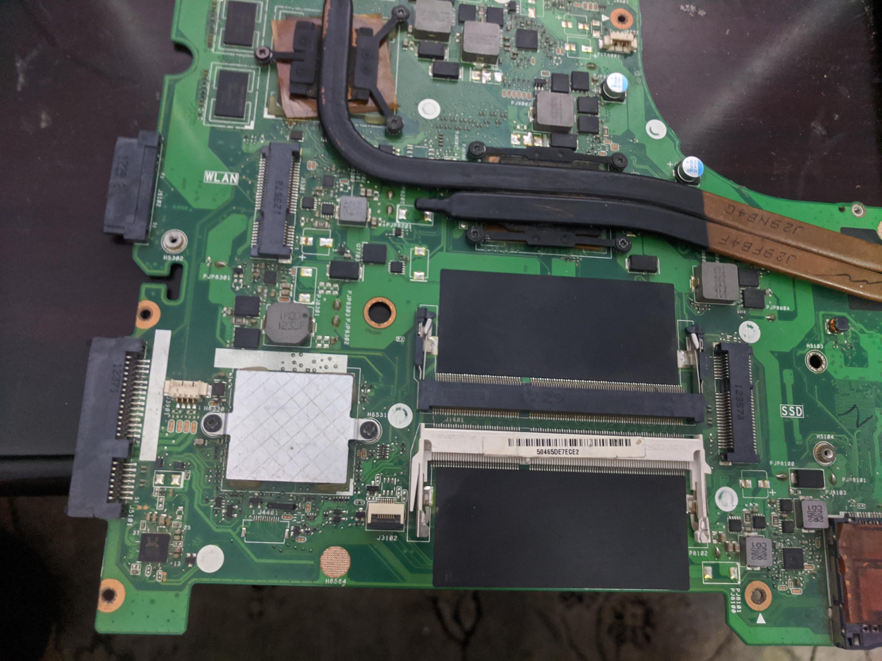

    Hi guys
    i have few laptops which are dead oldest one is 4 years since death and recent one is 1 year all of them died suddenly.
    (edit) They just died no charging no light no power on just dead
    i do mobile repairs and replace visually broken parts so i have no great knowledge on how to check which part is dead in my laptop motherboard
    i'll upload schematic and laptop board picture and please help me fix.
    I've been trying to fix them for past 2 months but no luck.
    Laptop 1 year : Sony Vaio VPCEG3AEN
    Motherboard model : MBX-250
    Laptop 4 years : Asus K56cm
    Motherboard model : K56CM
    Schematic for sony mbx-250
    Schematic for asus k56cm

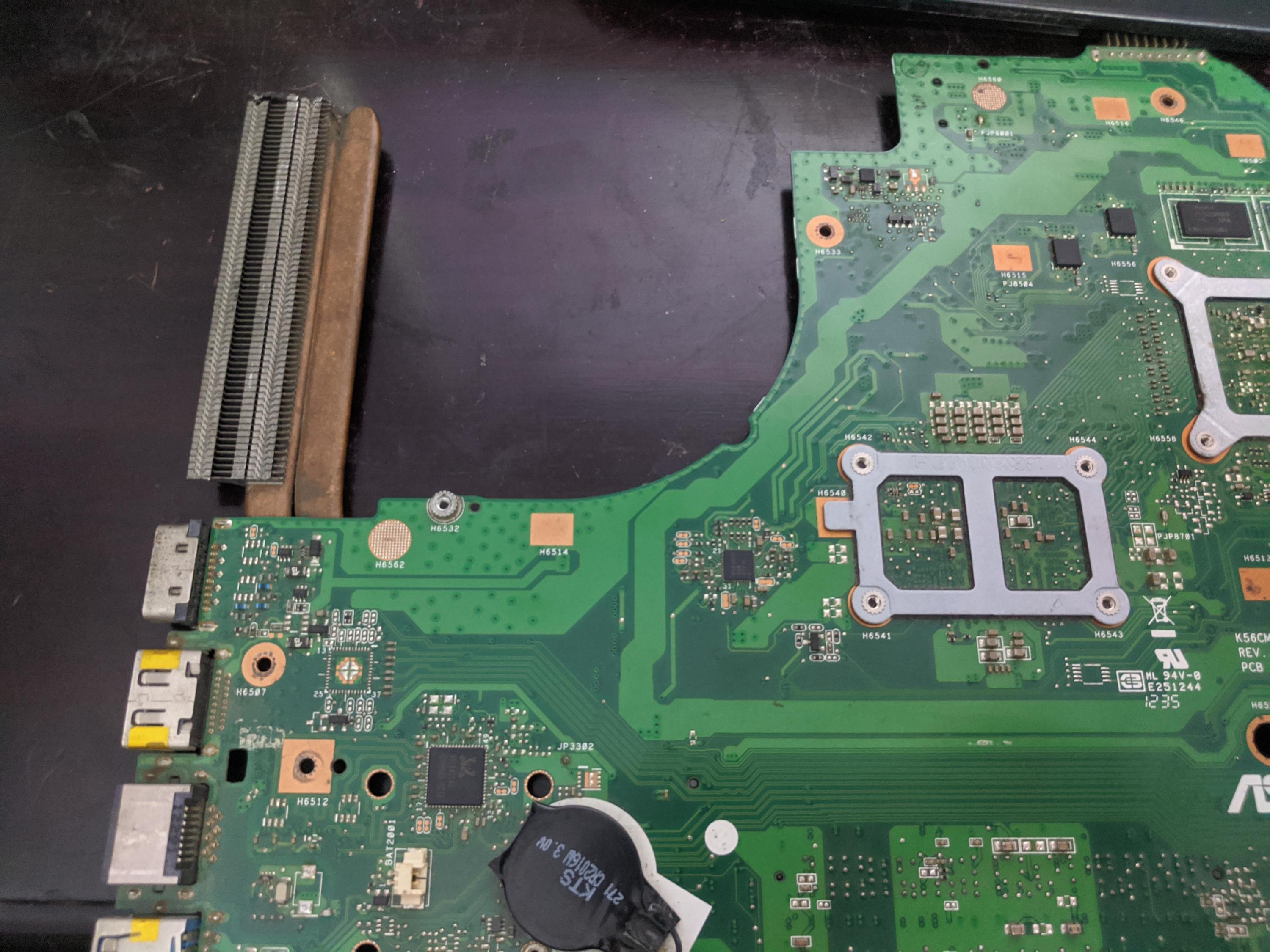

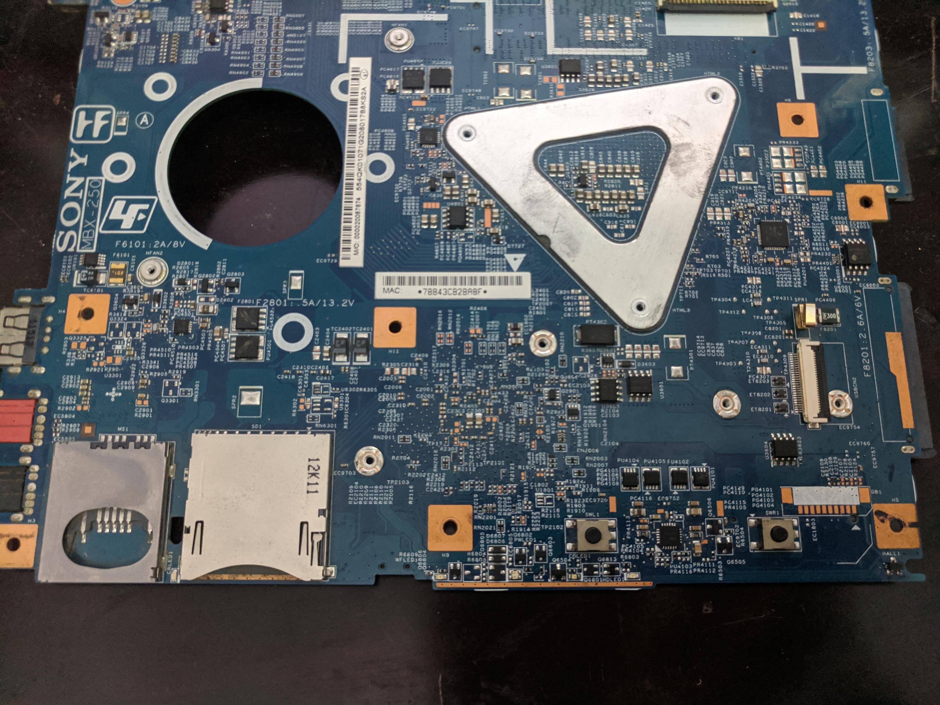

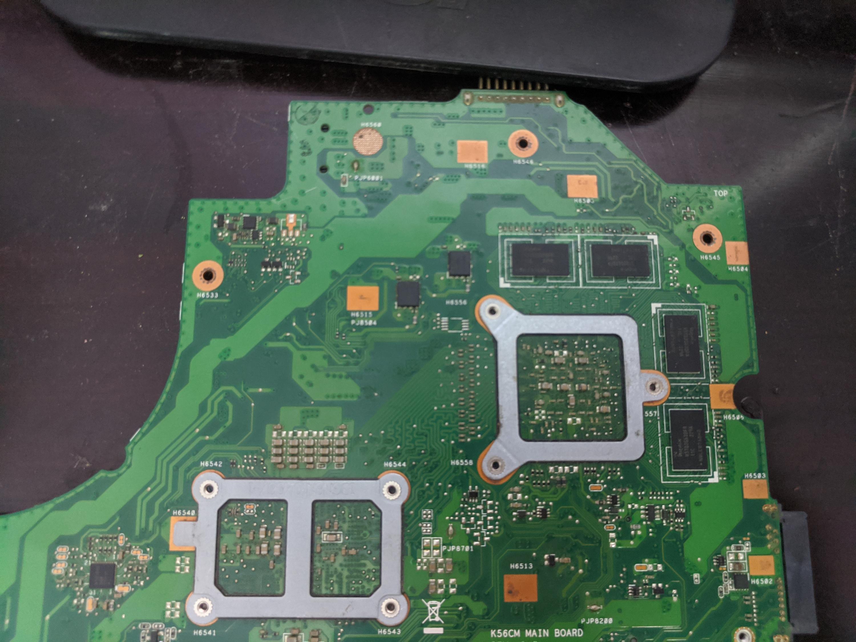

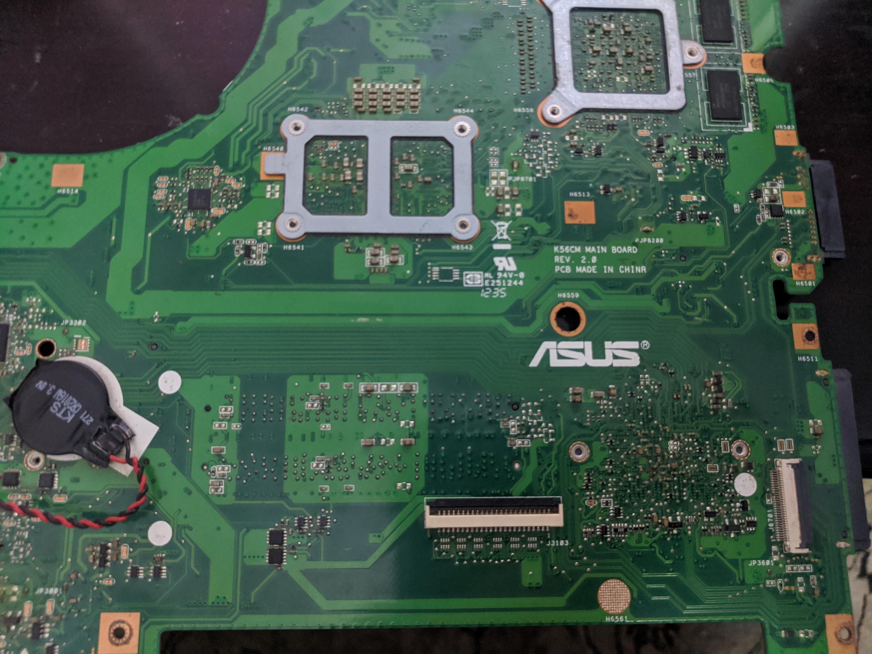

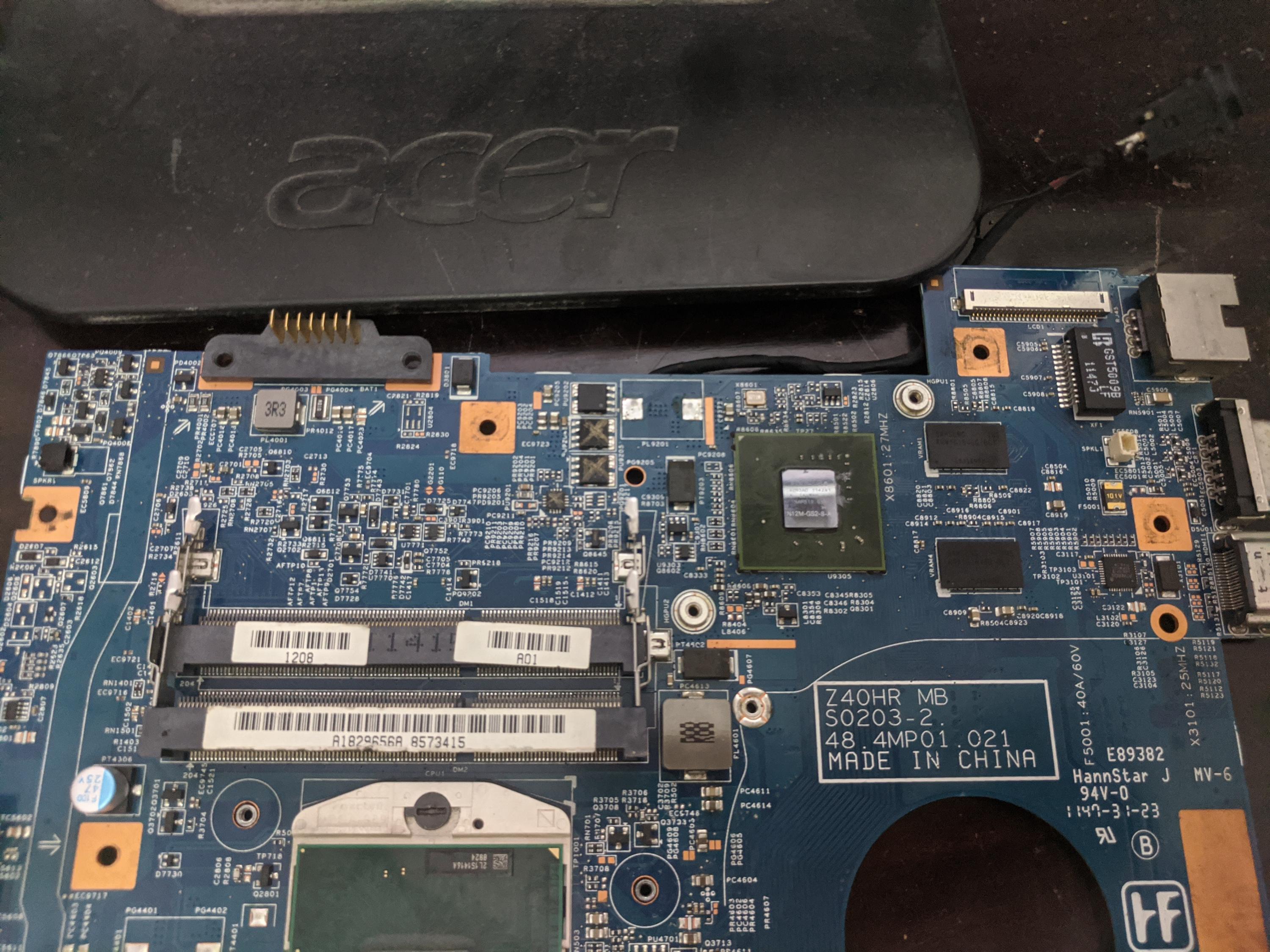

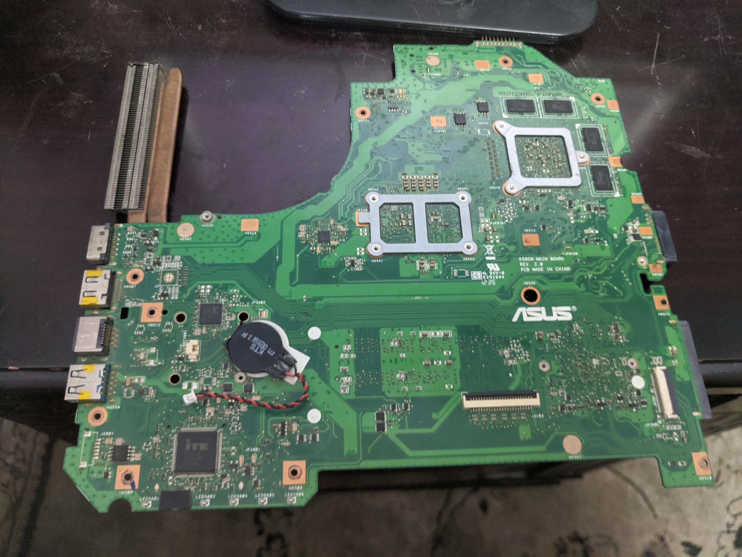

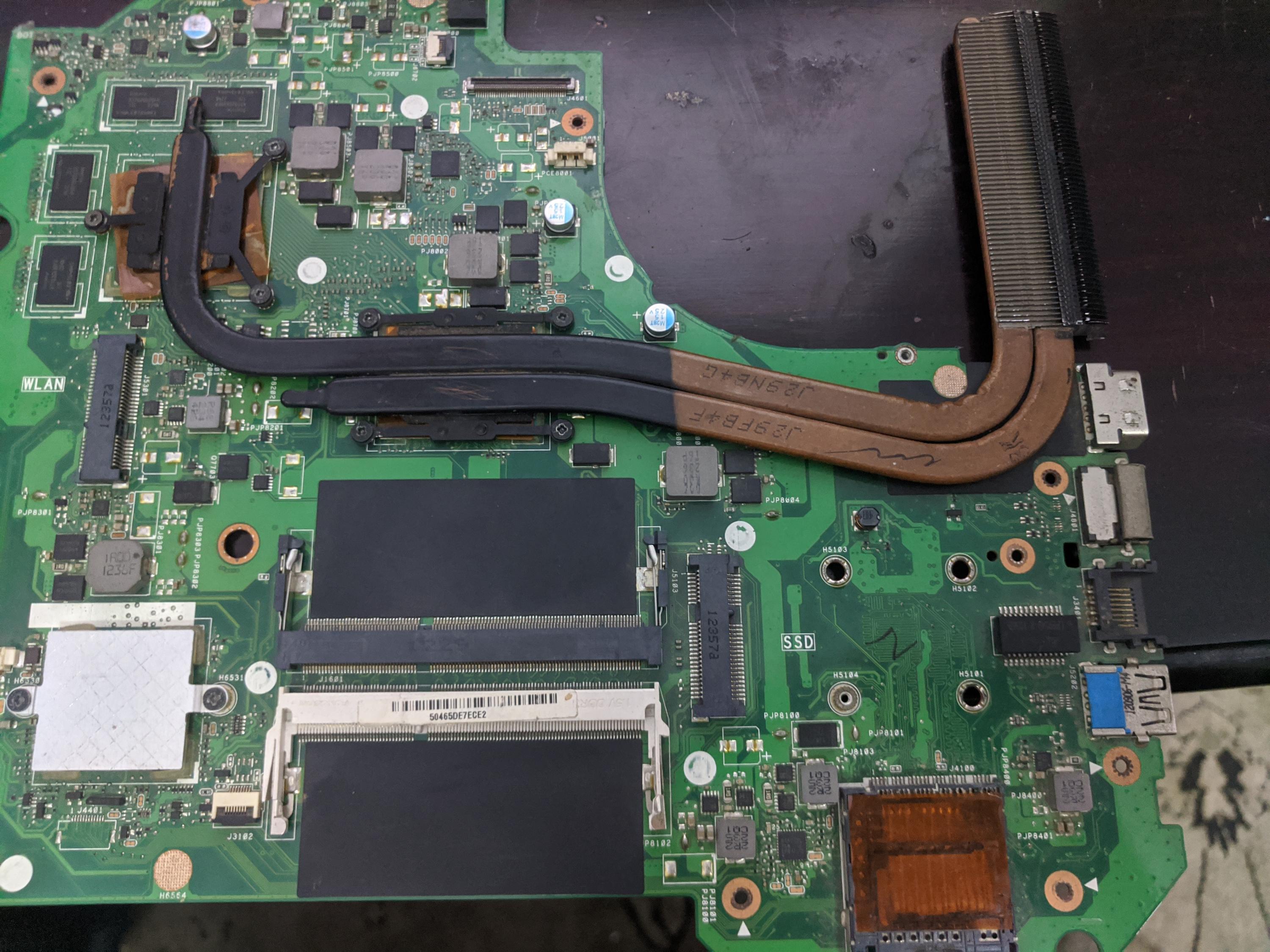

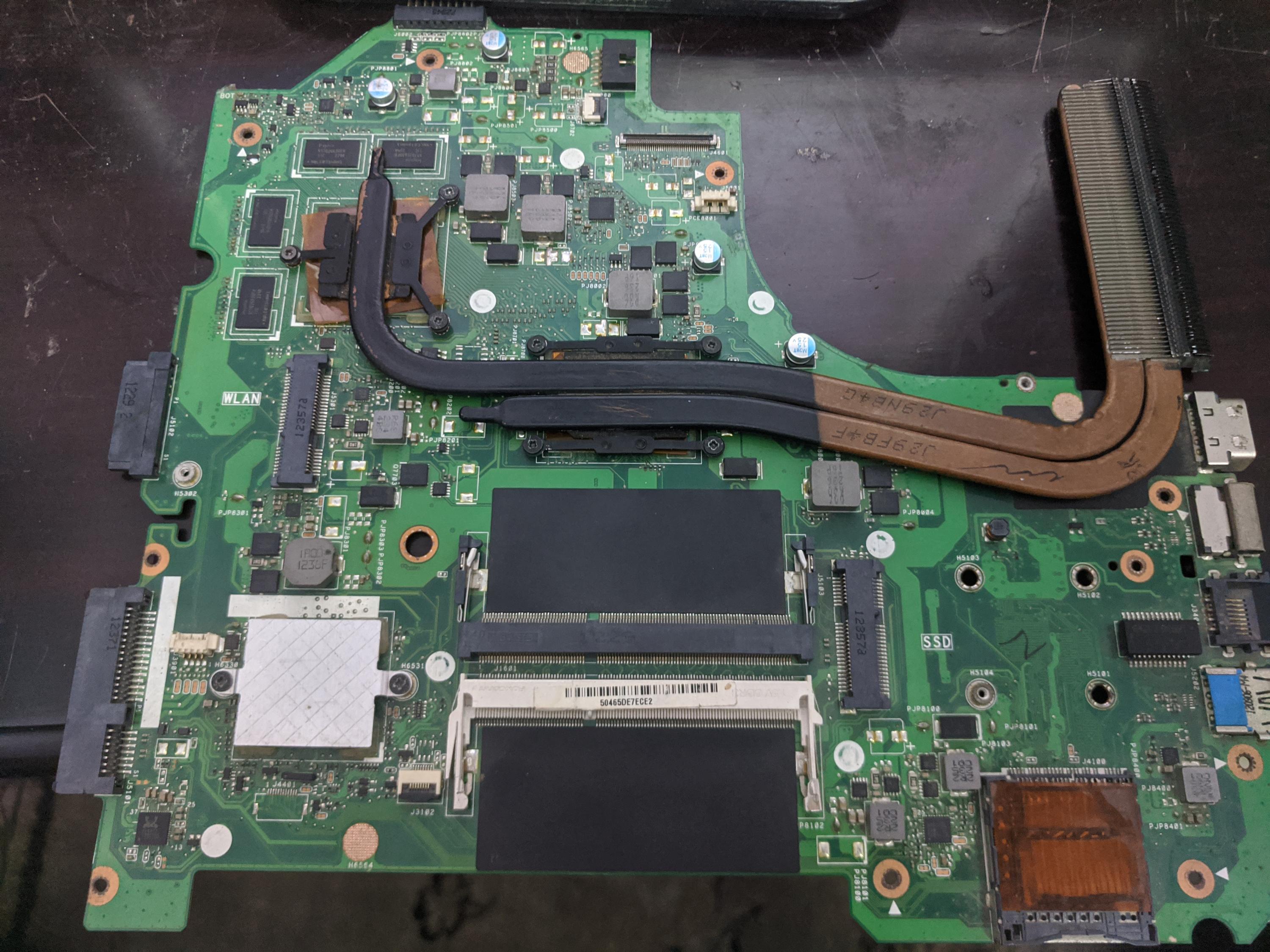

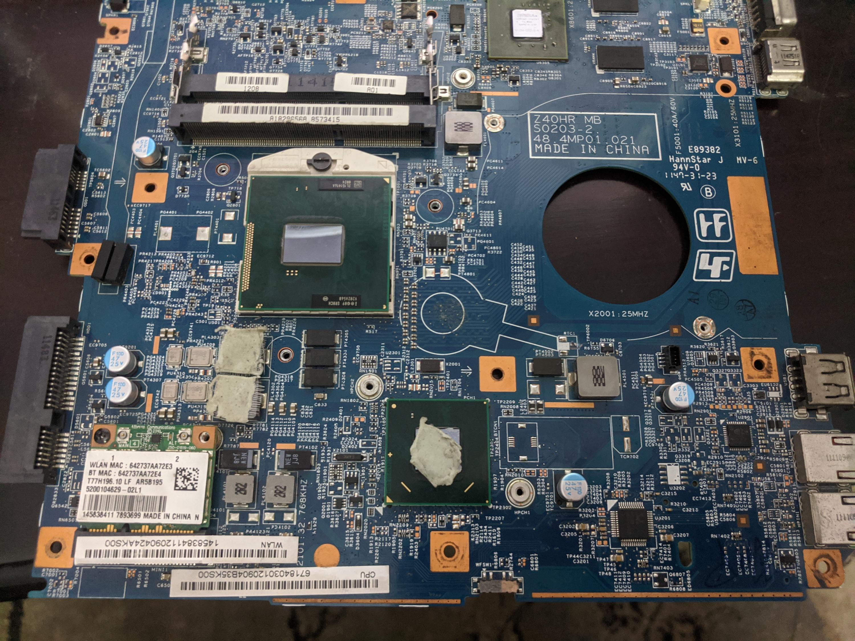

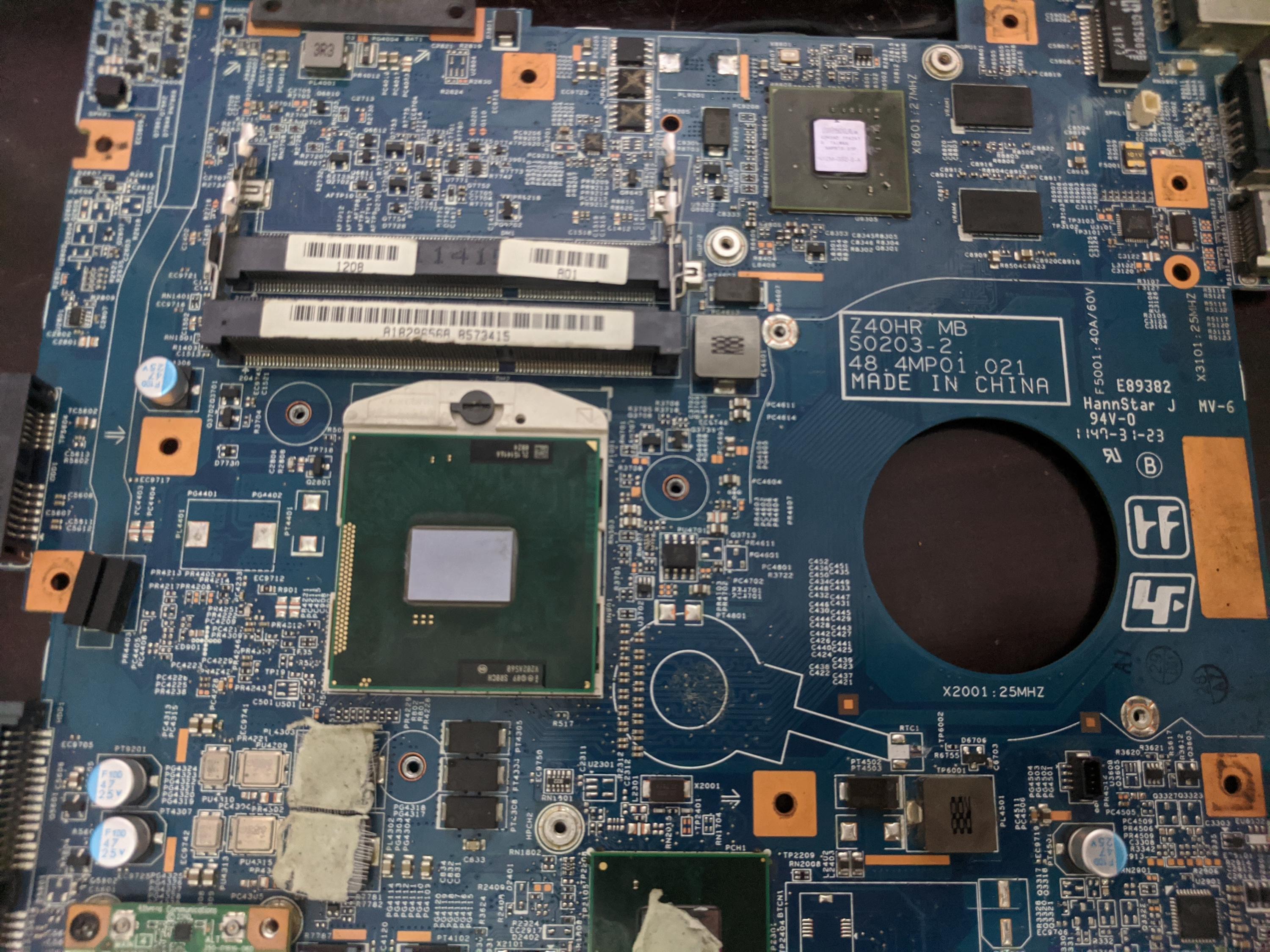

    here are some pictures of the boards them self
    Blue one is sony and Green one is Asus
    This is asus
    now the sony now
    Thanks alot for reading would really appreciate any help

          • 20855
          Re: Desperately want to fix my dead for 4 year laptops please help
          You said you`ve been trying to repair them for the past 2 months,so list what you`ve tried. Have you checked both chargers,are you using a bench supply.Have you checked both power jacks, inspected both boards thoroughly with a magnifier or microscope for burnt/corroded parts. Does either board have power, have you tested the DC-IN mosfets , tried flashing the bios, do the LED`s light up or flash,are any parts heating up as soon as you connect power, tried different RAM, CPU`s ,Checked CMOS battery voltage ???.
          • MobileXT
            • Oct 2012
            • 196
            Originally posted by thermometer
            they just stopped working no charging no light no power etc just dead
            If you don't have a charging light then, you have a missing 3.3v power rail.
