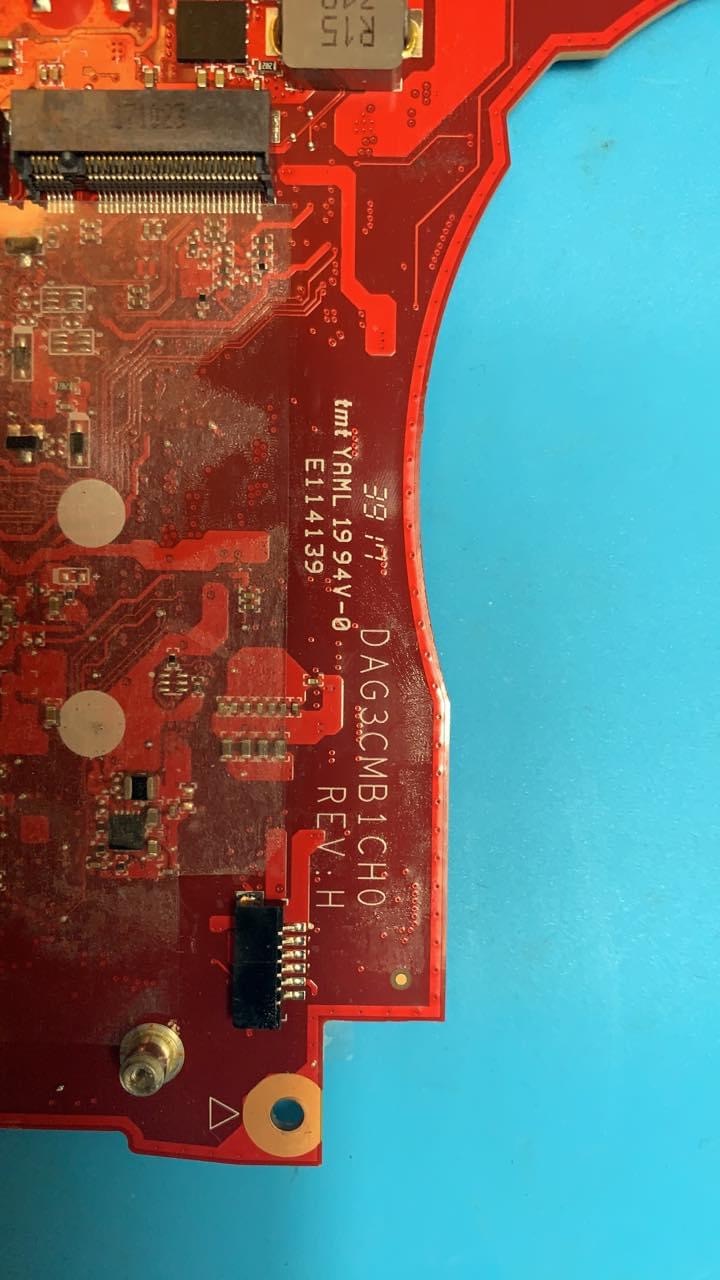

    HP Omen 17 - DAG3CMB1CH0 - 19.5v; 0amps
    So I’ve been looking at this motherboard for a few days now. It’s an HP Omen 17” and the motherboard number is DAG3CMB1CH0. There are no schematics for this. I have it hooked up to my power supply, 19.5V, but isn’t drawing any amps. Im completely new to working on these gaming laptops. Does anyone have any idea or direction on what could be the problem?
    It appears that power isn’t getting past the first two mosfets (with the exception of a current sensor near ssd which reads 18.5V, and a Capacitor that reads 6.0V) and everything looks shorted to ground, but i can’t figure out which component needs to be replaced.
    Thank you all for your time and consideration!

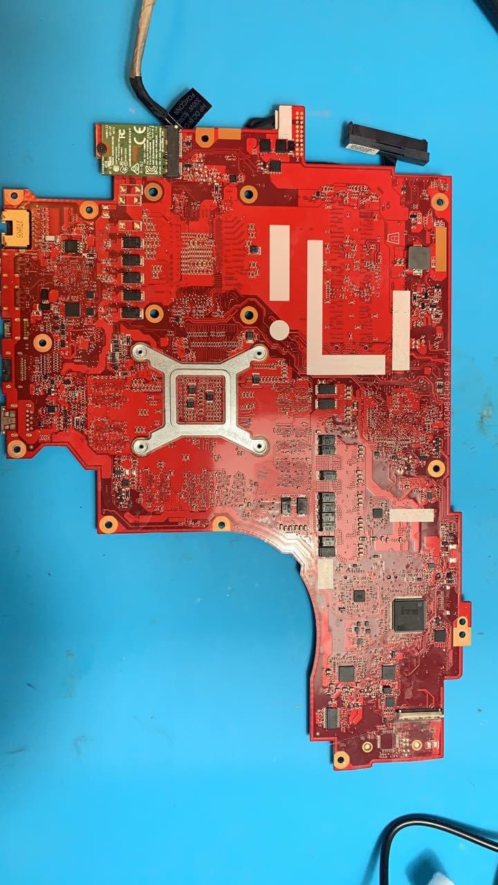

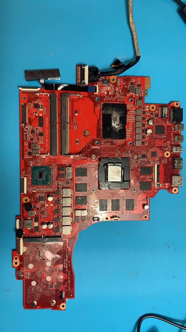

    Re: HP Omen 17 - DAG3CMB1CH0 - 19.5v; 0amps
    Attaching pictures of the motherboard

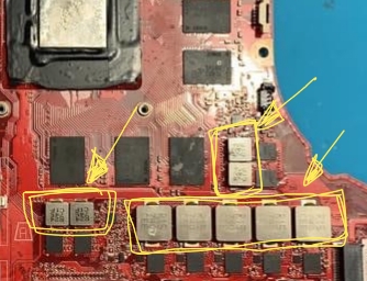

                      What you should do now is to upload a pic of the gpu including all sorrunding mosfets. To let you know what to do next.
                      • Weelcup
                        TopTech
                        • Oct 2017
                        • 307
                        Sorry i forgot about the photos in you very first post above.
                        I have marked those rails. You can take them off the board by desoldering one side of each of them off the board. Each one of these rails is feeded by a mosfet.
                        So when you remove, for example the first rail then check if the 19v short is gone if not then desolder another rail.
                        Each rail is like a gray cube with two sided soldered to board. So basically by desoldering one of its sides you are cutting one line from the mosfet that feeding that rail and the gpu.
                        Remeber, check the 19v short if gone after you remove each of the rails. Once the 19v is no shorted then you can be sure that the related mosfet is shorted.
                          That worked! I found the defective MOSFET. Now the next challenge is finding a replacement ��

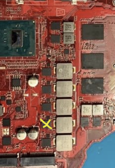

                              • Dakay
                                • Apr 2020
                                • 15
                                Here I've marked the defective MOSFET

                                  @dakay, nothing is visible on your pic. I mean what is printed on that mosfet??
                                  • Weelcup
                                    TopTech
                                    • Oct 2017
                                    • 307
                                    Good.
                                    Now can you share the number written on that mosfet?
                                    From my experience it is very likely AON6936. Which is written as E6936 on the mosfet.
                                    Kindely check it and confirm the number so we can tell possible replacement...

                                      AOE6930 is the MOSFET number. And I just found that out lol. Tried to get the MOSFET off and it took so long that a nearby capacitor blew. My hot air station is pants, so I just bought the Quick 861DW. Hopefully this will give me the heat I need.
