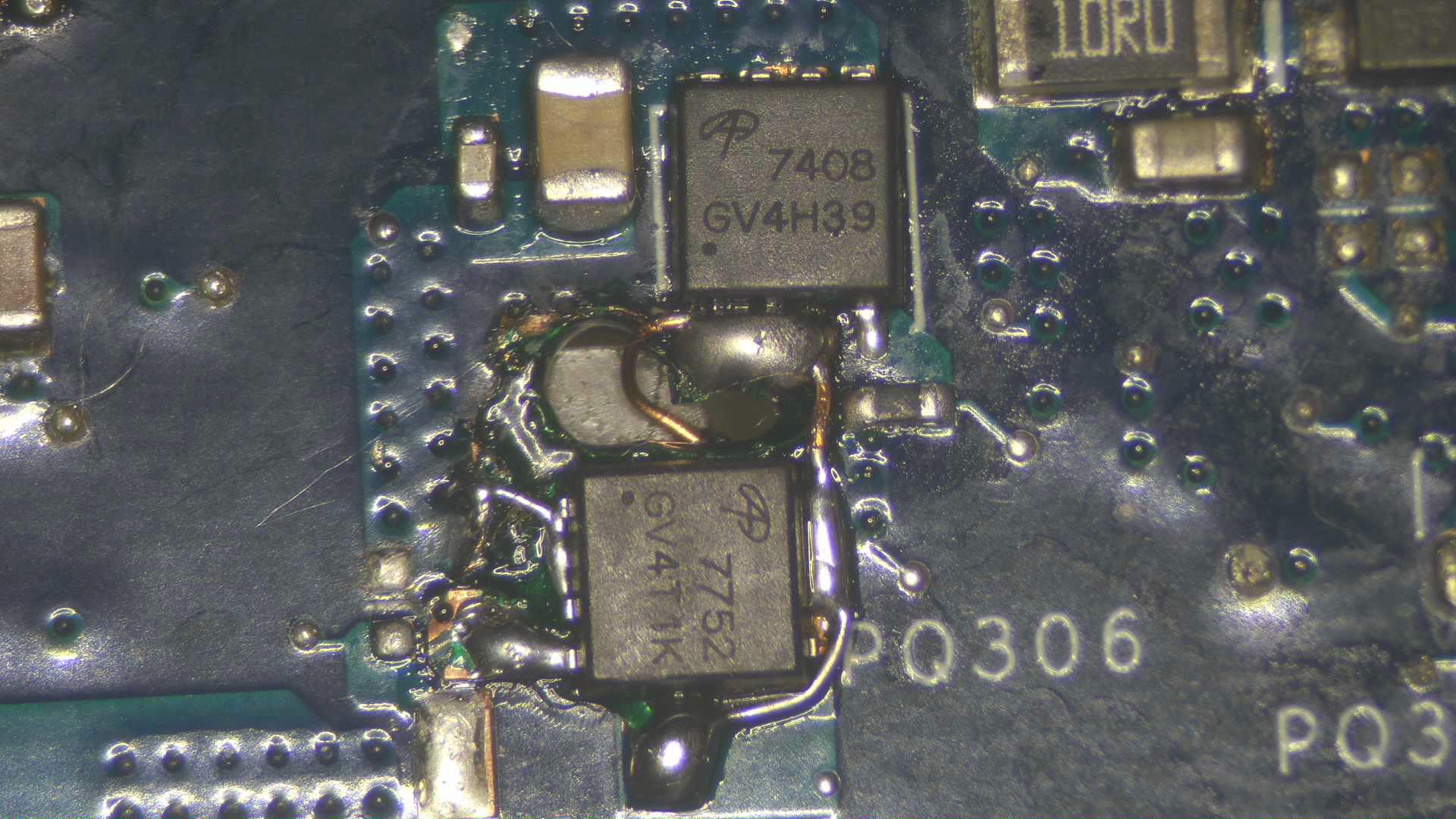

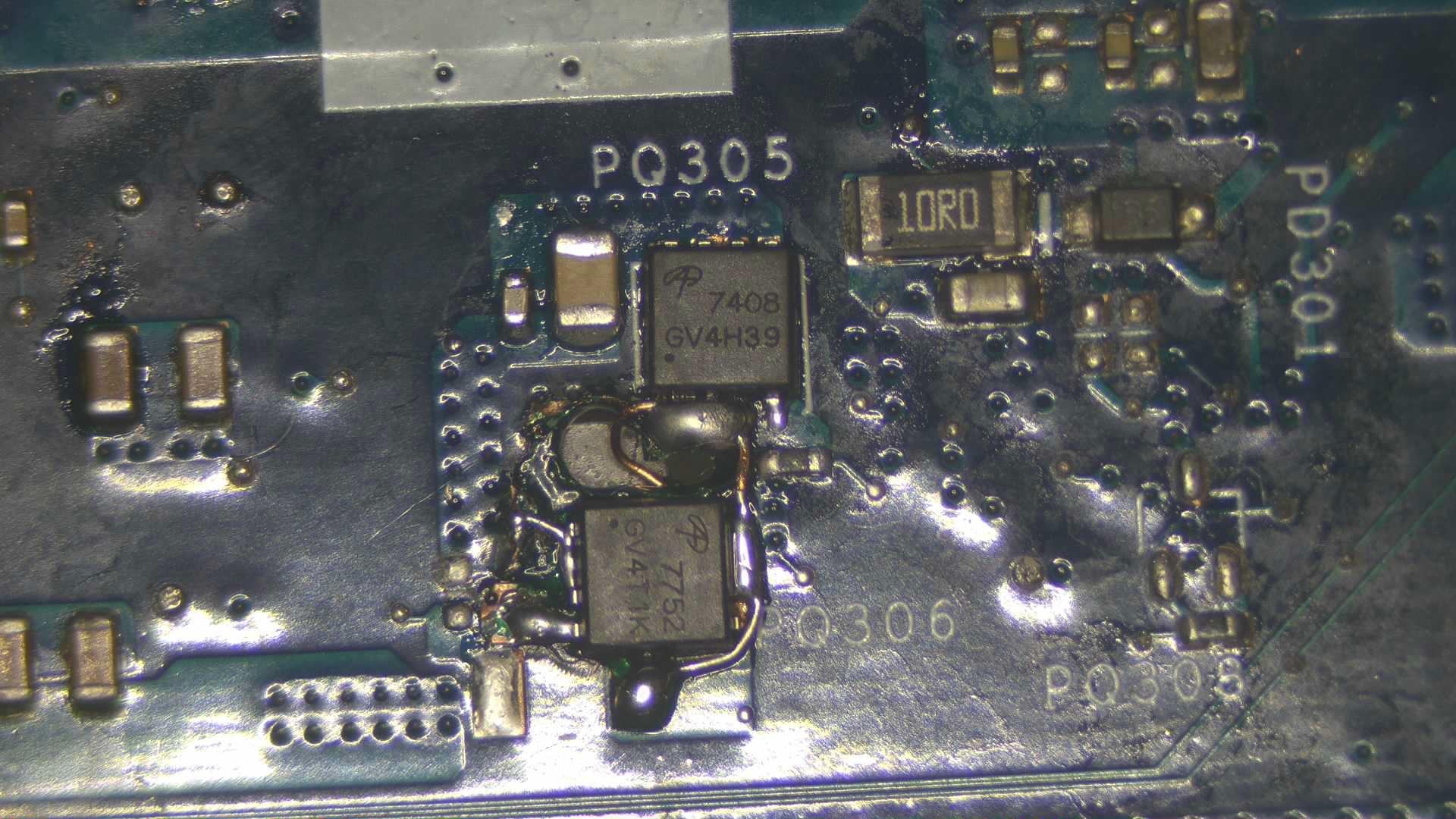

              12v mosfet burn and solution with drill pcb
