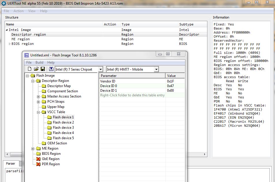

            edit: from googling 14z 5423 bios, i found an 8mb bios, while the one that i have is like 2mb. if i look for 02104168 hex inside dump file, i have vbios inside it.... while if i search in my dump, i havent....
              • 21889
              Re: dell inspiron 14z 5324 vga amd problem
              EDIT: try these bios,don`t know why your bios is only 2MB
              https://www.badcaps.net/forum/showthread.php?t=49483
              https://www.badcaps.net/forum/showthread.php?t=70172
              The supported bios chips are in the VSCC table, use UEFITool or Flash Image Tool to find the chip ID`s .
                ok the 2mb bios i saved with universal bios was bad, but inside after a full dump with programmer bios was ok. so i think that problem is bga that has some problem. strange it install driver and all but works bad, and ofcourse chip was new revision datacode 2016.
