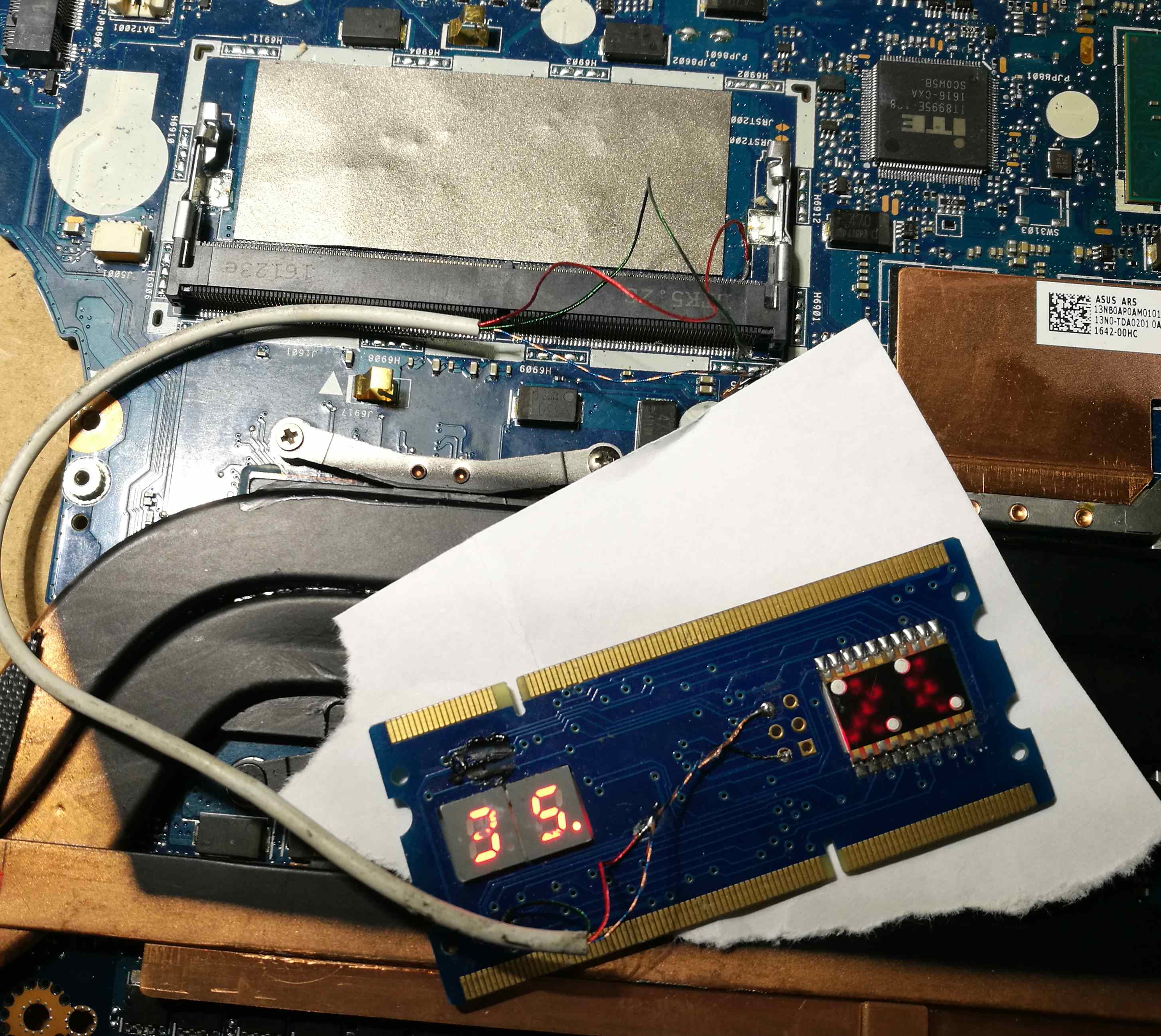

    I sold this notebook (asus gl502vt gtx970) on ebay but the buyer sent it back saying it didn't turn on.
    As soon as I opened the case, I realized that the motherboard had been changed. Be careful if you sell on ebay. The card obviously did not turn on, after several tests I have
    found that the pch was damaged (+ 3VUSUS_PCH and + 1_0VSUS_VCCPRIM in short). I replaced the pch with one taken from another card and the card now turns on but remains stuck with the caps_lock and power led on.
    to the power led. I have tried some bios and I have changed the pch with a new one but the situation has remained the same.
    I connected a post card for asus notebook and it remains stuck on the value 35. On google I read that this code concerns the cpu but I'm not very sure.
    0x35 CPU post-memory initialization. Boot Strap Processor (BSP) selection
