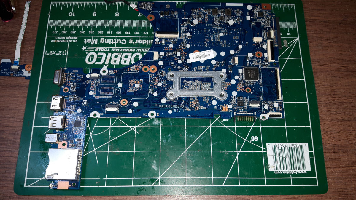

    Hello, laptop HP Probook 450 G4, board DA0X83MB6H0, I5, dead.
    Board

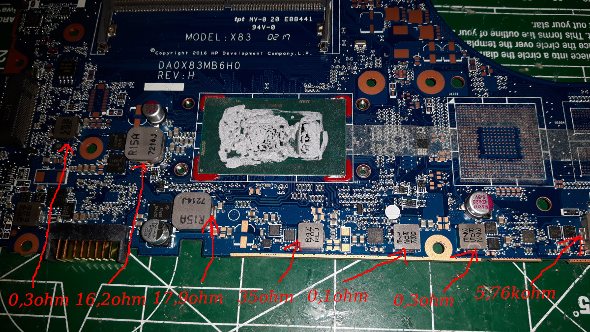

    Measure bottom side
    Measurement to the ground.
    Question : dead processor i5 ?
    If plug power converters inductors 1R0 and 3R3 (0,1ohm and 0,3ohm) very hot after reset battery cmos.
    Re: HP Probook 450 G4 dead.
    Inject 1V on any of the inductors with 0.1 ohm or 0.3 ohm to ground and check if PCH (small die on CPU package) heats up.
      Meansure socket battery cmos - 8kohm, ic degradation. I5-7200U sr342, is there any place where you can buy sr342 at a profitable price?

        I made a measurement in the battery socket (sorry y english, i still learning)

            Replace it baby. No other option.
              Working on a HP 470 G4 with the same board (DA0X83MB6H0). A quick run around the coils showed 100 ohm to deck on +3VPCU. Anything that low is usually cause for alarm but I went through the basics.
              RTC clock was present, PWR_BTN_OUT# goes low ok to PCH from EC (when power button is pressed), other pre-requisites all check out, including supplies to the PCH. No change to SLP_S5#_3R or SLP_S4#_3R, PCH_SLP_SUS# also no change. No activity other than random pulses on the 24Mhz clock for the PCH, but not sure if it comes up after S5.
              Deemed a dead PCH as nothing else left. Unfortunate as the board was in excellent condition and discrete graphics as well.
