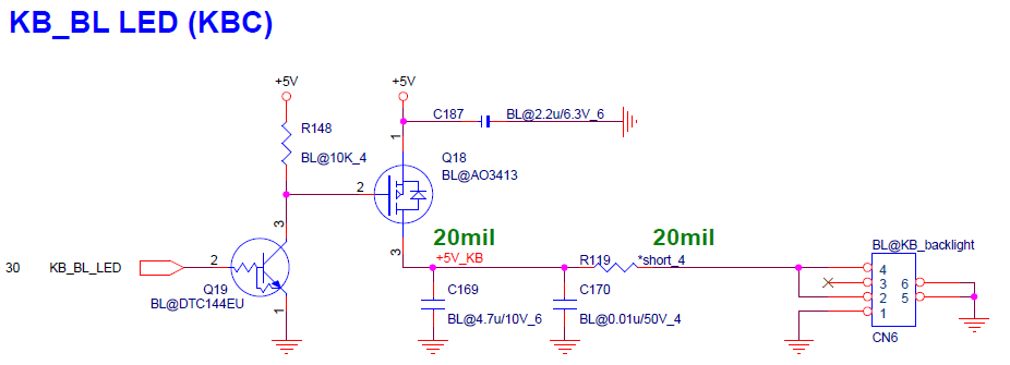

    Hello.
    Have this Acer f5-573G that have random poweroff and no KB BKL as custommer said
    I cannot make it to replicate thisshutdown but custommer said that it make when hes typing on KB. BL WORKS on power supply.
    I measure that KBC is not releasing KBC_BL_ON signal. I try to power it on by keayboard Fn+F9 but notwork. Custommer said that BL starts to blink and after time it completely shuts off
    KBC is IT8987E/CX
    do u thing that KBC have some internal short?
    It is programmable KBC but i dont have programmer for it

    Now im littlebitconfused
    Imanaged to get KB_BL_ON and have 5V on KB_BL connector, but BL not work
    when i inject 5V to unconnected flex cable BL works and consumes 1W ,but when i connect it to connector and inject 5V BL notwork and consumes 0,2W

    • mcplslg123
      • Jun 2015
      • 7262
      • india
      Re: Acer f5-573G random poweroff and no KB BKL
      Did you cut the track on mb before applying 5v on BL line?? If so, seems like bad kbd
        KBD seems good as i have signal from it. i not cut 5V line because it is switched so it is cut from factory :-)

          here is cut from schematic
            why it draw so little current when connected to connector?
            maybe corroded contact inside connector?
