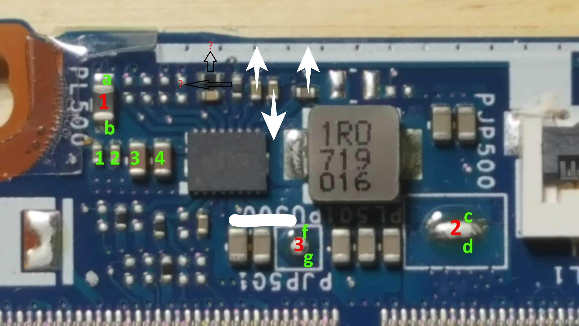

    I soldered a new dual mosfet , changed the burnt coil and replace the inductor. Now at the end of PL901 there is 1.4V . all that remains is to replace the capacitor (19V to GND) with an appropriate value, which value do you recommend?
    No problem with down side. My problem with top side.
    this ? probably wrong or my dead resistor give my technician wrong value?

      Re: Dell INSPIRION 15 7567 BSOD
      Pl500 0 Ohm is correct (Pl is not measured in Ohm but in Henry).
      But what's your problem ? missing ddr4 voltage ?
      To understand this part of the circuit you must find the datasheet of the A0S70S controller and you must find the missing signals with the motherboard powered. A damaged resistance hardly changes its value is more likely to be shorted or non-conductive.

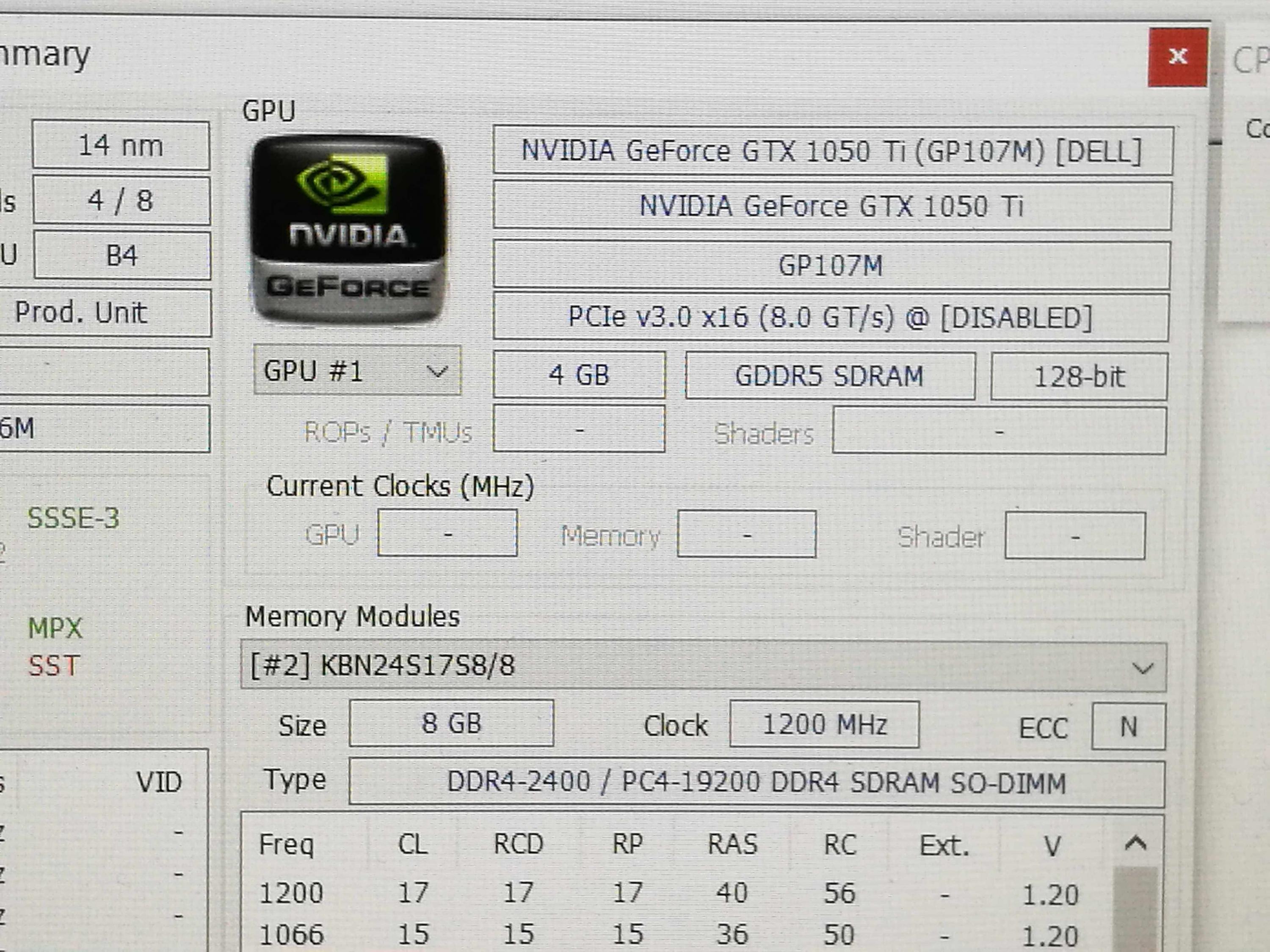

            SOLVED
            Having no information on the components, I replaced the damaged capacitor on the PQ900 -> DRAIN-> GND with
            a value of 10 mF. After installing win10 the video card and its memory are detected correctly. The ACPI BSOD message is resolved without reprogramming the bios

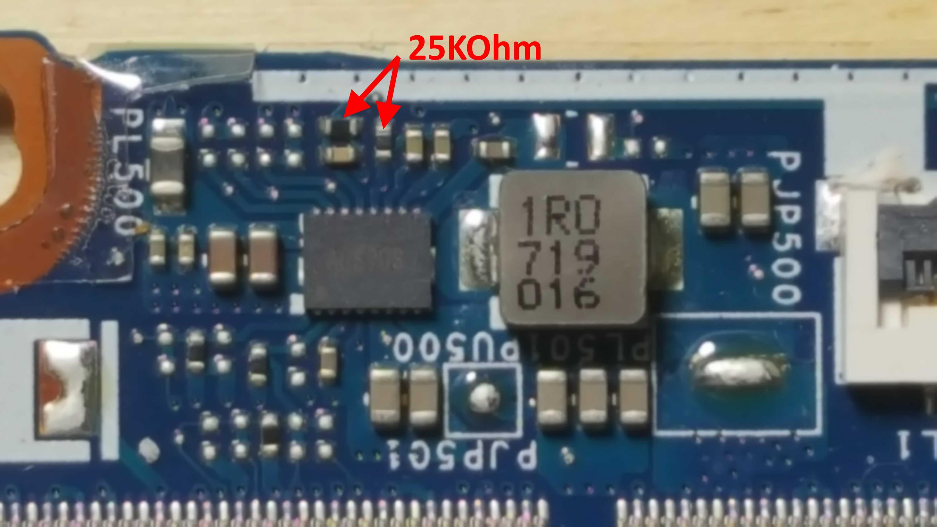

              i talked with my techician and he told me wrong resistor actually he need to this arrow resistor can you help me? And they type like 1206?
                With the components in place the measurements regards a network of components not only the component to detect
                  Replacing to resistor but we give to energy only 0.13 amp 19.7 volts. Other engineer check now for short circut. Can you give me any suggest for testing?

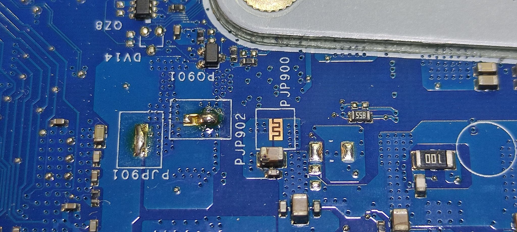

                      I had a very similar fault to this on the same motherboard. With a Windows 10 USB boot disk, you'd get to the spinning dots for a brief moment and it'd restart. It ran Ubuntu Linux though, but this was only using the Intel GPU, not the Nvidia GPU. It wasn't even detected.
                      When I took the board out, PL900 had burnt up. It's a choke, inline with +B supply that feeds the +1.35VS_VGA buck converter. Turned out one of the caps PC902/903 was shorted. It turned out to be the one on the underside of the board. So replaced that and PL900 with one off a donor board, and all working ok.
                      Obviously Windows 10 crashed because it couldn't initialise the Nvidia GPU. Ubuntu just didn't care.

                          #32
                          Attached are some photos of the damage. The fault was the capacitor underneath going short, which blew the inductor on the top side. Have a look in this area of the board to see if you have the same fault. That one hasn't come back since it was repaired.
