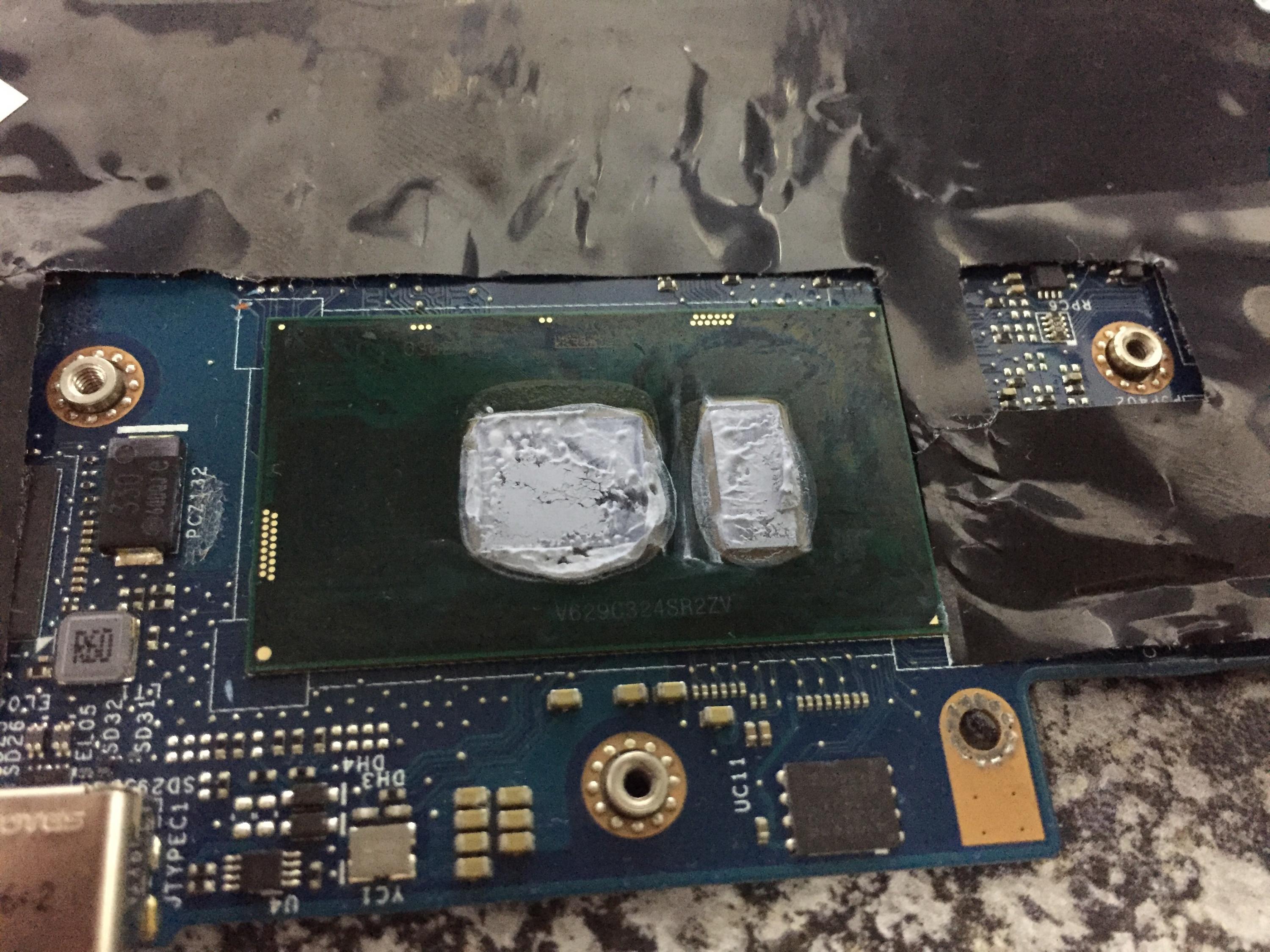

    Hello fellows
    Im having some issues with hp spectre
    LA-D402P REV 1.0
    I dont have schematic or boardview
    The cpu get extremely hot in a way that you start seeing white lines on the screen or become black and the power button flashes after that.
    I checked the heatsink, changed the thermal paste still not winning, it ge extremely hot. I tried to change settings to low power usage but still the cpu overheat
    Guys any suggestions please

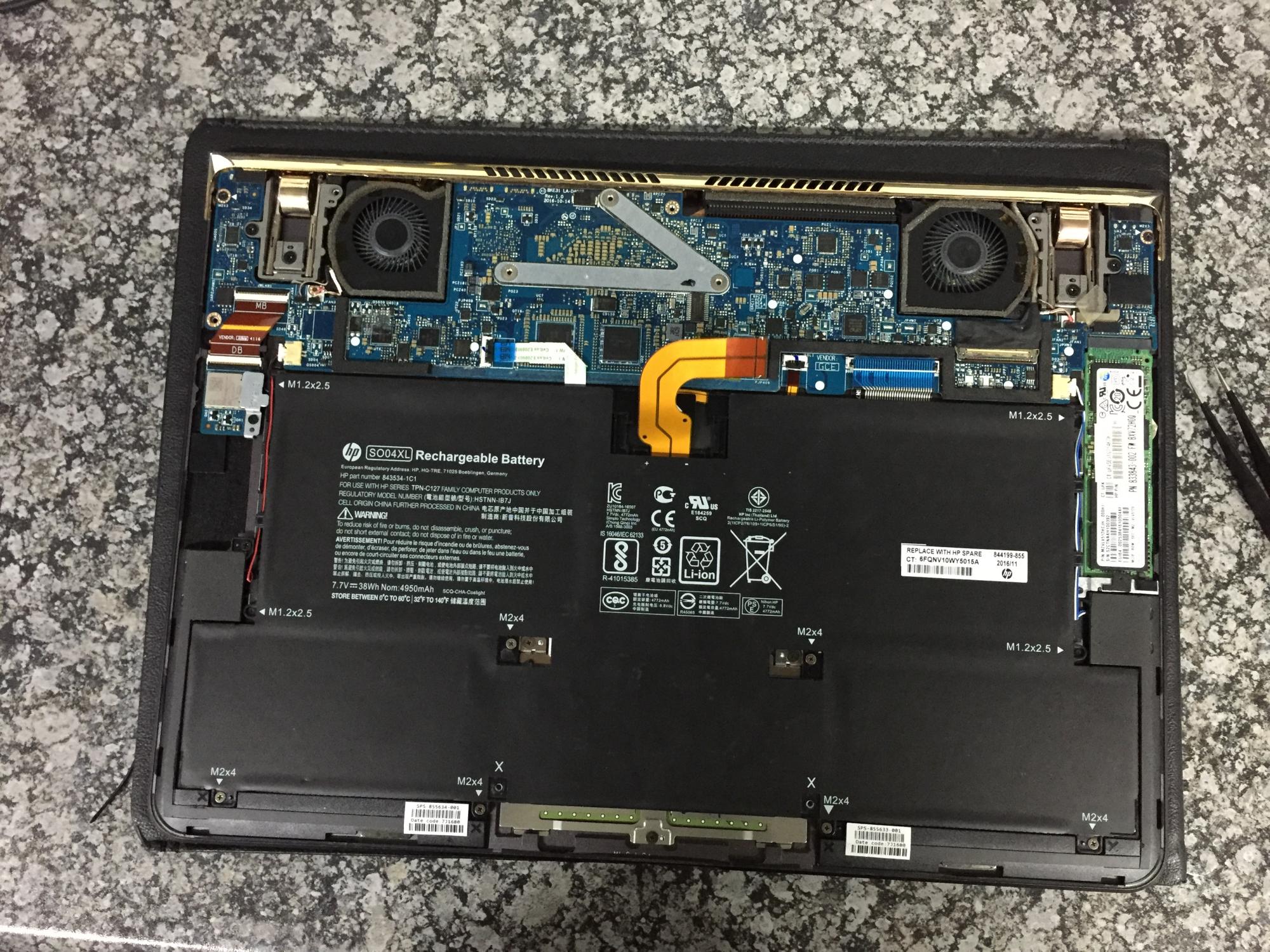

    if the air coming out of the cooler is not hot, change the heatsink...
    clean the cooler and radiator from dust?

      The cpu package looks odd around the pch. Looks like it cooked and delaminated itself.
      Also an overheating soc doesn't create artifacts on the screen it will just shut off. I bet it is just about to die. Which part of the package gets hot? The smaller die or the bigger one?

        I'm wondering if someone tried to reflow it…

          It is hot brother, it very hot

            No one has tried to reflow it

              Does it also heat up extremely just sitting in bios ?
