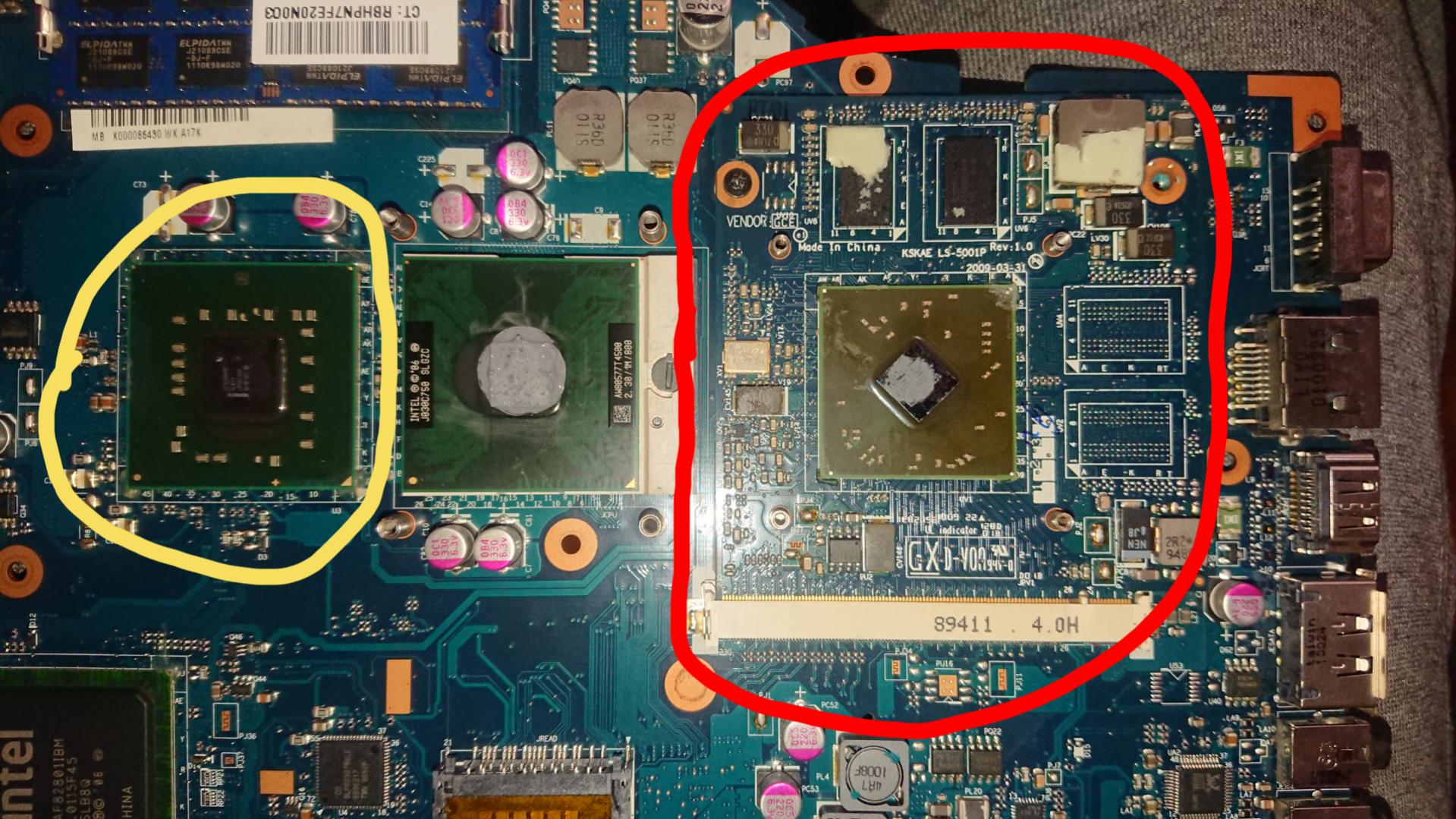

                              • 123XYZ123
                                • Feb 2017
                                • 53
                                • NY
                                Re: Toshiba satellite L500 won't post?
                                I heated up these 2. Has the yellow one anything to do with the integrated graphics? The other one I took it put of the board because it's easier so I don't damage any other things and heated it up for about 4min.
                                The yellow one about 3min maybe. Any way to heat something back to bring the integrated GPU back? Lol
                                If needed I will take a magnifying glass to take pictures of the "names"
                                EDIT: And yeah, the red one should be the dedicated GPU, it's ATI?
                                Also, could it be that it failed from overheating? Lately I have been using an external monitor besides my laptops screen, but I didn't follow the temperature. However, I have the feeling the fan was more active an it usually was.
                                • KvnTM
                                  • May 2018
                                  • 434
                                  The ATI chip is the GPU. The Intel chip (yellow) is just the PCH. Probably without integrated graphics. But cant tell since i cant read the numbers of the chips. Im actually surprised that there is also a mxm slot for another dedicated GPU.
                                  Can you clean the GPU and take a good closeup of it? ATI had some bad chips back then which are not fixable and there are no replacements for it.
                                  It'll work a few days after heating the chip but it will fail again. 100%.

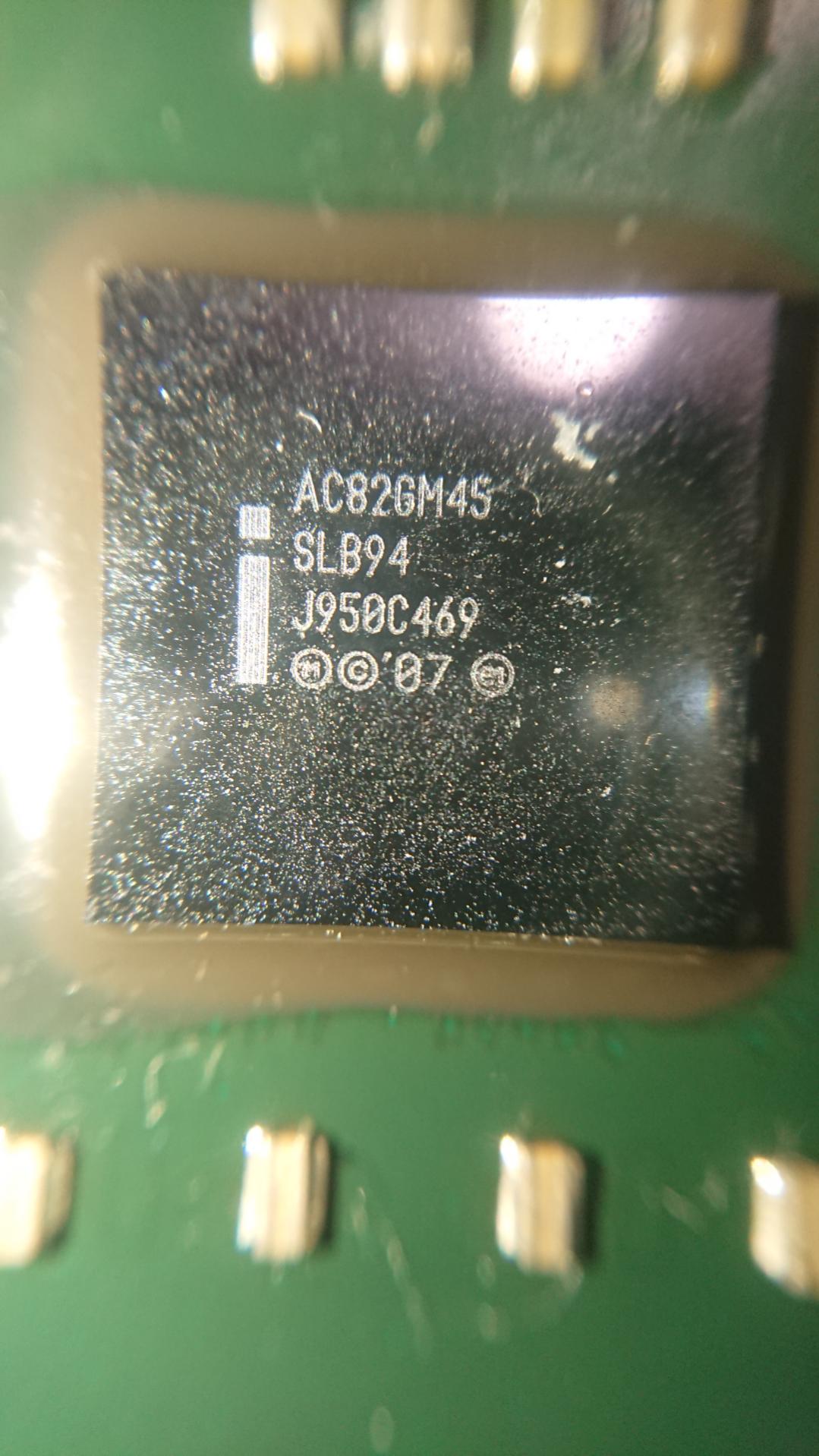

                                    • 123XYZ123
                                      • Feb 2017
                                      • 53
                                      • NY
                                      Here they are. Well, I had this laptop for 10 years, first owner hehe
                                      I'm quite impressed it survived till now, it was used daily, the HDD is also still working (for how long more it's questionable but I have SSD as first drive now, HDD not used that often)
                                        Ah sorry, I thought you want the names. I will clean and take few pictures of the whole GPU tomorrow.
