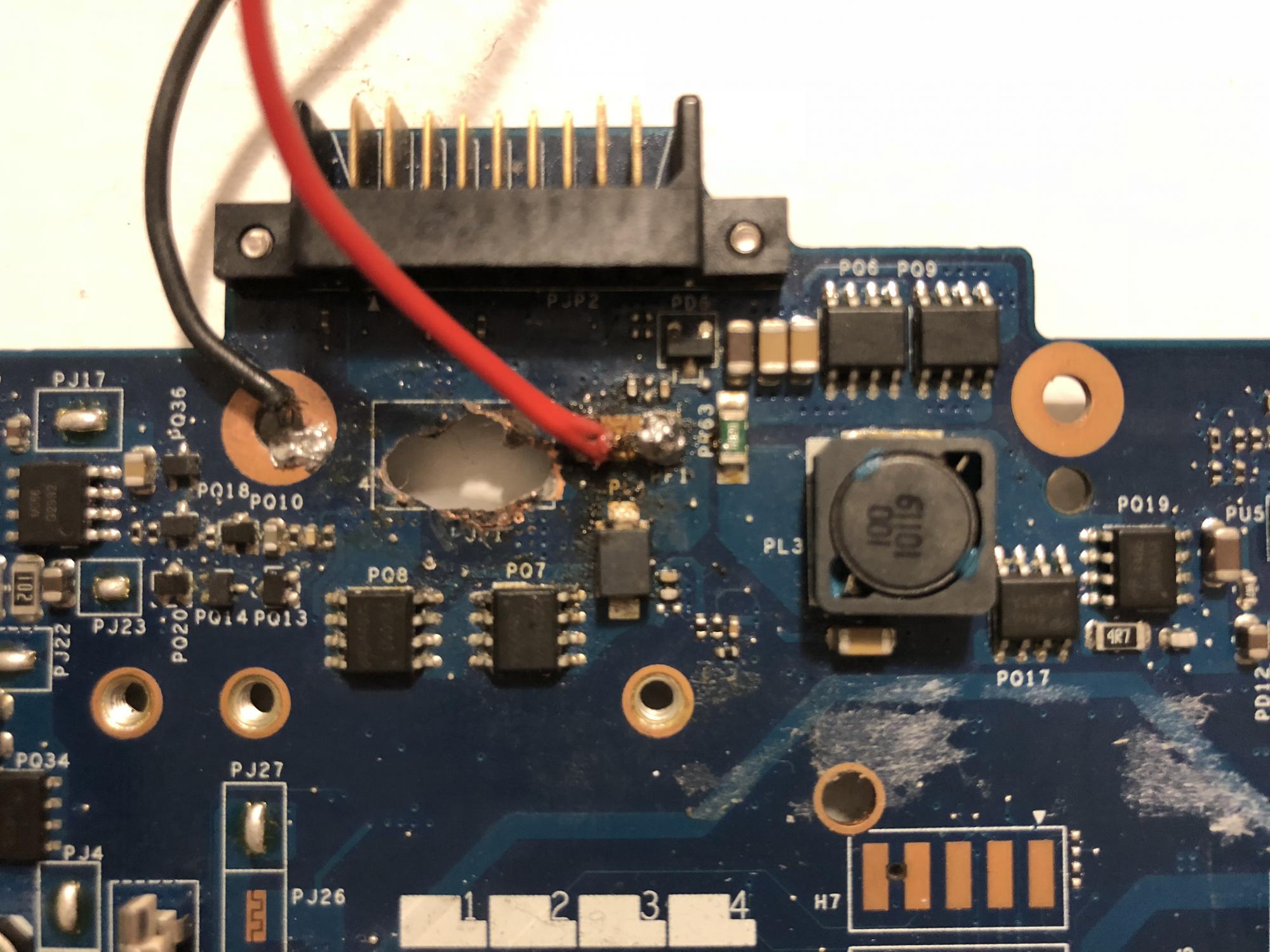

    Hello Veterans
    need help on a Toshiba MB La-6062p rev2.0
    History of the motherboard 19V Short to ground PJP1 power connector burn completely clean up the area now the shot is gone I have 3.3V ALWP + 5V ALWP
    The MB is not powering on.
    SIO
    ECRST 3.3V
    RSMRST 2.68 -0V #
    ACIN 2.5V
    LIDSW 3.3V
    VCC 3.3V
    AVCC3.3V
    SLP S3 2.05 drops to zero
    SLP S5 2.09 drops to zero
    SUSP 3.3-2.64 drops to zero
    PM PWROK 0V
    LID OUT 2.5
    SYSON 0.27 drop to zero
    PCH SUSPWRON 0V
    EC BIOS done found one from badcaps any help

    SLP voltages doesnt seems good-seems like a bad pch or bad solder joint under pch.

      Ok thanks i will reflow and see for any changes but the initial problem was this power connector burn out i have upload pic is there a way to repair it connector

        Reflow dident help any other suggestions
