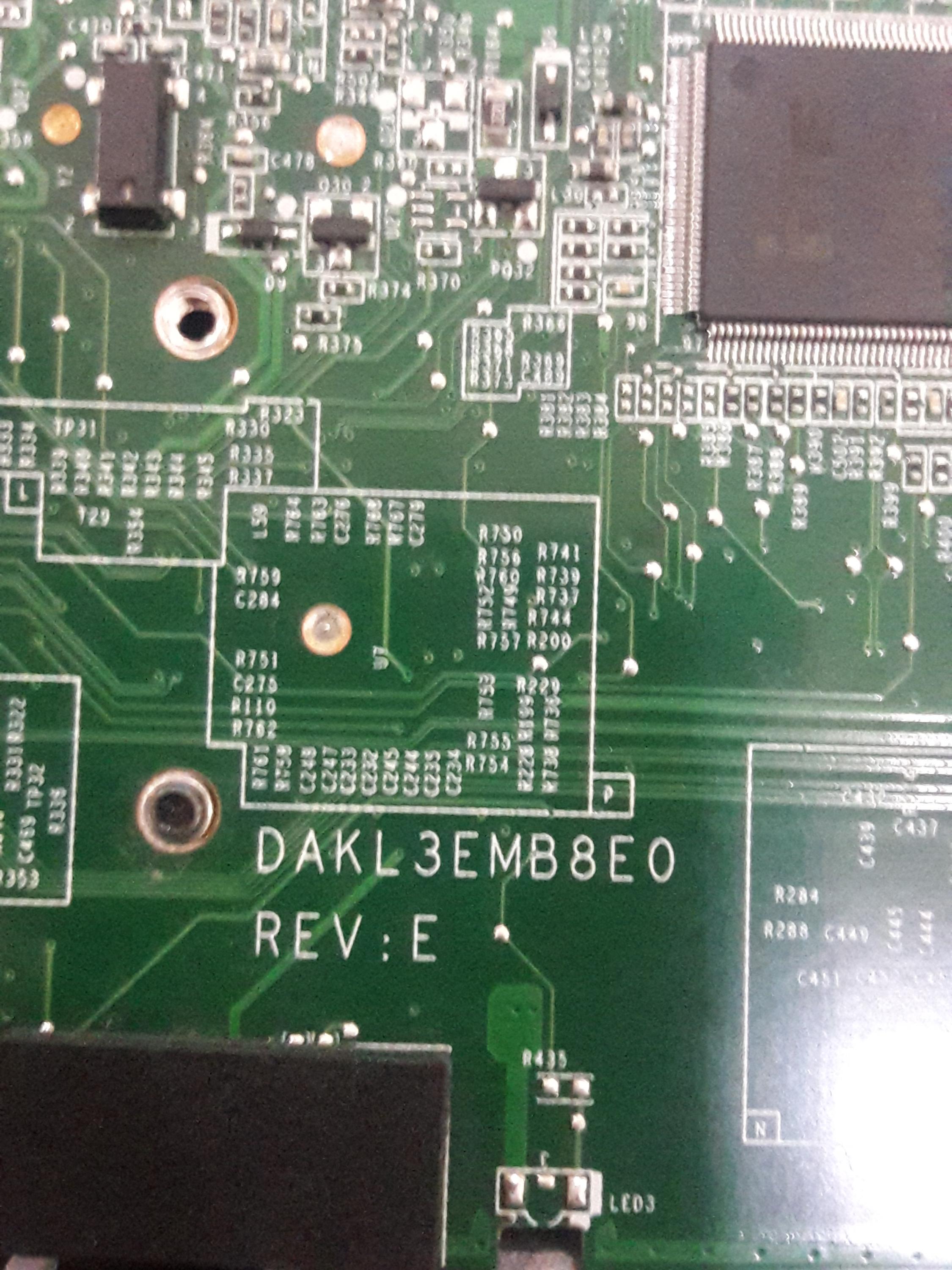

    Hello there. Does anyone know Lenova Y560p? The video card is defective.
    I want to cancel the video card and get an image from the processor.

    DAKL3AMB8E0-Is this the mb code?? Should have mentioned it while posting. If so, i can help you to convert but first you check mb code.
        DAKL3AMB8E0 is not the number.
        DAKL3EMB8E0 REV: E
        Please check the attachment.

          Try what imranromi has posted. if it doesnt work, i'll see to it.

            I don't have a bga device to remove the video card chip. I can do all the others. How can I solve this problem?

              Try this alternative way-may work ,might not work. I've attached pics so that its easier for you. You can leave the bga chip.

                  Thank you. Mark the parts to be removed with a red pen. do not understand. I do not know what to do.

                    Cant you compare your mb with the images i have posted and find out what is removed??

                      thank you. you are right. Is it necessary to write the BIOS after doing them?
                        Not necessary
