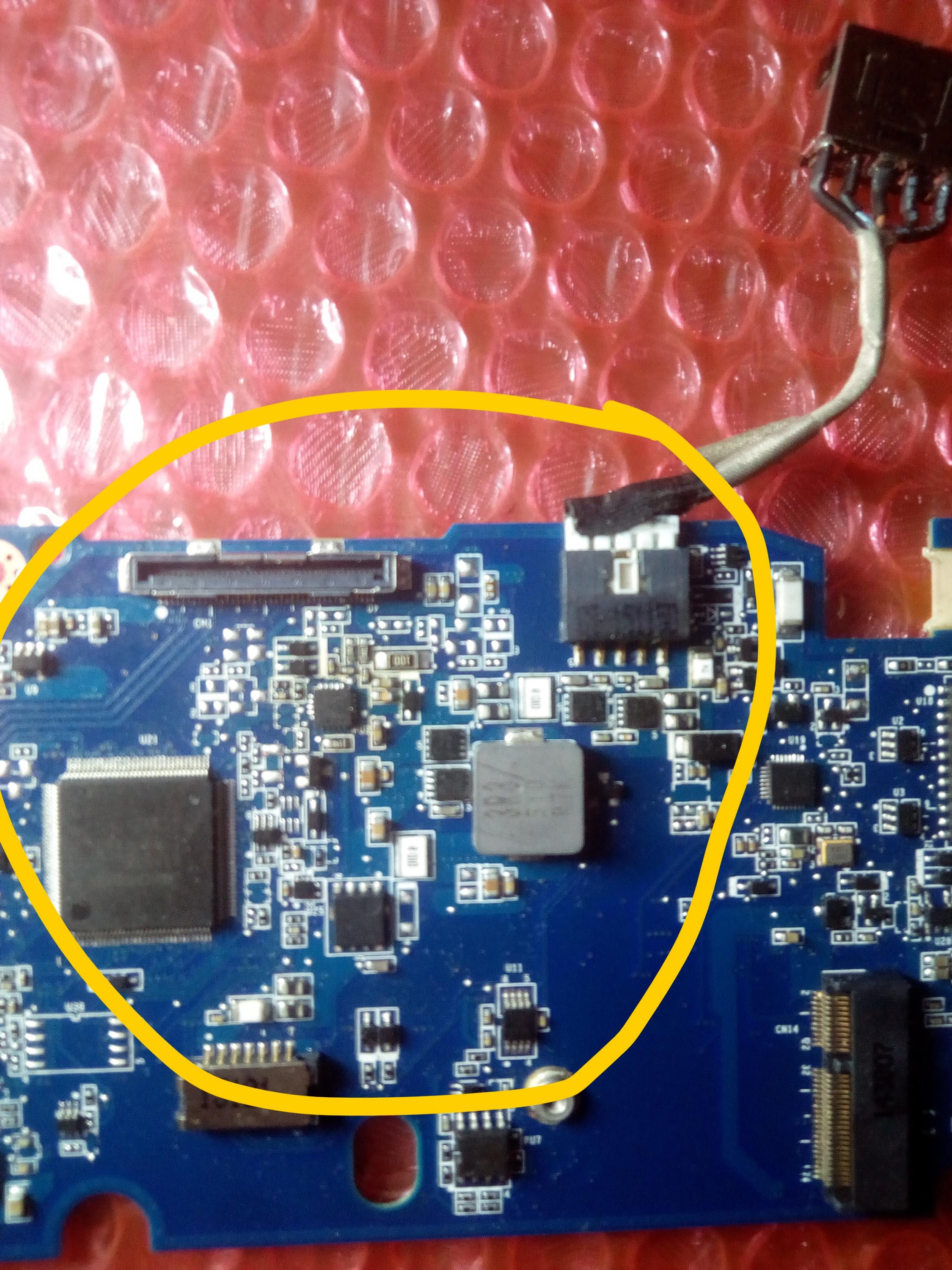

      Re: Lenovo ThinkPad 11e (DALI6JMB8E1 REV:E) not powering On
      Before that I.C started getting hot, there was a buzzing sound coming from a component close to the DCIN Jack. Check the photo attached. I think the charger was faulty too which caused it to make that sound.
      I have replaced the charging I.C (BQ715), it still made that noise until the noise stopped and the 3.3v/5v I.C started getting HOT. I've changed the Charger and also the 3.3v/5v I.C, it still gets hot.

                      Thanks for the suggestion, I found KBC to be shortened. After removing KBC, short was gone. Sorry for not replying on time.
