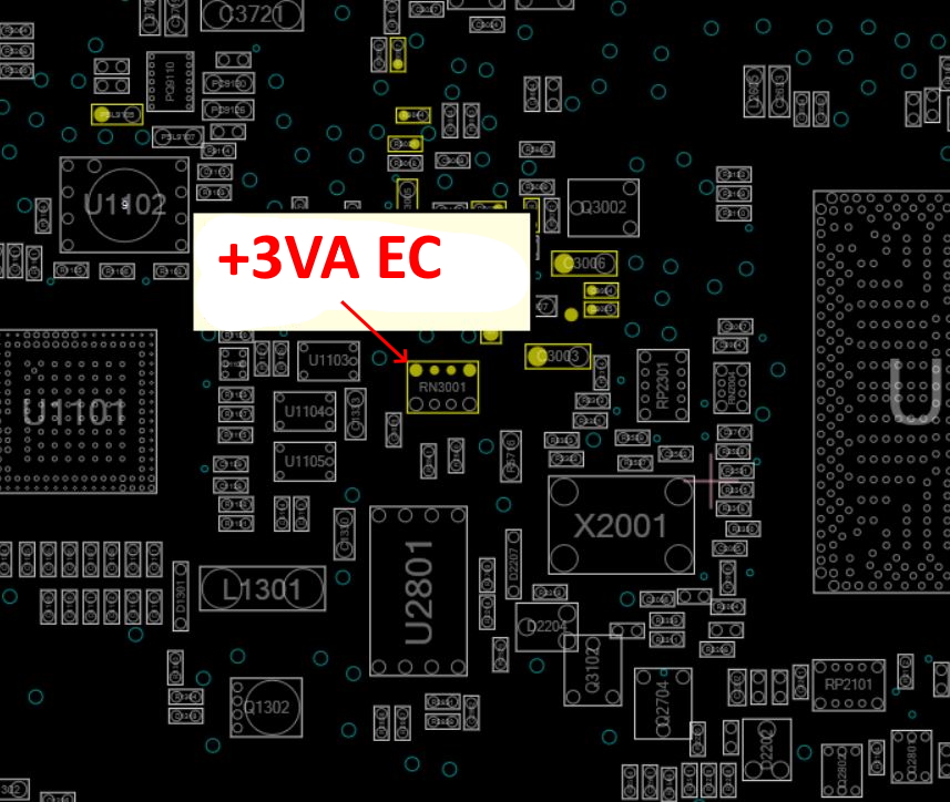

    I got a beautiful motherboard disassembled from an Asus G751JY. At the beginning it worked well so, I thought about using it as a desktop assembly.
    For this purpose I tried to connect a couple of 3 pin low power fans to the 4 pin fan connectors with some mosfets.
    It was working well until it stopped working. After some testing I figured out there was a short in a 3V regulator. I changed the mosfets and now it is gone, but the motherboard still does not work.
    I have been testing more voltages and noticed all the regulators are off. Then I checked the SIO power (ITE chip?) and is off too, but I cannot find the main regulator in the boardview. You can find it attached.
    I do not think the fans caused the issue but I prefer to tell you just in case they did.
    Any help is appreciated,
    thanks.

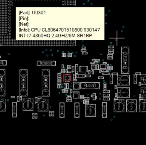

      I have checked both chips and found the following:
      -There is no 3VA EC.
      -The charger chip may be faulty, as the regulator is giving 2.5V at the mosfets to the right side (PQ8804 and PQ8805).
      -As the charger chip gives 2.5V, the gate voltage of the main battery mosfet (PQ8803) is the same, while the source voltage is 2.5V too. The drain voltage is 19.5V.
      Looks like the mosfet is not triggering because the Vgs=0V, but I am not sure about the cause. I suppose the charger chip should give something close to 24.5V so Vgs=5V and the mosfet works, but I am not sure about the problem.
      Thanks for the reply.

          sorry, it is my fault. What I was measuring in the previous post was the battery output, which, of course, should be off as there is no battery connected. Then, I can suppose the charge chip is ok.
          I discovered the problem comes from a 3.3V regulator, more specifically the output of PU8100. There is something shorted in the +3VS net.
          I have tried injecting 1V 2A to it and there is something hot around the U3301 chip (ethernet controller?), but the chip itself is not shorted. The heat may come from the other side too.
          Can it be a shorted capacitor?
          Thanks.
