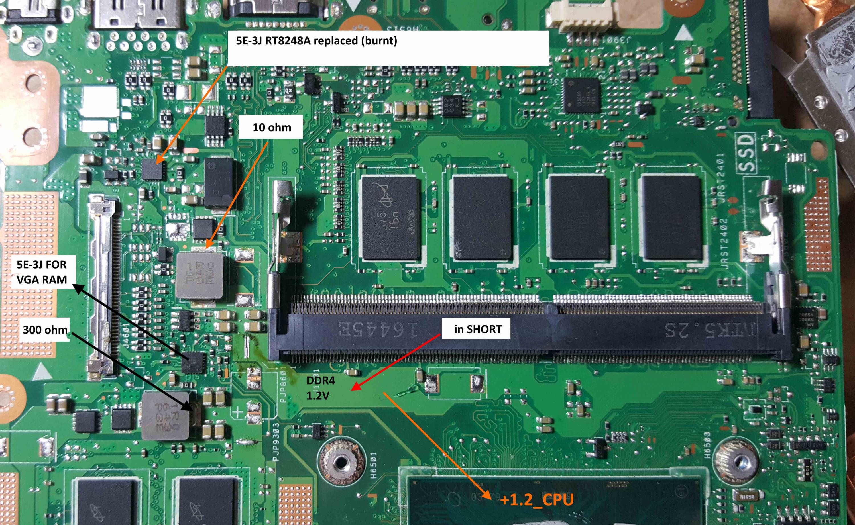

    Asus UX310UV no boardview,
    I replaced 5E-3J RT8248A (visible burnt) but a short remains on the 1.2V DDR4 line.
    This tension also affects some CPU pins.
    I wanted to try to inject a voltage of 1 Volt on the 1.2V line but what amperage? 1 Amper?

    Re: Asus ux310uv ddr4 in short
    No need to limit the current. It'll no draw a lot of current if it's a 10 ohms short with 1V anyway.
      I forgot to mention that I separated the DDR4 1.2V from RT8248A coil, now I have 10 Ohm on coil and a short on the rest.
      The dubt on amperage regard the line in short

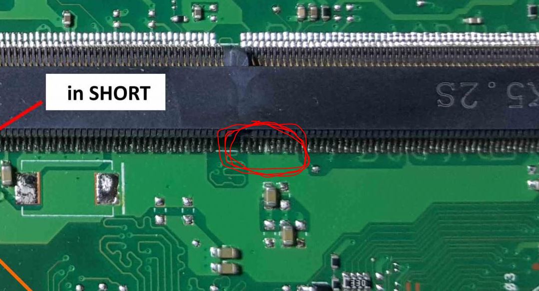

        • 21901
        Is there some corrosion on the memory socket pins
        • jasko_jacker
          • Oct 2014
          • 1140
          • italy
          It is an effect of the photo, no damage from liquid.
          The short is on a ddr4 module, I removed all modules and the short disappeared.

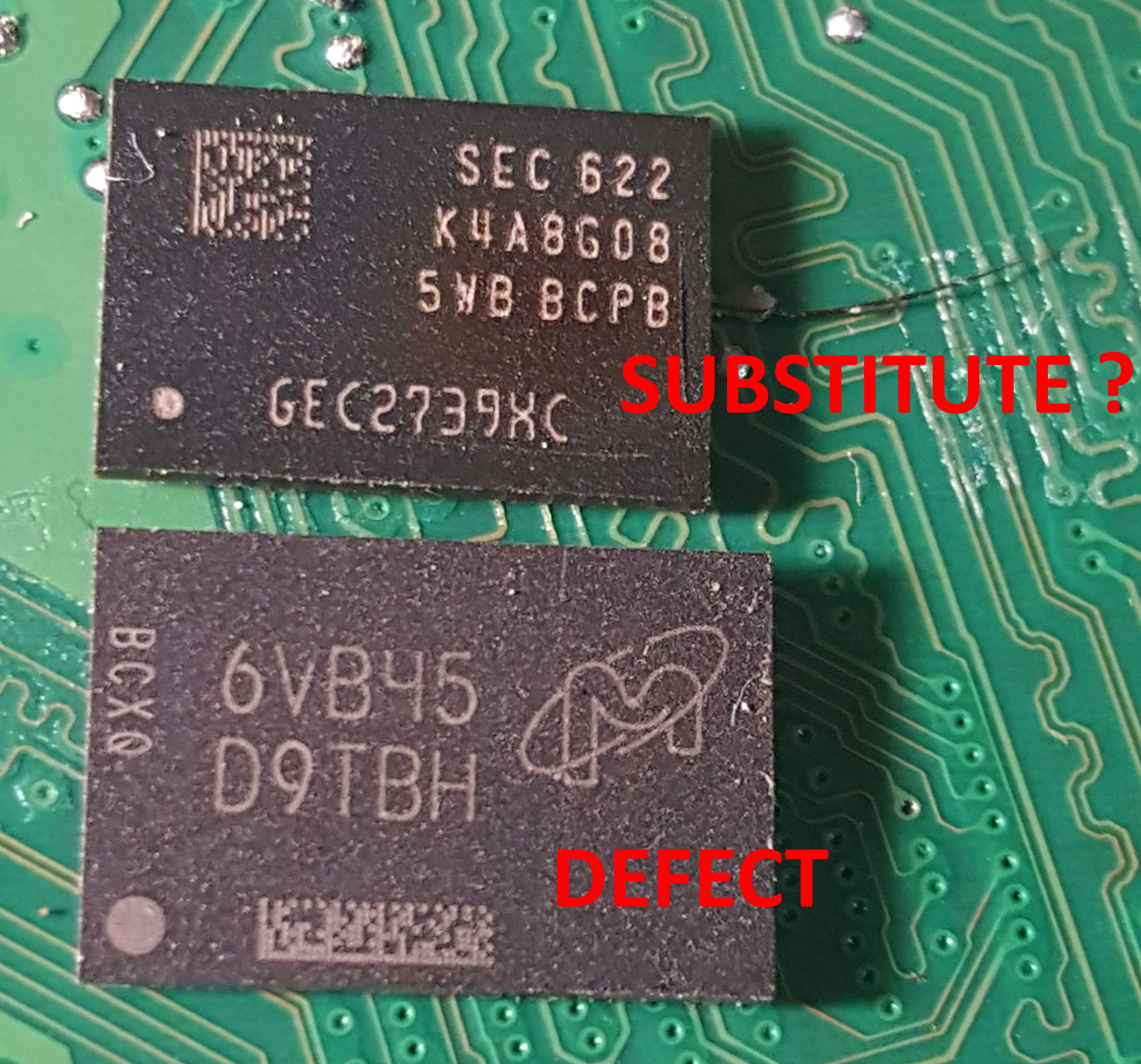

          Now the problem is to find a correct ddr4 replacement, I have a similar asus
          mobo (X541UV) that use samsung K4A8G085WB
          https://cdn.badcaps-static.com/pdfs/...67f2e156f6.pdf
          but I don't find exact spec of the ddr4 D9TBH micron , on google appears
          https://www.micron.com/products/dram...t40a1g8we-083e
          but the marking code is diverse or I have a difficult to find it.
          I know that the fastest way is to disable the ram onboard but the owner doesn't want to.
            • 21901
            If the samsung speed and timings match any of the supported memory in the bios it should work .

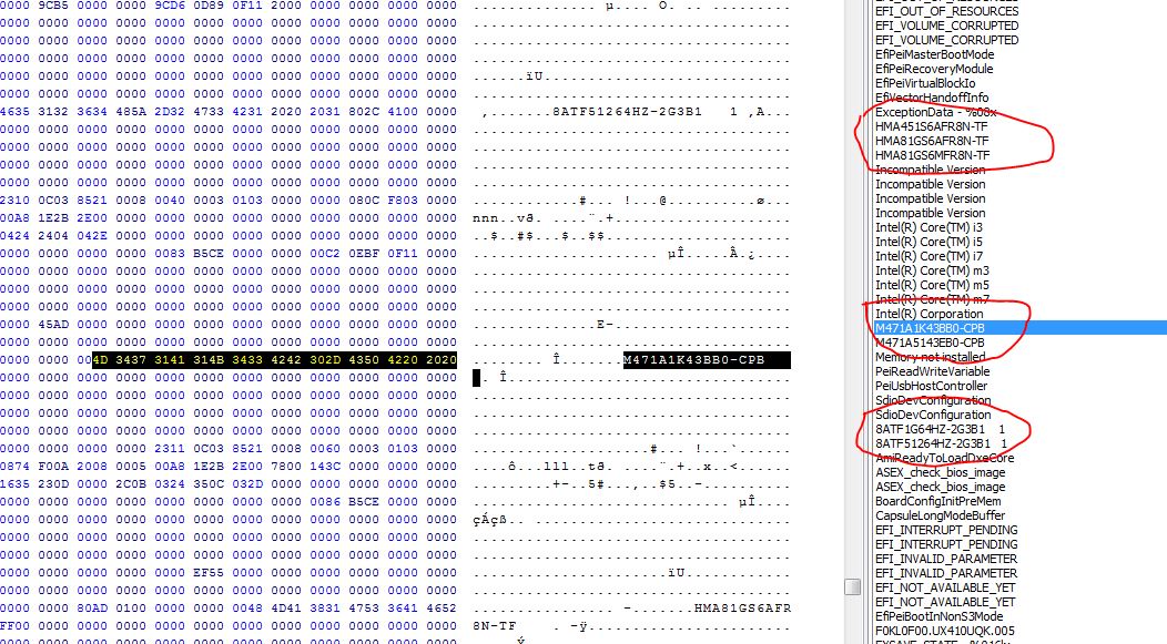

                  what application is used on this screenshot?
                  does it automatically detect each encrypted compartment code in bios .bin file?
                  thanx alot
                    • 21901
                    thanx alot
                    The app is FileAlyzer by safer networkng (spybot).
                    Don`t know what you mean by encrypted.Use the hex tab in FileAlyzer and scan for strings .
