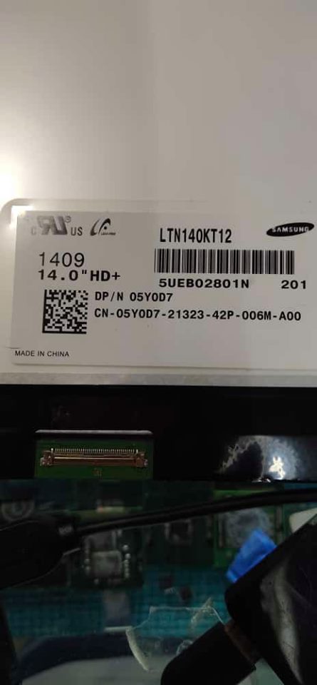

    I have Costumer. Owner of this Lenovo Thinkpad T460S. She has a carry of this Laptop. Problem is Screen Broken. and she is co'z punch the Screen Panel
    Hard to Find on store Here in Philippines.
    ----------------end ---------

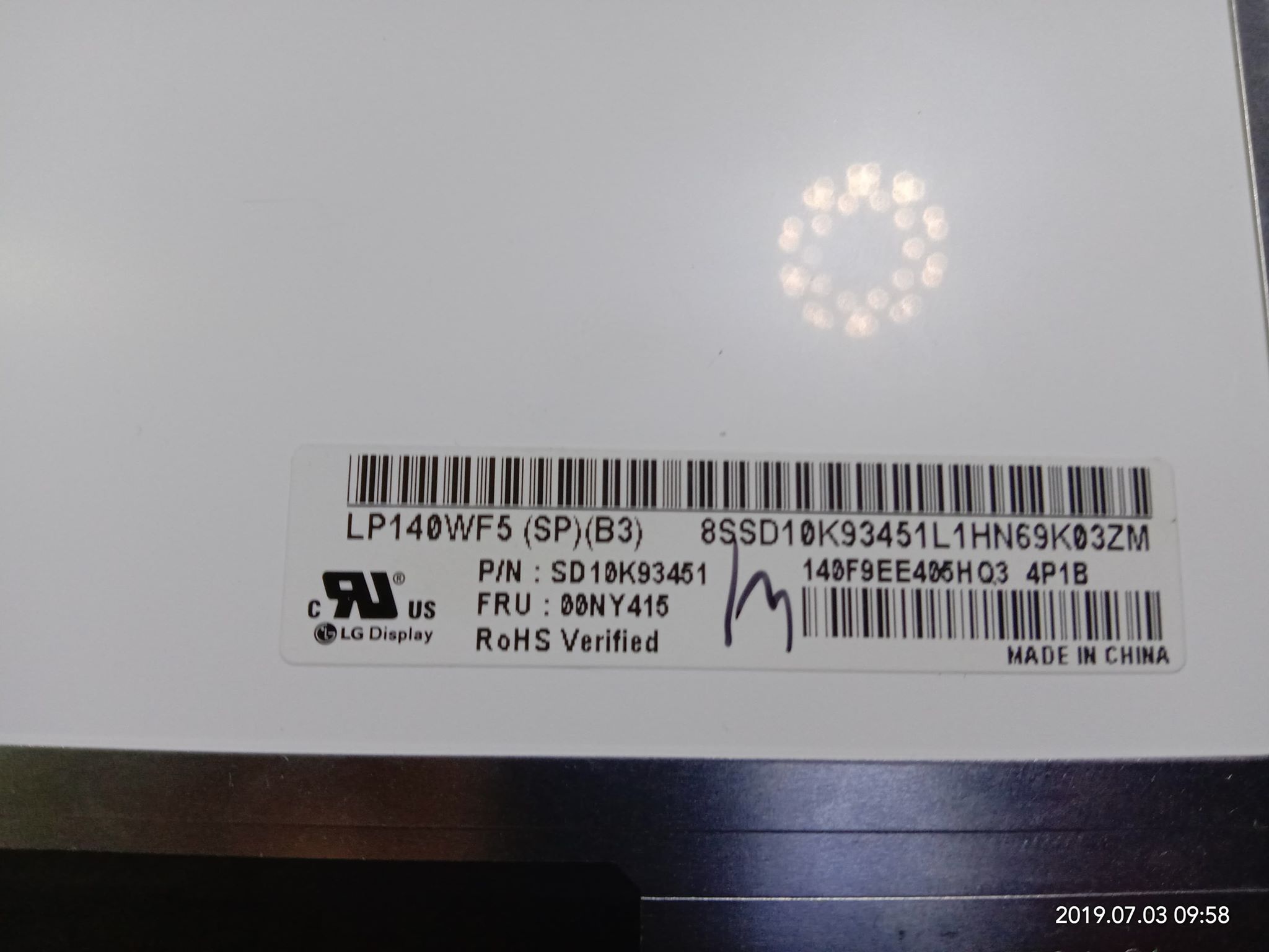

    the screen Specification is 14.0" 40pin 1920*1080 FRU IPS LCD FRU 00NY415
    although it is a Touch type. model LP140WF5(SP) (B ).
    Image Sample:
    Actual Image
    I would like to change the screen panel of this type
    LTN140KT12-201
    Size: 14.0" WideScreen info
    Resolution: HD+ (1600x900) info
    Surface Type: Matte info

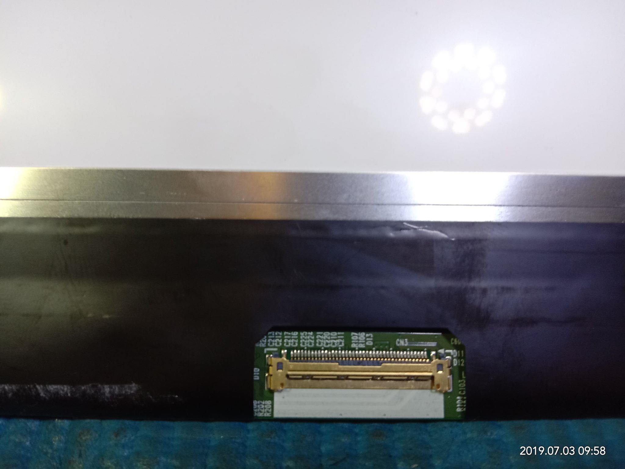

    Video Connector: 40 pin screen socket info
    Non- Touch.
    my question is whether it is compatible or does not it have a problem with mobo or laptop?

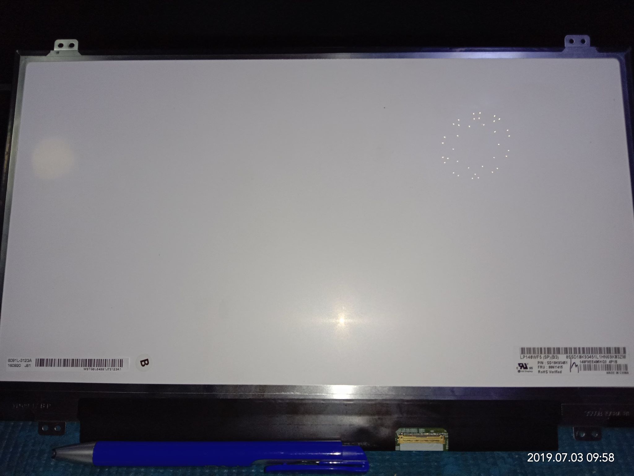

    Some lcd screens don't work as usual even if you buy them new, they need to be programmed. for this task the crack screen is a vital source as you will need to extract the .bin from the cracked screen and move it to the new one. it happened to me, and thats how I got it to work.
