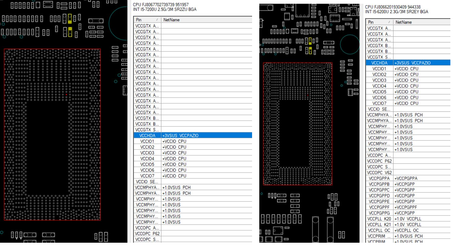

    has someone tried to replace a 6th generation CPU with a 7th ?
    thanks

    I think wont work though never did this adventure.

      With 2th and 3th generation on an ibm e430 the change works, but only
      as downgrade and not upgrade cause the pch model.
      But in 6th and 7th generation the pch is stored in the same chip of cpu....
      I read that some desktop motherboard accept both 6th and 7th generation cpu previous bios update. I want to try this switch on an asus zenbook ux510uw

        are the 6th and 7th generation CPUs, pin-compatible?

          I didn't check all the pins but for my search I think there is a pin compatibility.
