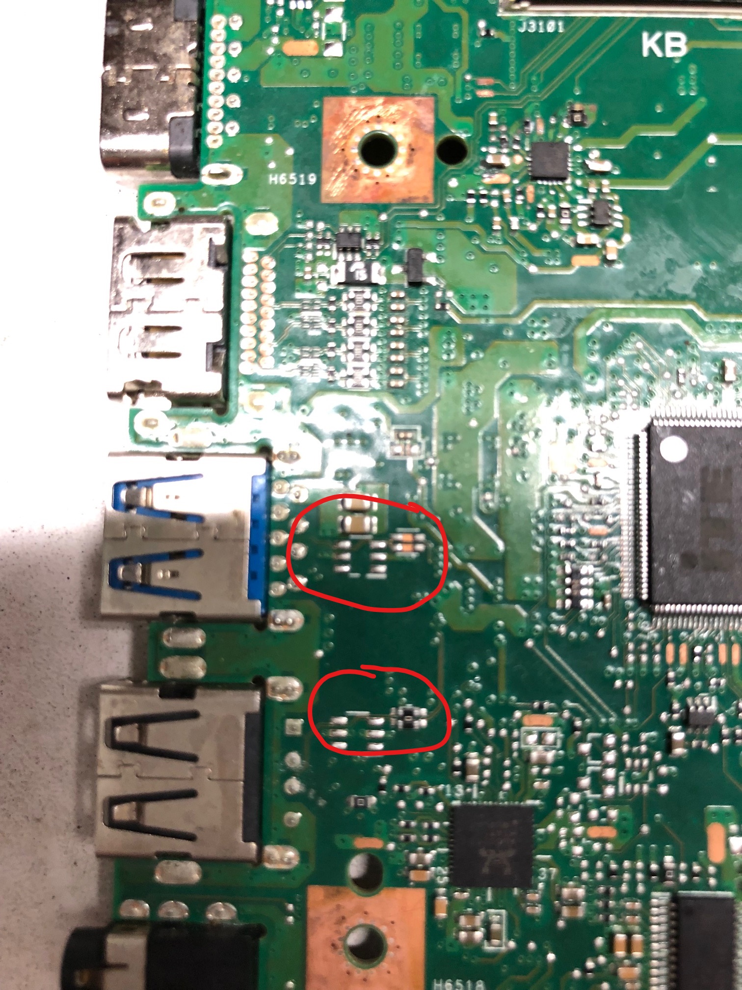

    I have this Asus X541UA mobo in which both the USB2 and 3 ports don't work (aren't recognized in BIOS or in Win10). The 5V is there, but one of the data lines reads low (.2V in diode mode, where the others are .6V) for both connectors. According to the BV, these traces go to what I believe is an ESD chip, but it is not present, and the traces are hardwired, then go direct to the CPU. I don't have a scope to look for activity on the data lines.
    I guess since this is direct to CPU, there really isn't much I can do. Does that seem right? Other than that, it works great, and the USB C still works fine.

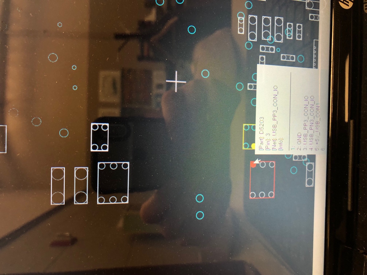

      "According to the BV, these traces go to what I believe is an ESD chip, but it is not present, and the traces are hardwired, then go direct to the CPU."
      Which ESD chip is that on the boardview D5201,L5233/SLN5213

        Not sure if you are asking me for the actual chip ID #s or if you are just wondering if I'm talking about the chip reference.
        Yes, I'm referring to the D5201 and D5203, which are both not populated (on this board, but are on another board I have (@work now so will get later)). Pins run from USB connector to pins 3 and 4 of this chip, then via SLN5213(or L5233) which is a zero ohm 4 lead resistor pack. It seems to be both of the "P" signals that measure low.
        I've given it to my son for now, and he can use the USB C, but I was just curious if I was missing something simple as it's the first I've looked into a USB issue. I have a few of these boards, and they all seem to have various states of those components populated or not. I don't know the history of any of the boards

          Here is a pic of the mobo with the area circled in red for both USB2 and 3. USB3 doesn't even have the 0ohm resistor pack, but has a hard trace between pads

                Just a little update: I decided to try a USB 3.0 stick in the USB3 port, and it worked. Seems that just the USB2 devices aren't recognized, and have to do with that one D+ line that appears to be lower resistance than normal.
                So long story short, the one USB3 port is still usable, but only with a USB3 device
