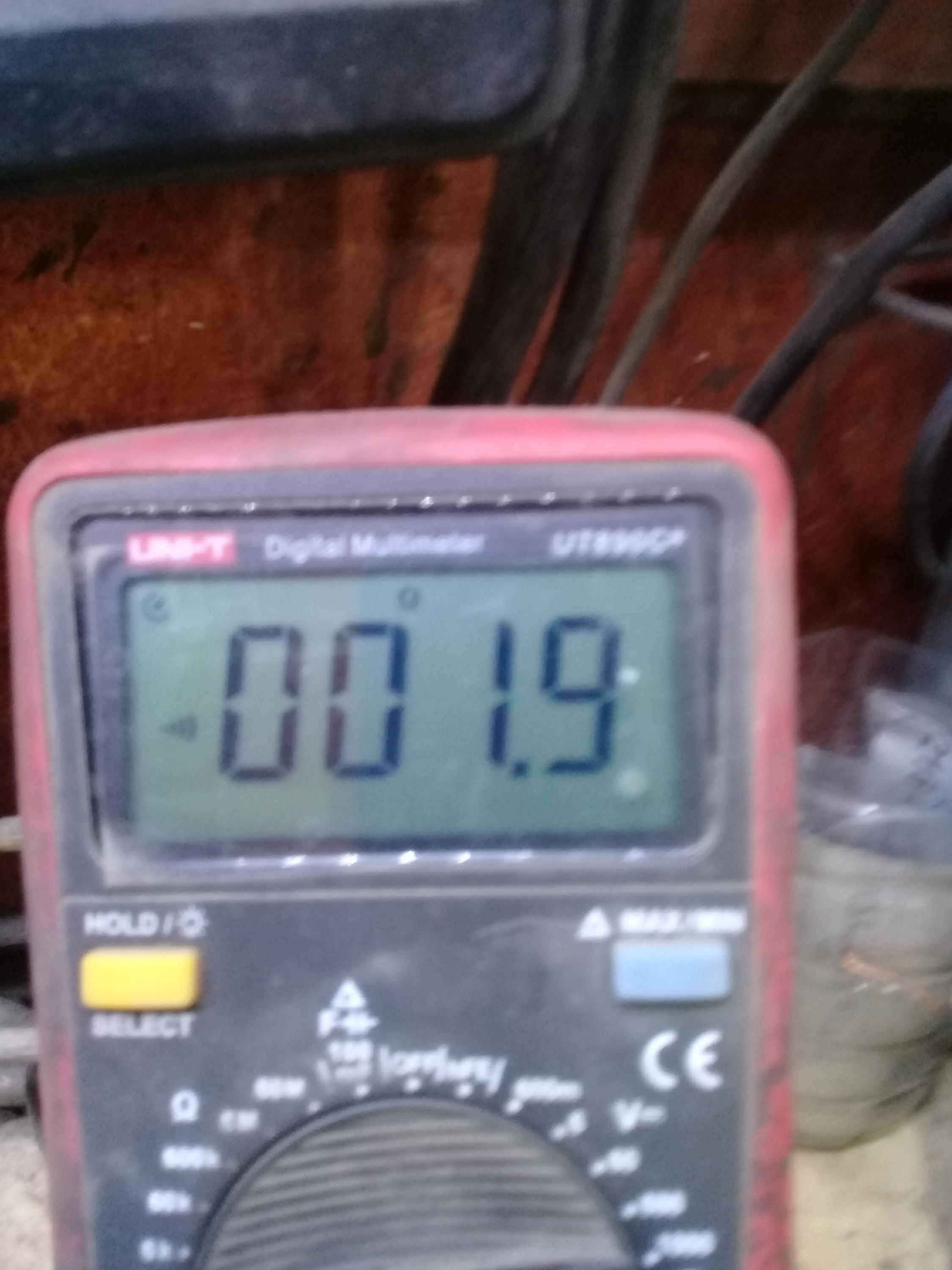

              Re: DELL 5521 7 beeps
              i have working mb ..all voltage are same
              pl600 0.77v
              pl701 0.9v
              pl700 00v
              pl700 1.9 ohm
              pl300 1.52v
              pl500 1.05v
              pl400 1.8v
              pl800 1.00v

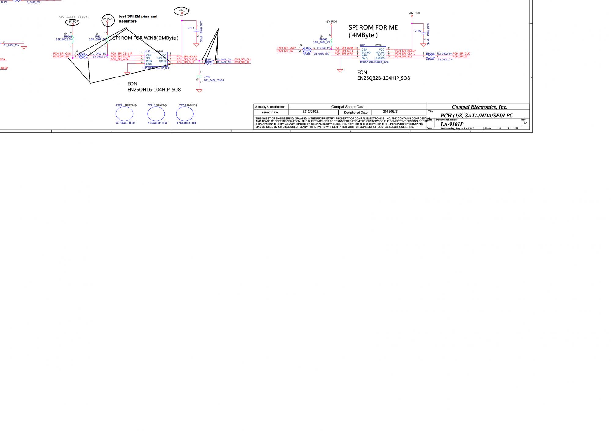

                    for the DATA test SPI ROM UH2
                        UH2 pins 1,2,3,5,6,7,8 ...3,3v OK after power on
                        thanks
