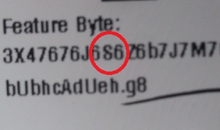

    have this HP Probook 440 G3 that start with no video with two long beeps and two short beeps. That links to BIOS error, but i try all bioses on this site and no one works. have anybody some other bios?
    board code is DA0X61MB6G0 rev G

    you have a clean me from SMDFlea to the bios section ... did you try it?

      y try clean ME from SMDflea and it work ok, but i have another problem.
      Dont have sys info so launch nbdmifit but i cannot find "system board ct number"
      any body know whe i can find it? on board
      i have no sticker under ram slot

          i found some original CT from picture on aliexpress, but now my Original Feature Byte giving me CRC error

                      with filealyzer i found the right board CT, but feature bytes still gives me CRC error.
                      can u please wrote me how to copy it?

                        If the feature byte was ok before you entered the wrong CT number flash the bios back again,you can leave the CT number blank ,or you can backup the bios as it is now and copy the old ct number and feature byte from your original bios backup into it.
                        EDIT: Did you clean the ME area of your original bios, sometimes its the only thing that gets corrupt.Its easier to try and clean the ME first as it will keep all the DMI info and everything else intact .

                          DAMN what a HP fail. looks thi like "S" to u?
                          But still want to know how to copy it

                            I don`t know if thats an S or an 8 ? ,an S i think. I edited my previous message,have you read it

                              Re: HP Probook 440 G3 - two long beeps and two shprt beeps
                              no i use your ME clean bios that u posted.
                              after write that S, all works

                                Ah,it was an S ,glad you got it working. Did you blank the CT number or use that one from ali .

                                  find it in original bios with filealyzer by arrange strings by alphabetic. that i find that "S" in FeatureByte string
